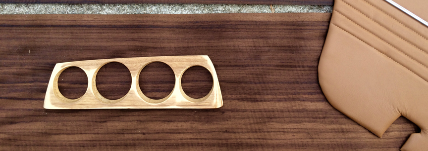

Nice work, and great looking veneer! I think that you will find the concave pieces to the left and right of the gauge cluster more difficult than the cluster itself...Clamping is a little more difficult since you need a caul (opposite curve to piece being veneered), or a sand bag method, to equalize the clamping pressure...or you might buy a Food Saver (you can borrow one for that matter) and vacuum bag the veneer on...I've done a few sets and it works great (pretty good with salmon as well...). Drop me a PM if you'd like to discuss. And I agree with Steve on the urethane...I experimented with tung oil on some samples (albeit walnut), and after ten hand rubbed coats, I gave up on getting the finish build desired.
