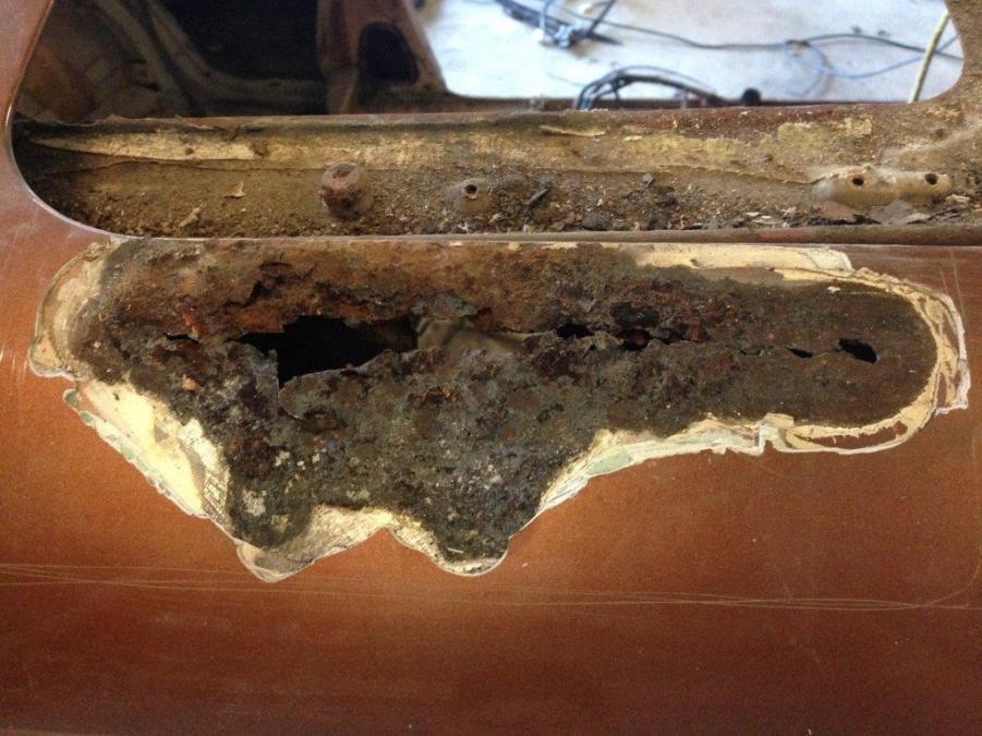

Thanks, since my last post I have removed the fenders on both cars and discovered the white one has rust in the channels where the fenders sit. So back to the brown car! Only issue with is the sunroof is badly rusted. At this stage I feel like I am restoring two cars!!!I will post some pictures next week

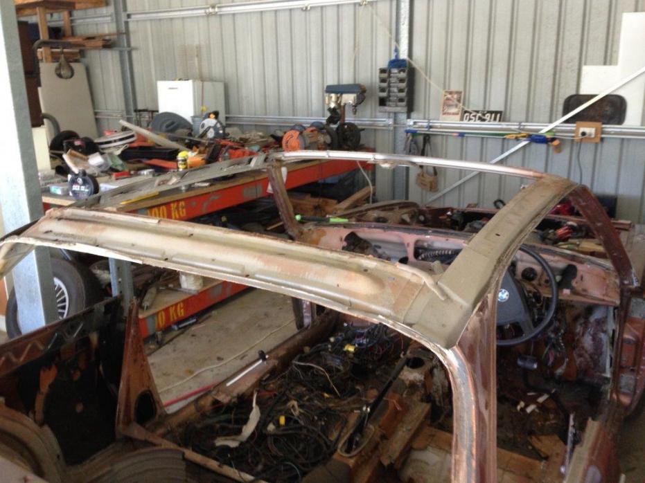

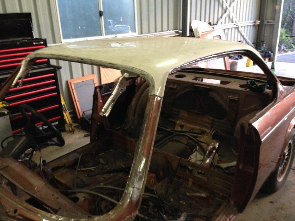

Skinned the roof off both cars. The sunroof was beyond repair so we are using the non sunroof to put onto the brown car. It's just sitting on the brown car and we will install it next week.

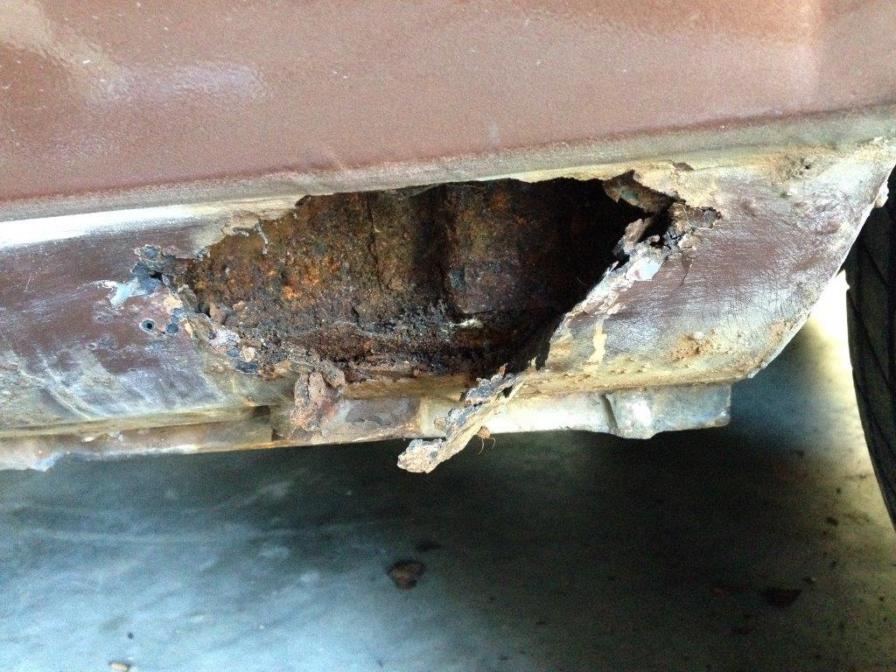

Rust in the sills etc so have placed my first order with W & N.

Dont want to tell you how to suck eggs.... but it might be a good idea to brace that thing through the door openings having the roof off, it may fold in half!
Yes, agreed, we have braced the roof in place with clamps etc however additional braces are a good suggestion.
