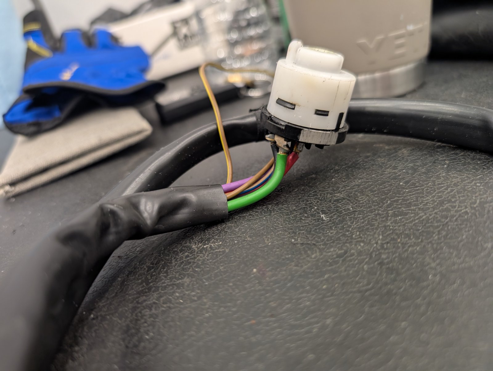

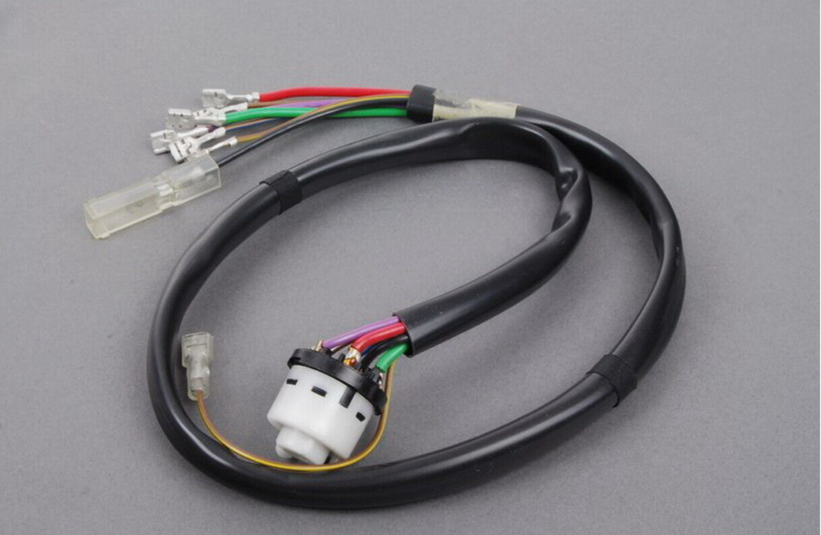

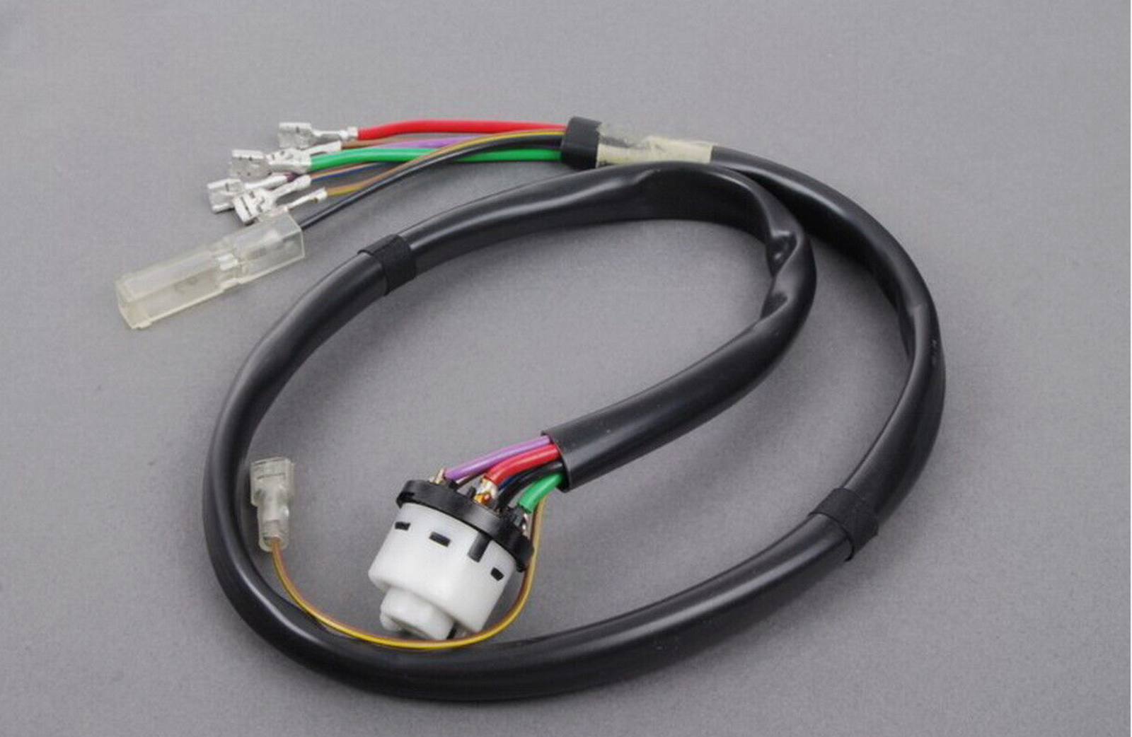

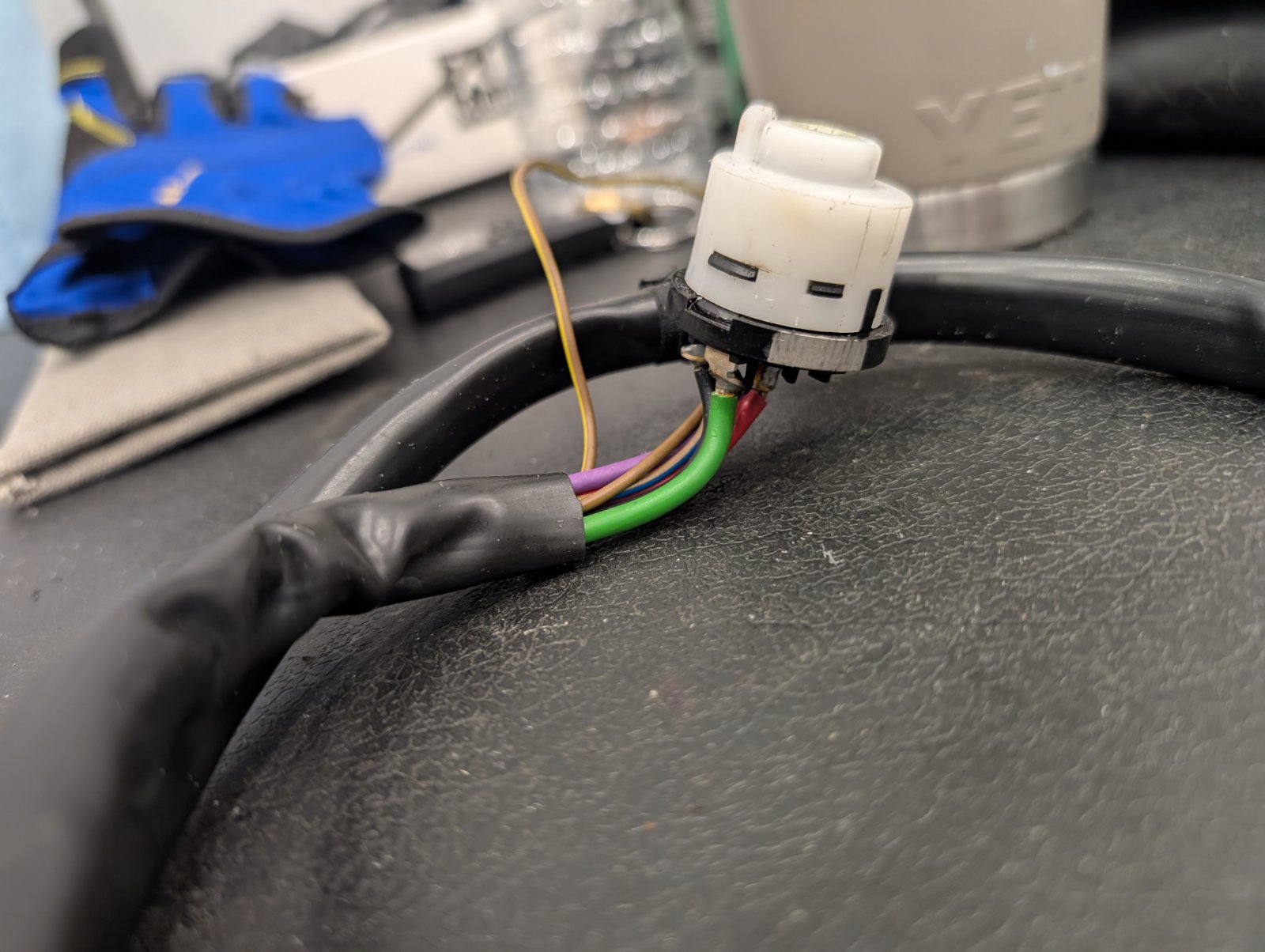

After 53 years, it is time to replace my ignition switch. After reading all the posts here, and researching part numbers, I found the go-to replacement switches have disappeared. The fix now is to install one from an E12, E24. SFDon suggested I call Carl, and I now have my new switch, part number 61321366107.

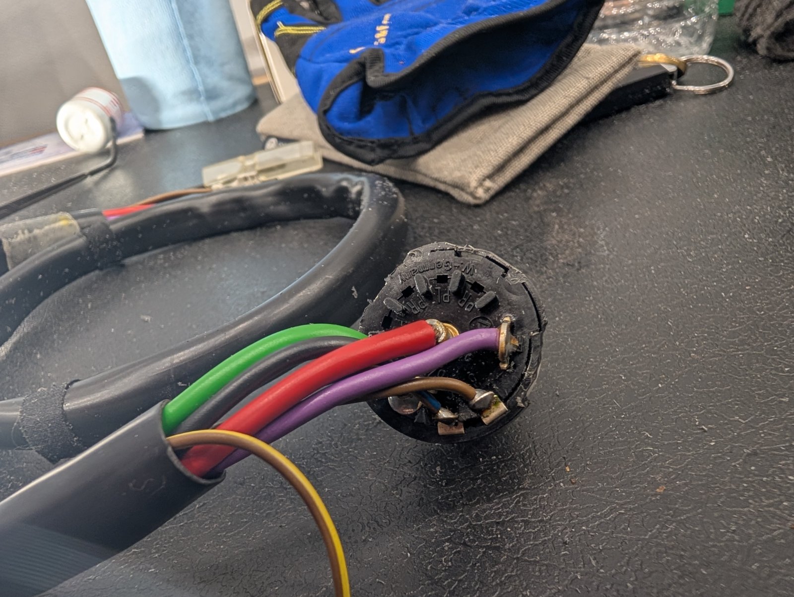

Extra wires on the new one. I see the common Red, Black, Violet and Green ones, but there is also thinner brown, brown/blue, and brown/yellow.
So, anyone used this switch and can tell me what to do with the brown, brown/blue and brown/yellow wires?

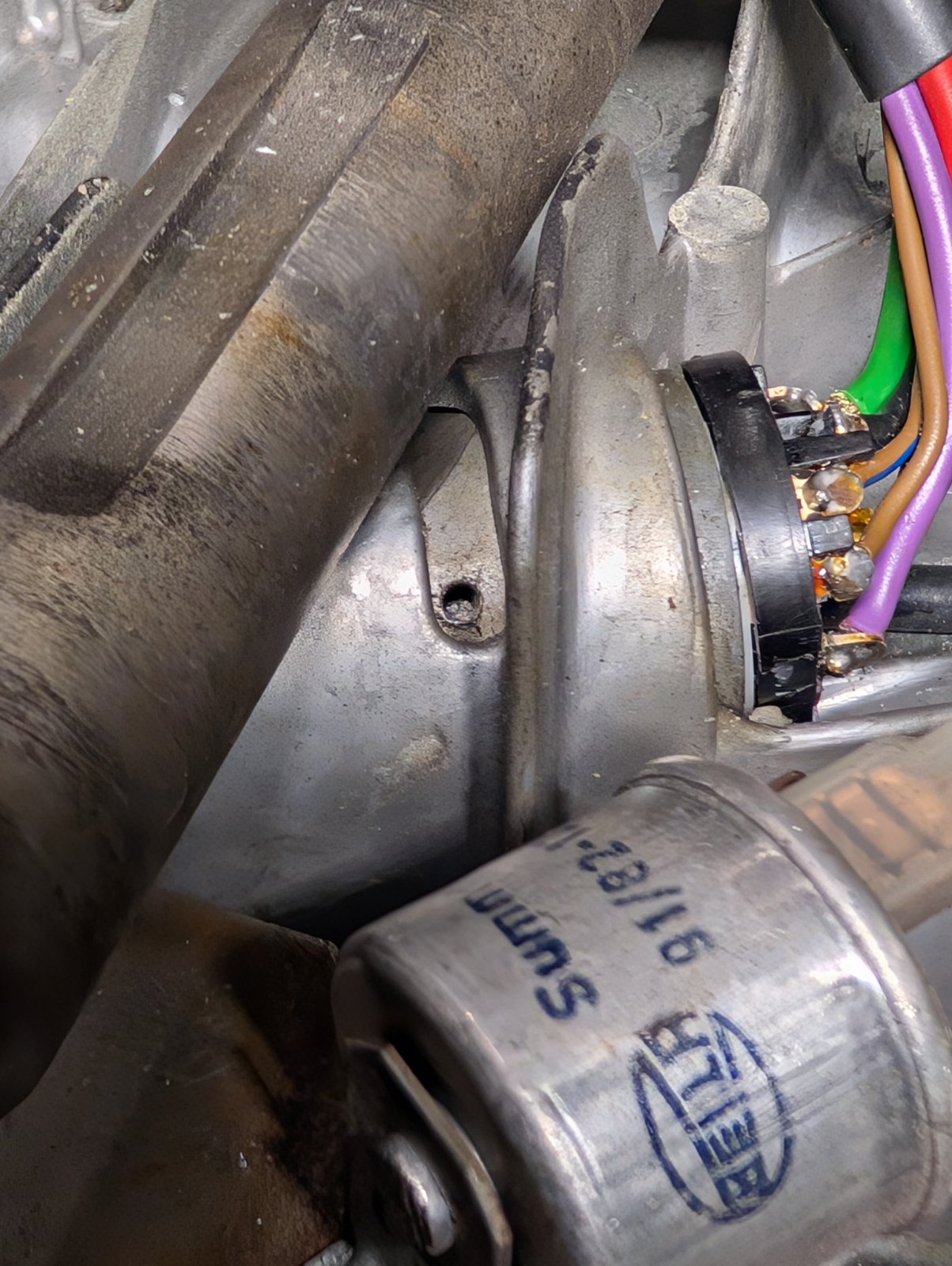

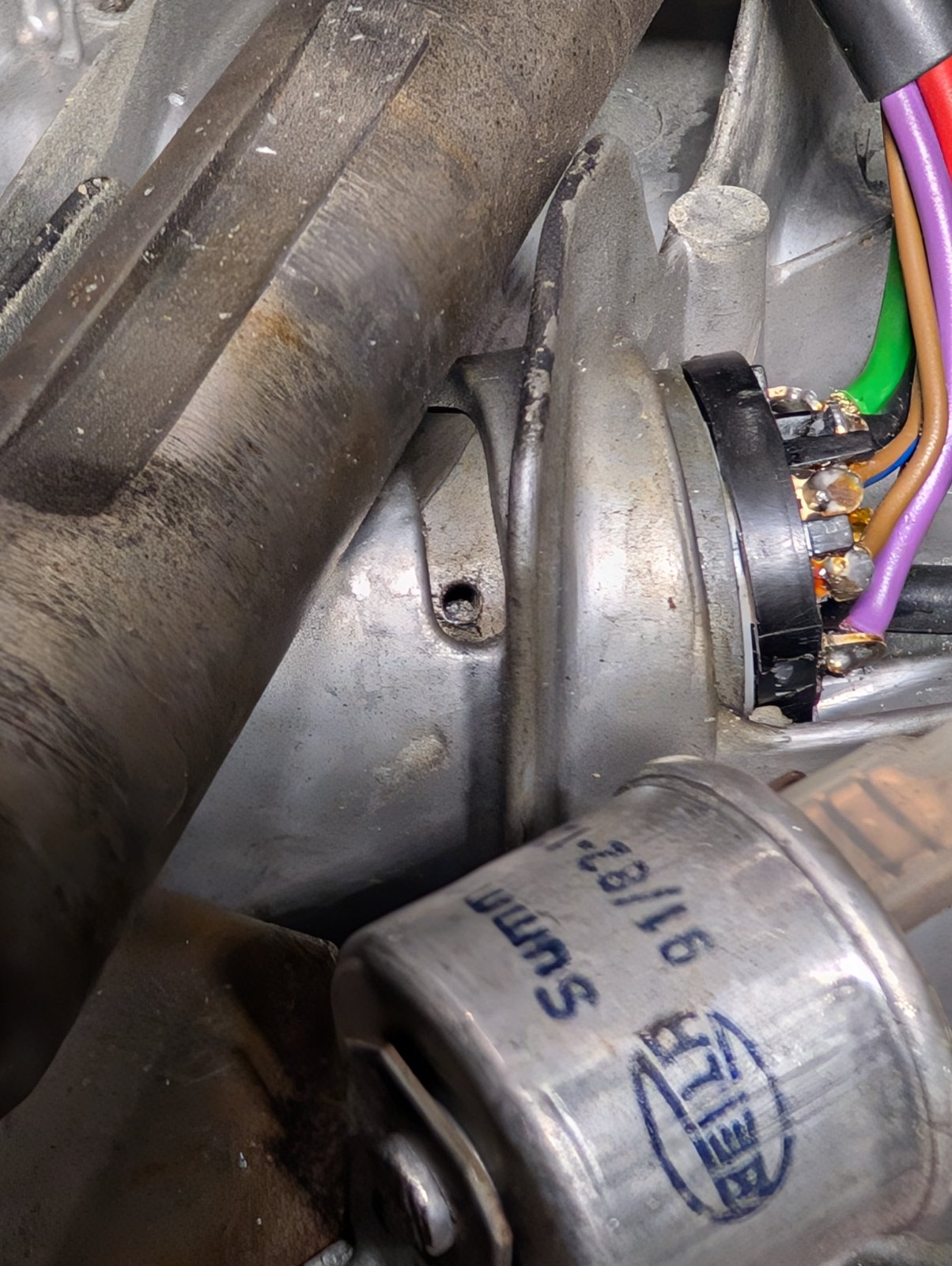

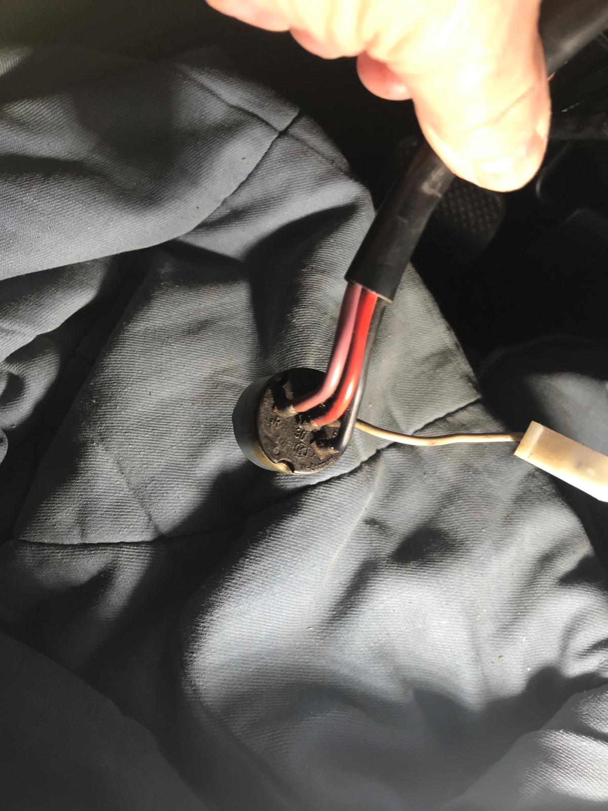

Also puzzling, my original switch has a short length of grey wire from a terminal on the back of my ignition switch. This plugs directly into a stalk on my steering column. New switch does not have this. Any ideas?

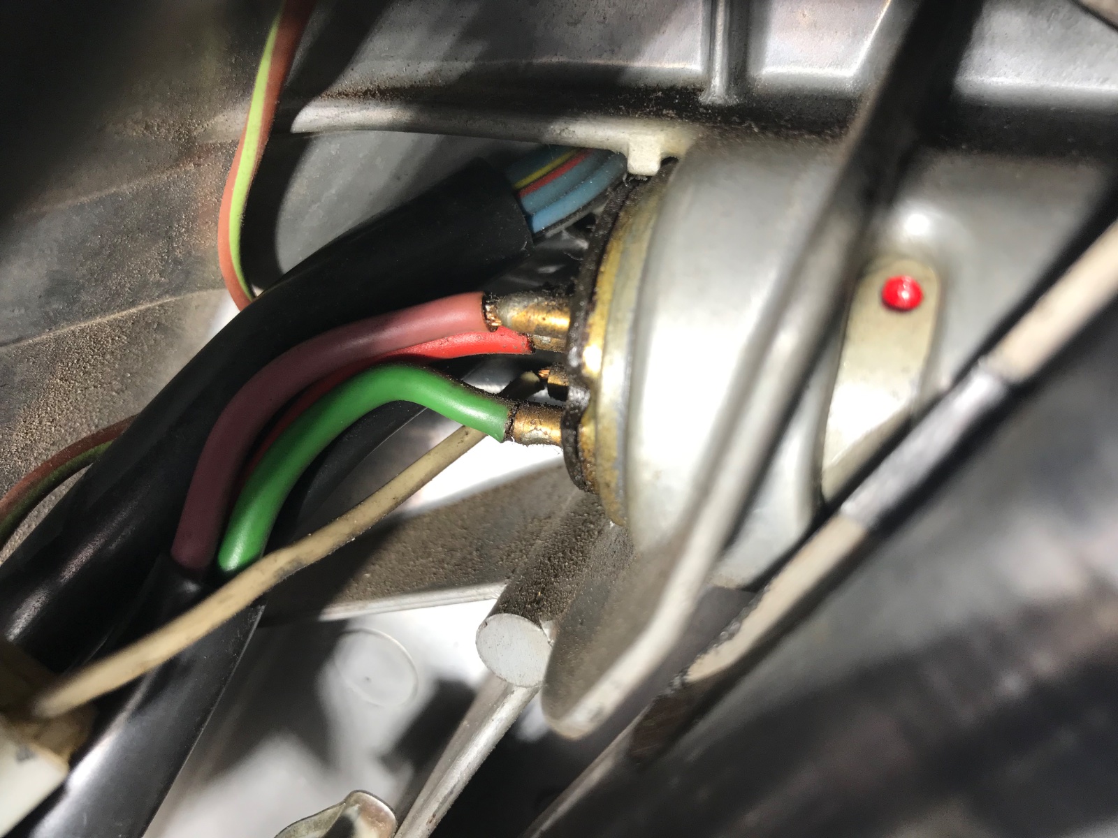

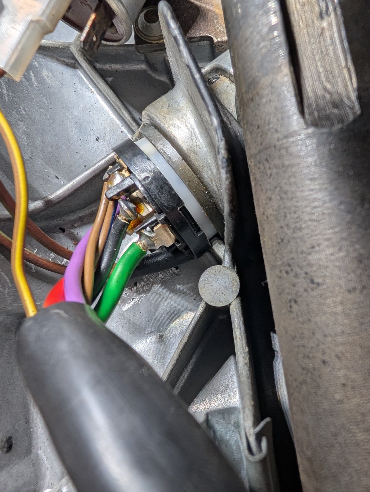

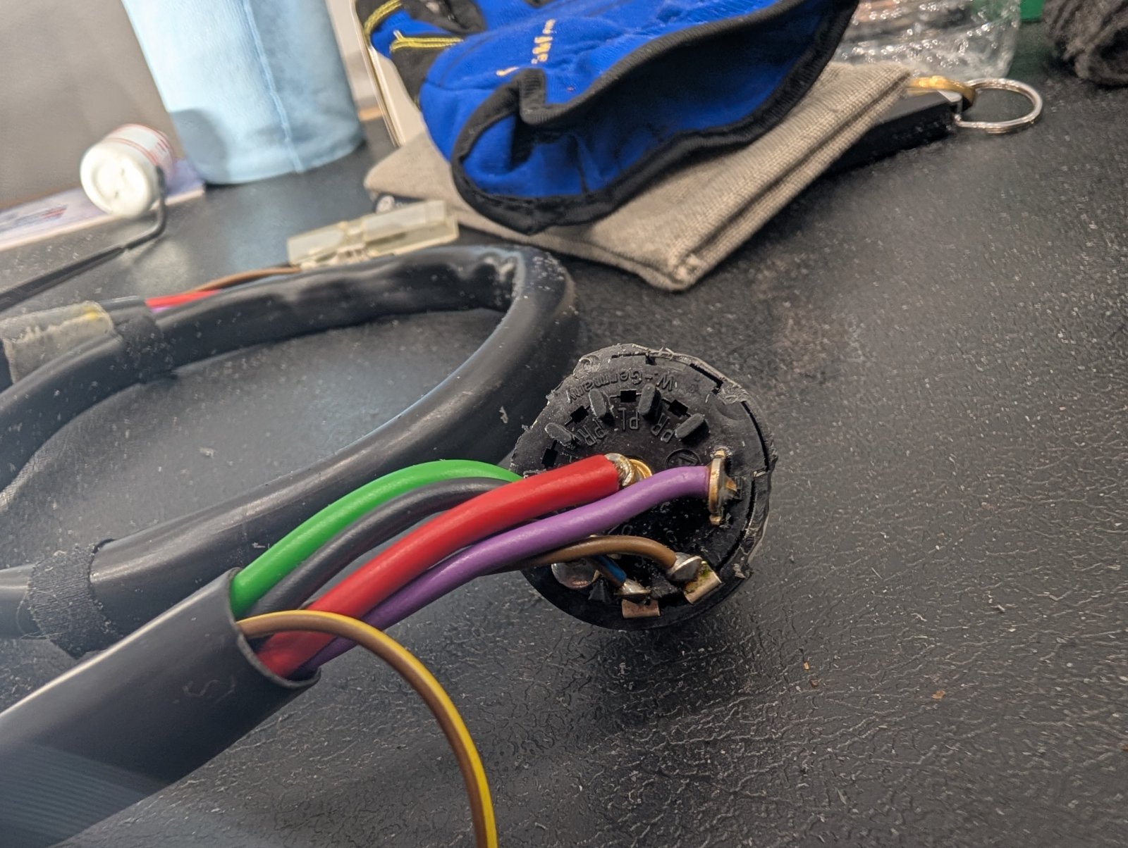

some photos: New 61321366107, my original, nice shot of never-been-messed-with and painted red, grub screw. Came out easy!

Hoarding, yes it's a thing! I did find this short grey wire plugs into a connector that is part of the loom that goes to the turn signal/wipe wash stalk. I can see the grey wire soldered to the back of this switch. I wonder if this is power to the switch or what? Somehow, the wipe/wash turn signal switch connects to ignition switch this way. Hmmm
i just traded emails with Carl - the 701 switches are gone. i think the switch in the pic is the 107 switch which Carl says has a couple of extra wires
Yes, you are correct, Scott. I entered the wrong p/n above. (edited now) I did in fact receive 61321366107 from Carl. I tried everywhere for ..701, but truly NLA. The ...107 is the next one up. It comes with a plastic case. The metal ones, as per original, now only available on eBay for $$$$. Yes, extra wires. So, perhaps they are just not needed?
Keep the yellow/brown wire- that is your horn wire
Cut off the other 2 small gauge wires at the switch

I was confused as well. it seems the only switch available now, has its locator peg at 90 degrees to grub screw mount. The switch that came out of my car has this peg at about 120 degrees. So, the peg has to be removed from the replacement switch to allow it to fully enter the barrel and get secured by the grub screw.

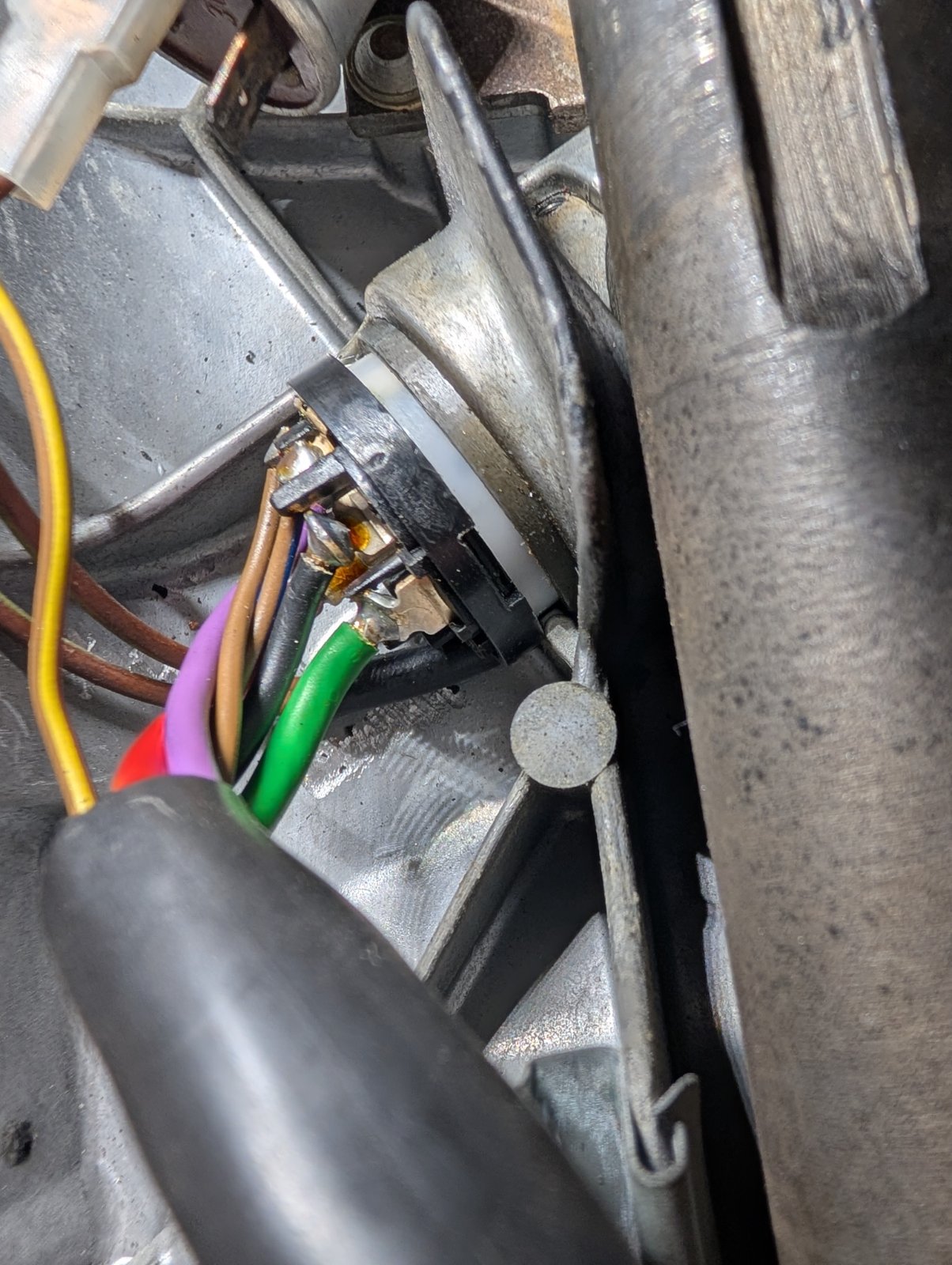

So today I fitted the new switch as per our discussion.
It's definitely not straightforward plug and play as we all had discussed.
First, in my case and who knows if this is just my 2800CS or an early late thing... Couldn't tell ya... The little nub for locating and I'm sure for rotational issues has to be ground off. It indeed is in the wrong position. That's easy
Next after a few test fits... I had to grind some of the black casing in order for it to fit around the metal structure of the column. I shaved a little here and there around the two places.
Having cleared those I found that it would "almost" go in. I had to relieve a bit more of the casing on the bottom in order for it to slide in all the way so that the grub screw could go in hole in the housing.
I did test the rotation. Turns just fine. Definitely more feel... Resistance than the original. I am a little concerned that it's just one little piece of plastic holding it from rotating but we shall see how it holds up.
You can see in one picture how it was not sitting down far enough in the barrel. The other are where I was relieving the black casing ... Careful not to grind off the tabs holding it together and then the final fit.

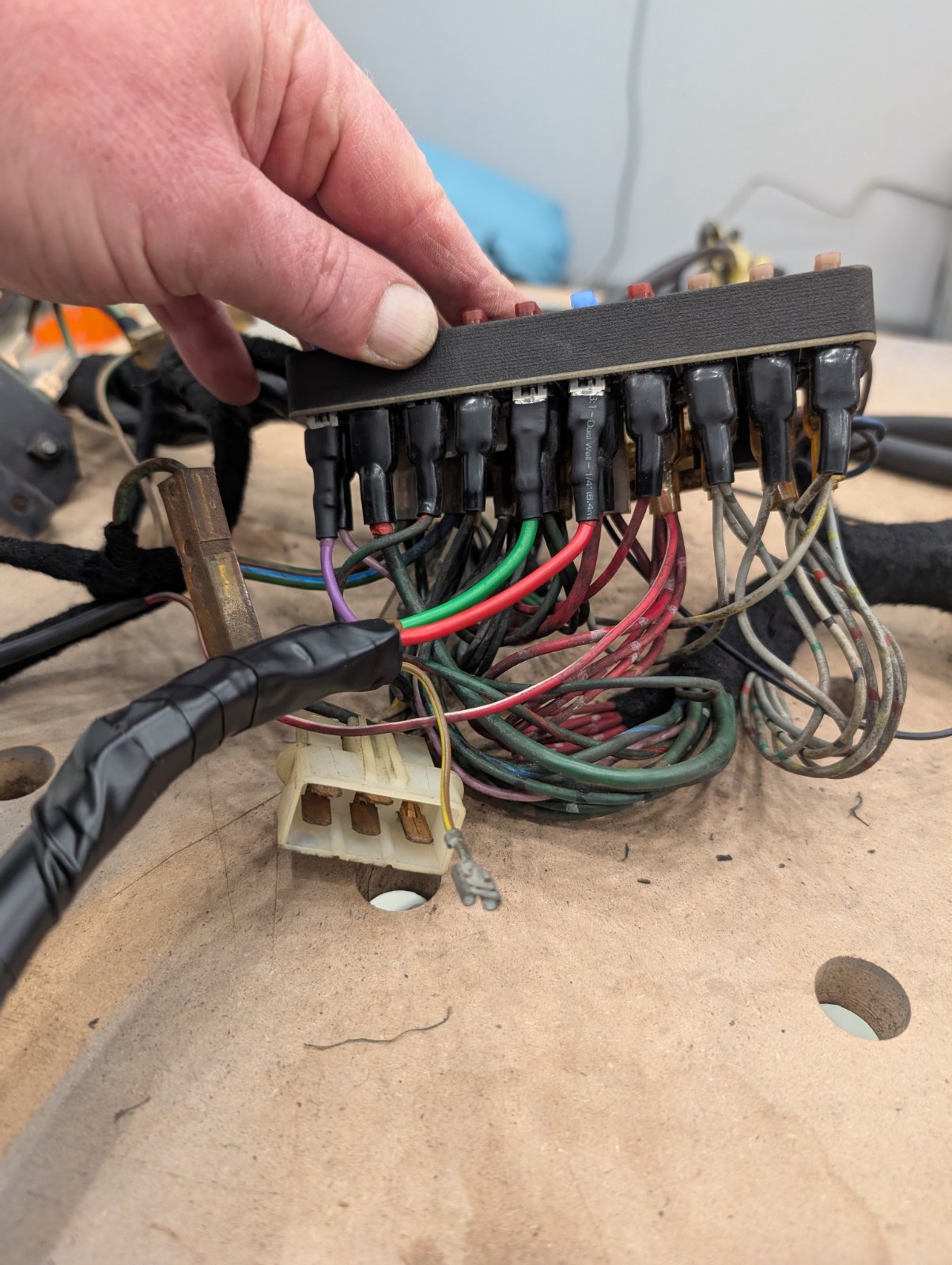

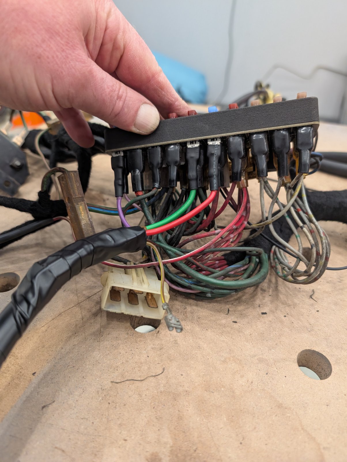

I was doing all of this.. well because it needed done but also because I have been working on my wiring harness for the last week. After test fitting... I plugged it in the fuse box... The final fitting of the switch and grub screw will have to wait until the car is being assembled.
Oh yah... They wire connectors come bare. I used some heat shrink tubing for covers... Don't like bare wires back there.
