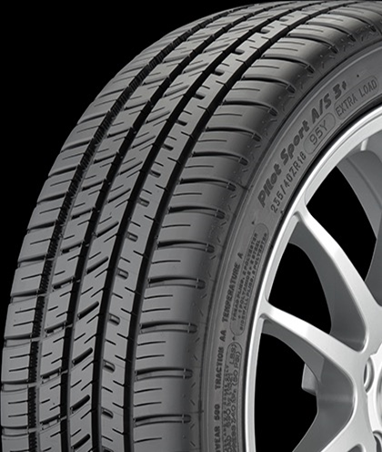

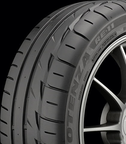

i did some research on tirerack ... see the attached pdf. the tire that OCCoupe recommended the Michelin Sport A/S 3+ showed quite well in the test data against the extreme + max performance tires. the tire that had the best overall data was the bridgestone re-11 as it took the most 1st places in the tests.

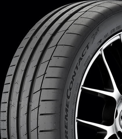

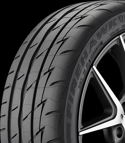

the michelin, which is an ultra-high performance all season tire finished with the 2nd best placing ... then the new continental extreme contact sport ... then the new firestone firehawk indy 500
bridgestone re-11
michelin sport a/s 3+
continental extreme sport contact
firestone - firehawk indy 500
Richard, i own the bridgestone re-11 tires on my coupeking alpina staggered wheels. they stick like glue. awesome tire ... perhaps better tire than i need on a coupe. the michelin's are almost as expensive ... but the firestone is inexpensive for what the test data shows ... and the conti is reasonable, and the test data shows much better than the previous conti extreme contact dw that several people have on this forum.
at an average of $88 each, i am likely to try the firehawk indy 500 tire. it tested out best in ultra high performance summer tires ... and i really don't plan on driving a coupe in the rain if i can help it. came in 2nd in dry cornering, dry lap time, dry stopping and wet steering. it suffered a little in wet stopping. the michelin was in the running in every category - a few seconds and a lot of thirds - impressive results. i just don't like the price of the michelins ... an average of 141.50 each

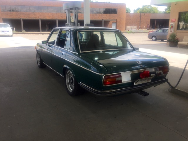

Richard, I'm impressed you can get a 225 onto the rear of an E3. Did you cut the inner fender lip?
It actually has 245's on it now... I'll post a pic. This is a Dinan build- it also has corrected geometry.
