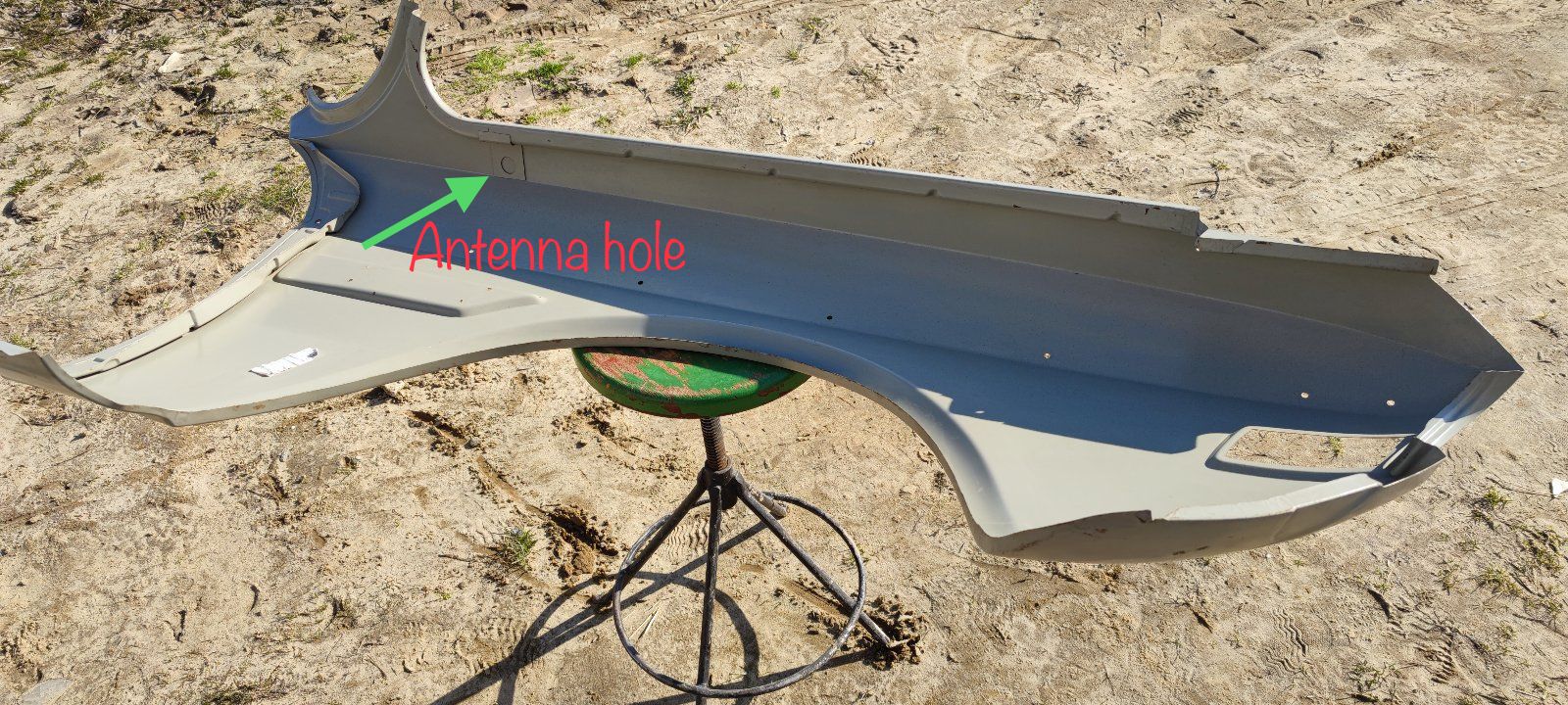

This might help --

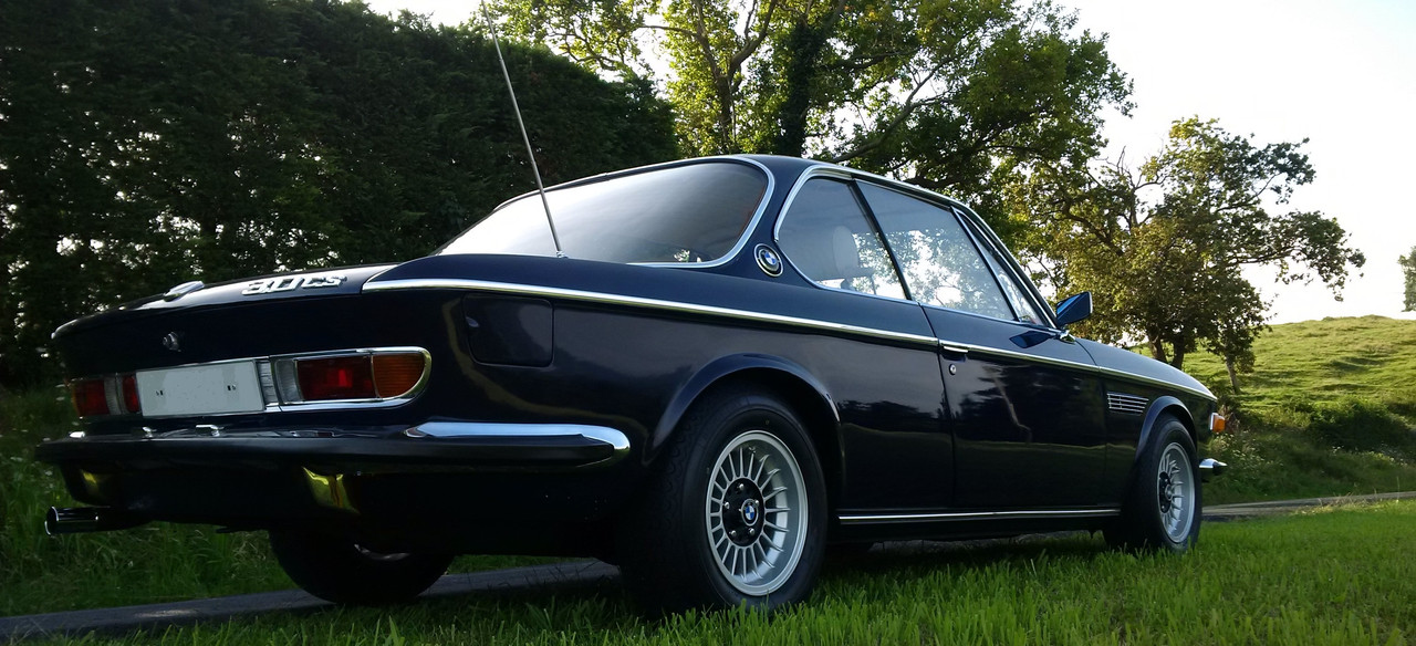

Bavaria....actually with a sideways mount on my driver a-pillar so parallels the pillar and not in my visual field.

I should mention that photo is for a 'Manual' antenna -- for the 'PWR' the rear would be obvious depending if you want in sight or not (driver vs. passenger side)
