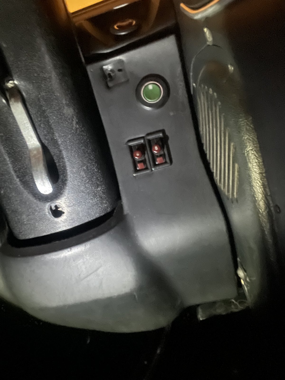

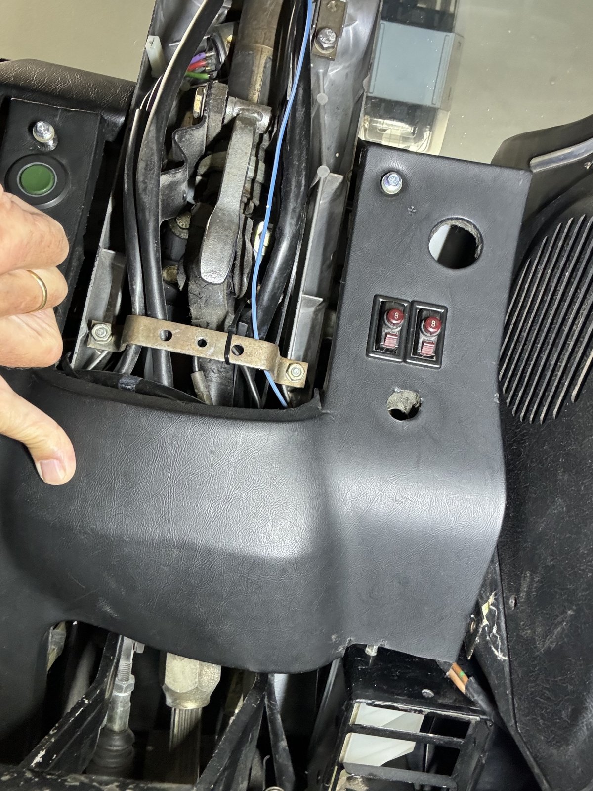

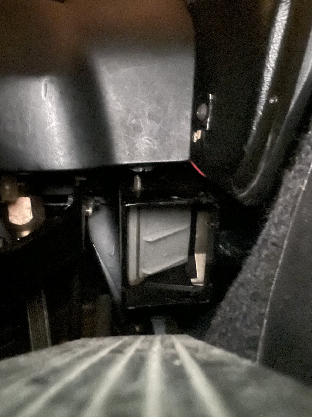

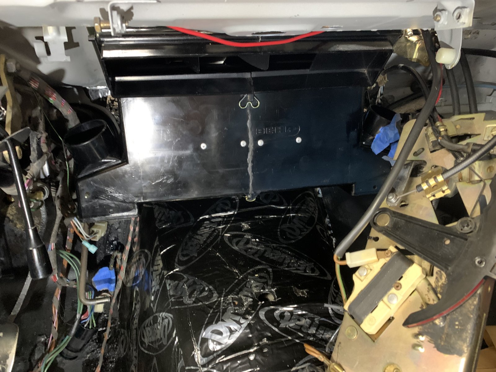

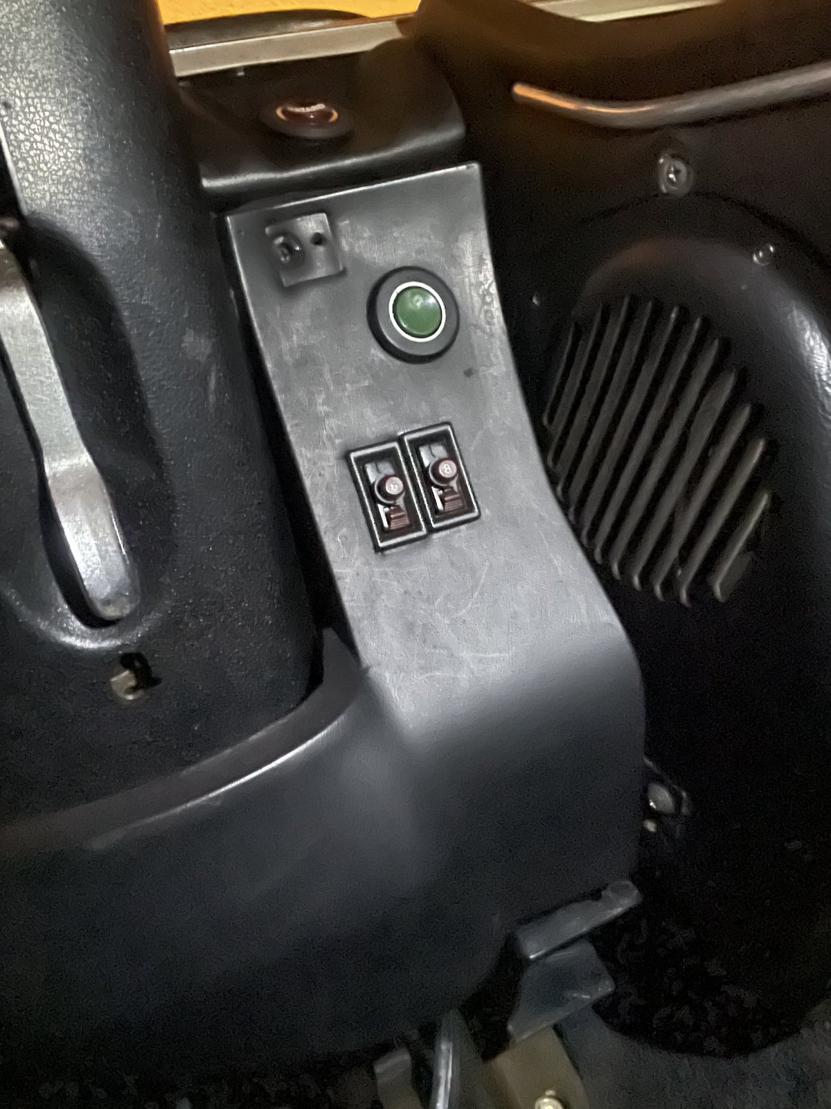

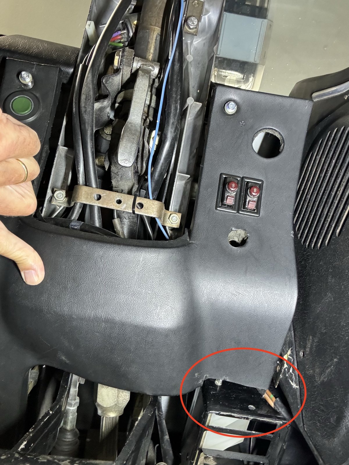

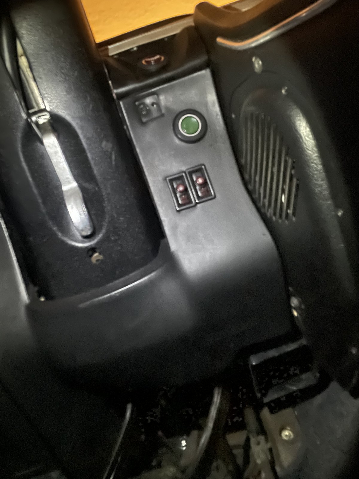

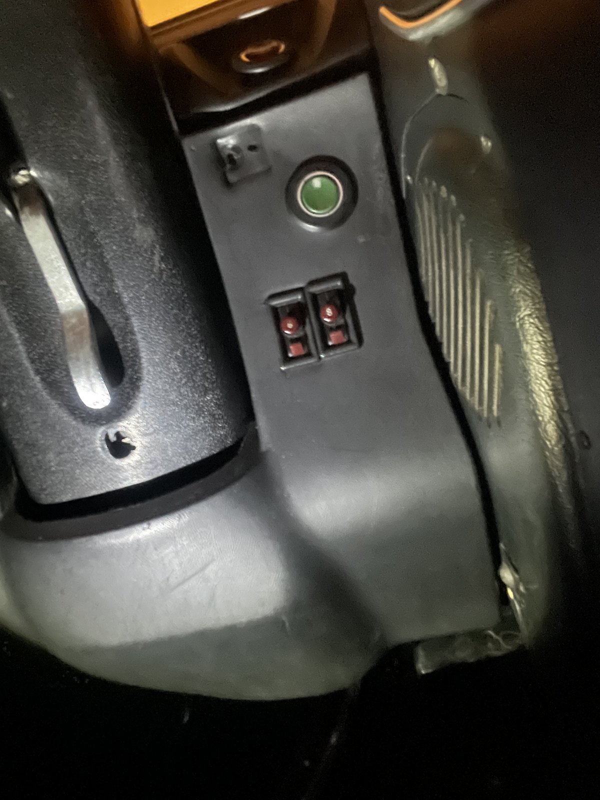

For some reason as I try to reinstall the panel under the steering column, the right side hits the square heater exhaust unit. The left 2 screws (one near the firewall and the other right above the green button on the pic) fit just fine. The problem is just on the right side.

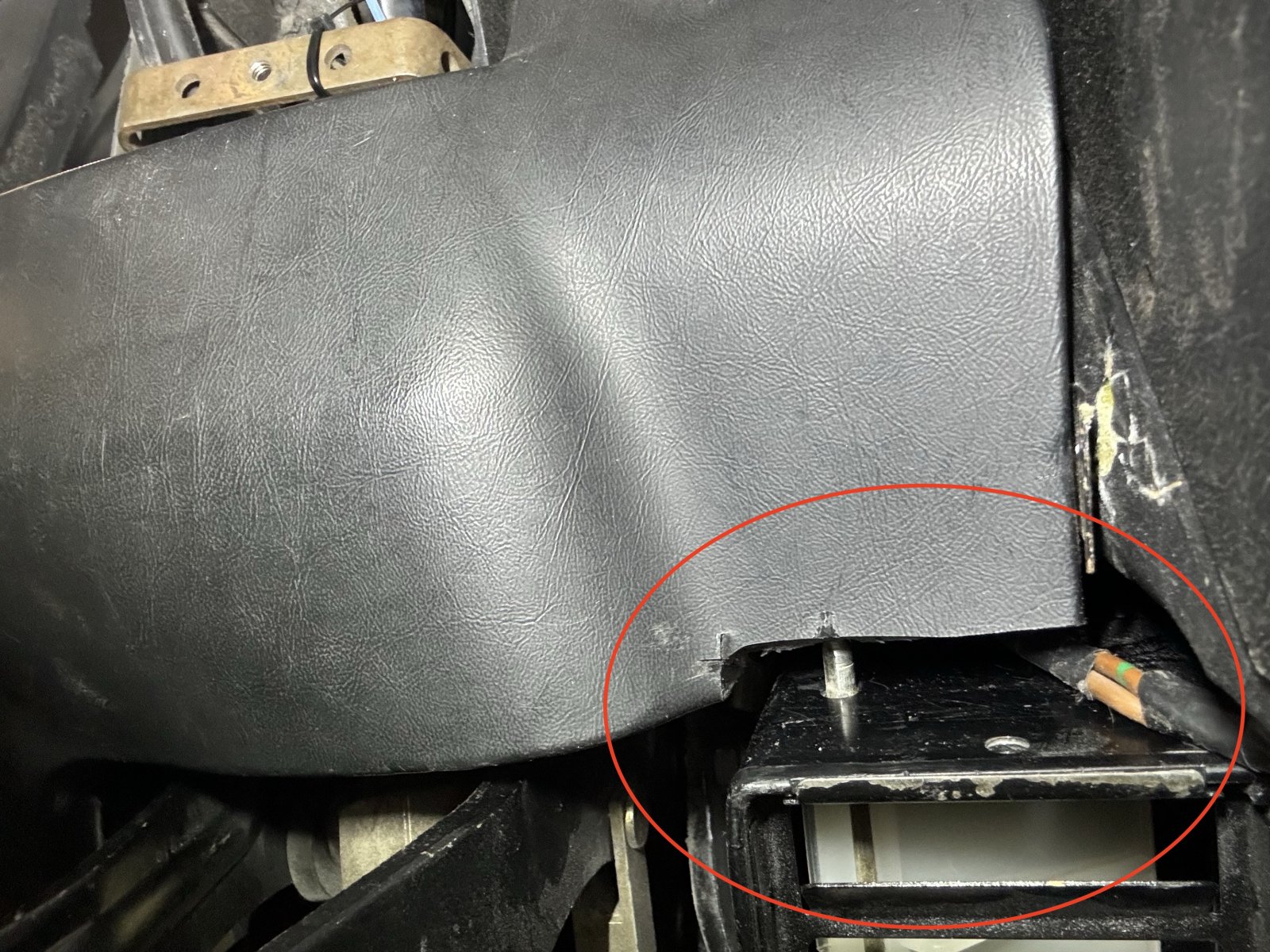

I already trimmed the foam part of it but I have reached the metal framing inside the foam which will require more serious alteration. It is still sticking at least 1cm too far out
(Note that I have indeed tried with it above that metal "pin" and with the brown wires pushed out of the way)

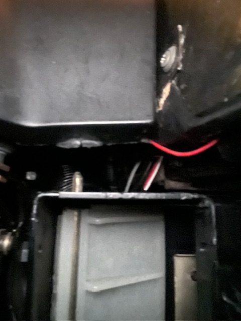

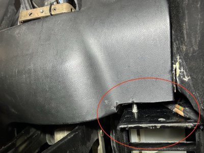

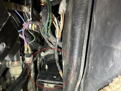

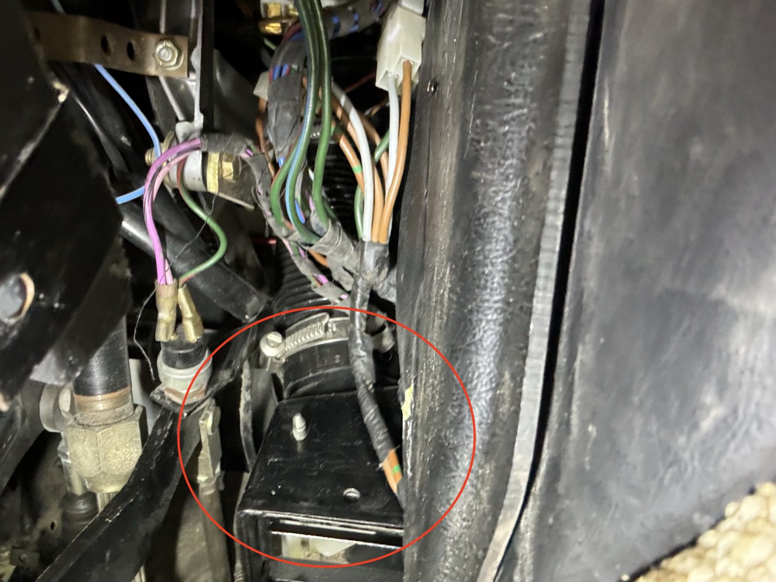

It's hitting this section here:
I'm not sure how it was before since that it was many years ago that I removed it.
Has anyone else had this issue?

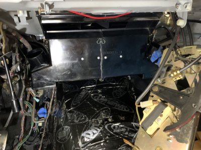

I might add that the heater box was rebuilt and reinstalled but I don’t see how it could have moved since it is bolted onto the firewall.
so did the Dynamat turn vertical on the inside of the firewall? curious if that could have pushed the heater box into the car a bit
The Dynamat suggestion seems like a good candidate to check.
If that route doesn't solve it, then perhaps the panel itself was deformed during storage? After all it is a foam over steel plate construction , where the steel has an almost flat section (no strengthening ribs), thus easy to bend.
Good thinking on both counts, guys, thank you. But the Dynamat was installed long after the heater box was so it does not play a role in this case

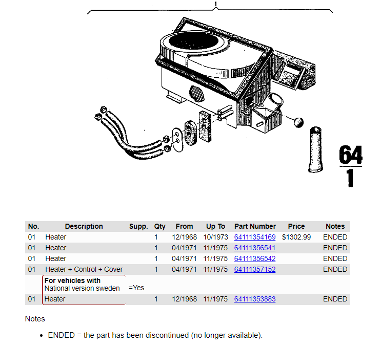

It's almost as if either a) the shape of the heater box had changed during its refurbishment (did its shape change at some point during model years?) or b) the whole unit is not flush against the firewall. But that would seem to be difficult to achieve since it is attached to 4 existing studs welded around the square opening for the fan. On top of that it would have affected the position of several elements of the center console.

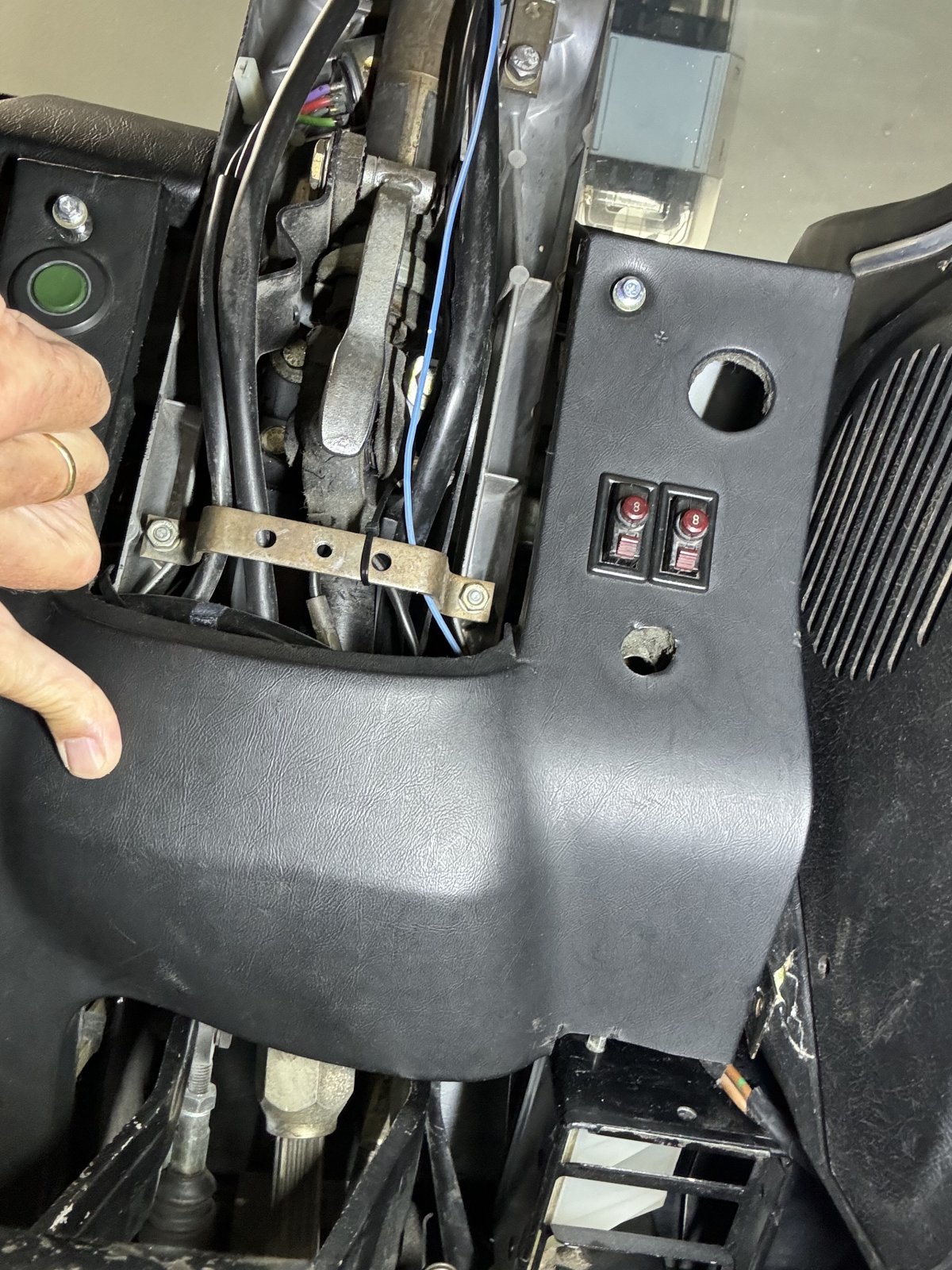

- Deformation could possibly make the panel just fit above the outlet of the heater box, but that's just guessing from the pictures.

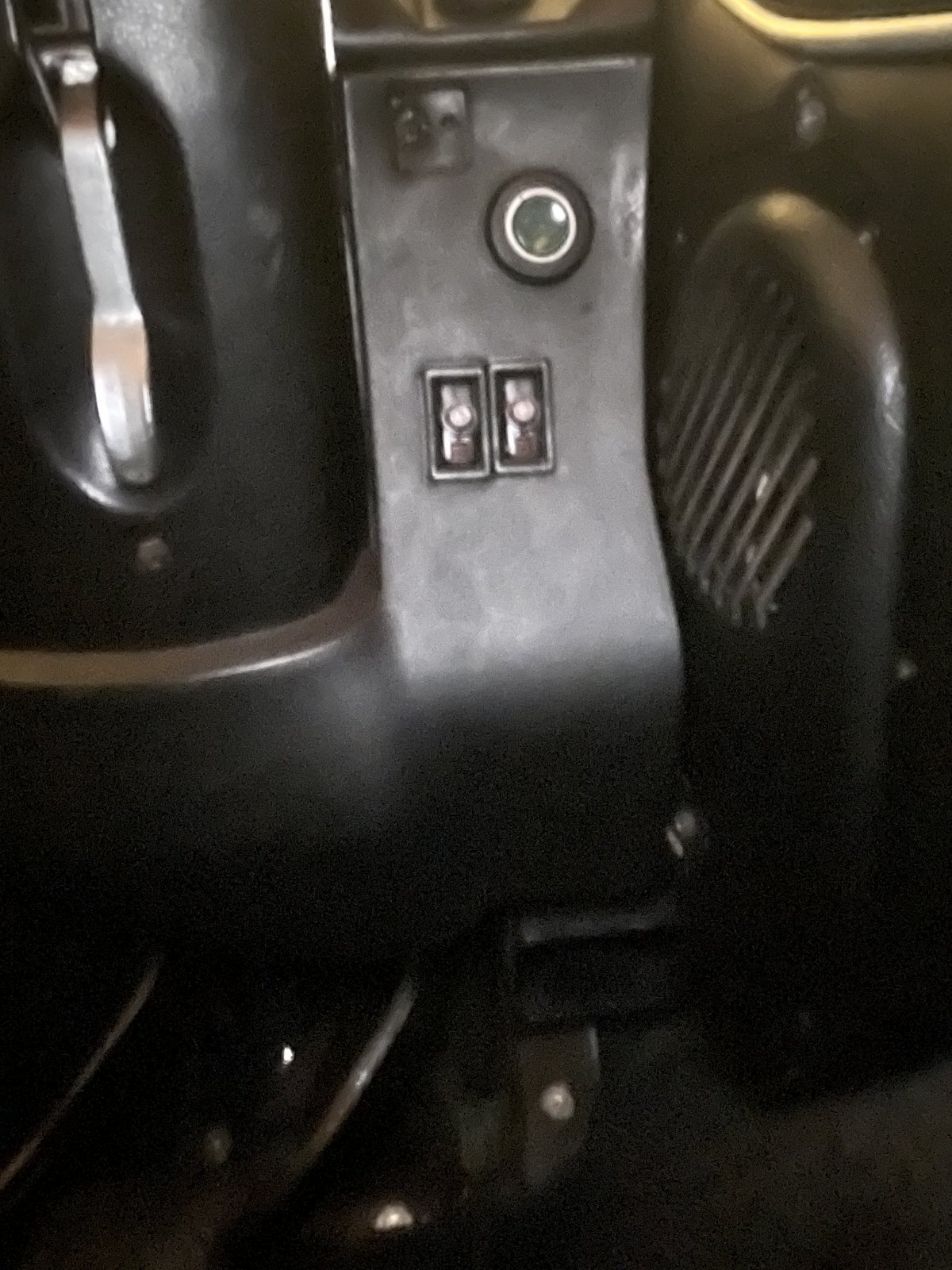

Can anyone with an intact car & panel post a pic of how it's supposed to be (or at least how it fits in their car?) My car is in pieces....

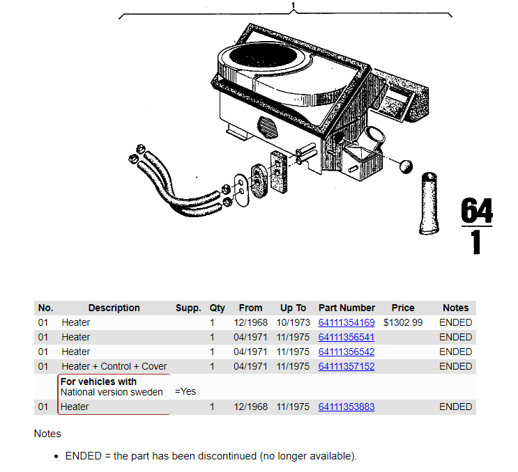

I've never heard that there are different shapes of heater boxes over the various model years. Although Realoem does show a 5 versions:

Right above that hard plastic of the heater outlet is the flex tube that goes to the windshield defrost. And that sits in the same vertical plane so even if the cover panel could be moved further up, it wouldn't really make any difference

Yes. You expect a few fitting issues when reassembling a 50-year-old car. But this is about 1.5 cm off which is more than just old parts that need to be convinced to play nice with each other
At this point the only thing that would make sense is the idea that I accidentally received a slightly different heater box from the guy who rebuilt it. But that seems pretty unlikely. I will have to try and contact him
