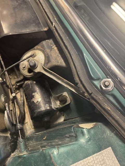

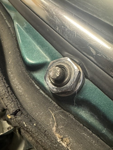

E9_COUP_70 New Member Messages 5 Reaction score 11 Location California Friday at 9:20 PM #1 Mine has stripped where the arm seats. been looking for a long time
Markos Well-Known Member Site Donor Messages 13,500 Reaction score 7,705 Location Seattle, WA Friday at 10:16 PM #2 You are missing the splined busing that goes on the splined shaft. When your wiper fell off that bushing was still held onto the wiper spring clip. You don’t need the whole assembly, you just need the bushing. You can get either from an e3 also. See e3 part out by @ti/sa 193
