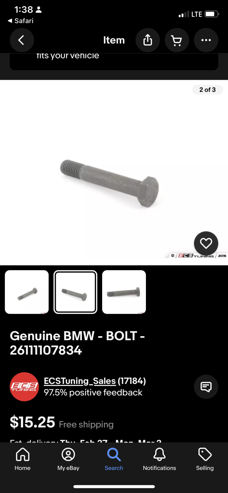

Bmw m12x1.5 x 70mm I need these shipped to La , new they’re very expensive so was looking for used cheaper alternatives , they should be 10.9 grade
The thing about these is they have a very small amount of thread compared to most common m12 bolts the unthreaded sleeve fits snug agains the guibo and I believe it keeps it where it’s supposed but thanks for suggestions I’ll check them out

I have used the standard m12 with the correct length but longer threads , and after removal I seen all the threads got beat up and yes centered it tightened it with permatex and tighten evenly I really do think the bolt wall matters this is a piece with no dowels and sees constant pressure

My experience…you absolutely want the correct bolt. If all six have no shoulder imagine the vibration going on or off throttle. I had one of six get loose and could immediately feel a driveline vibration. Last thing you want is vibration going up the main shaft of your transmission.
I have two friends injured, one almost fatally from guibo failure….more related to driveshaft to output engagement but still, do not mess round here.
