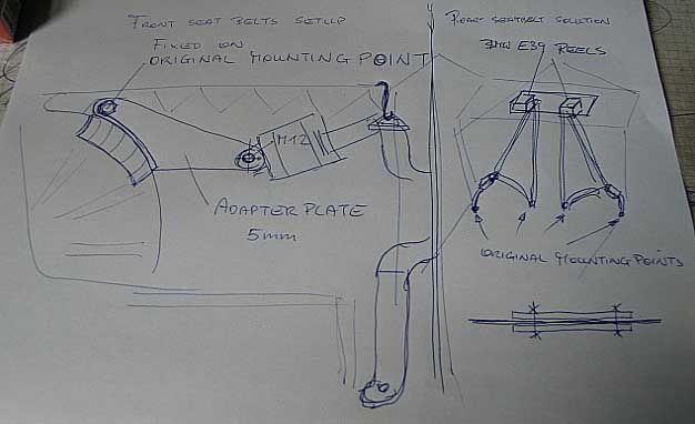

Hard to explain in english, its not my native language :? !
I made a little drawing, i hope you can decipher my hieroglyphs :
The reels i bought via Ebay, unfortunatelly they were built larger than the original "Autoflug"-belts, so they wont fit underneath the rear-armrests.
The belts were like these: http://cgi.ebay.de/Universal-Sicherheitsgurte-fuer-Oldtimer-und-Youngtimer_W0QQitemZ220395223071QQcmdZViewItemQQptZAutoteile_Zubeh%C3%B6r?hash=item220395223071&_trksid=p3286.c0.m14&_trkparms=72%3A1229|66%3A2|65%3A12|39%3A1|240%3A1318
Opening in every position is supposition ! In German we say "neigungsunabhängiger Einbau"
Than i made two adapterplates made of 5mm sheet steel, adjusting to the edge of the wheelhouse and the location of the original upper mounting point.
The covers and the hooks are "handmade".......
In the rear i used BMW E39 belts i bought on the junkyard........
