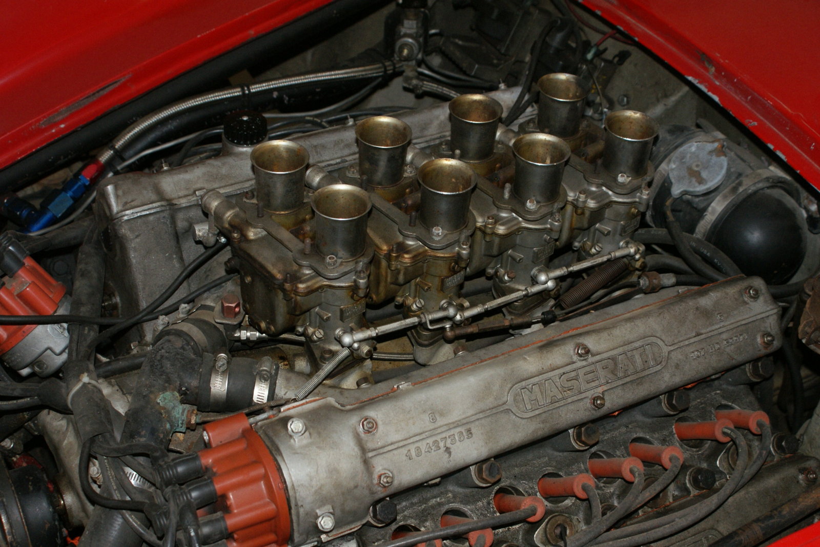

Sure. With a big multi-outlet manifold and a single carb, vacuum by definition has a mixed signal. I've never had good luck with short single barrel carb/manifolds talking to each other vacuum-wise. Z cars that have all 3 carbs with a common vacuum have been a PITA for me. Maybe it's just chemo and I made it up.
