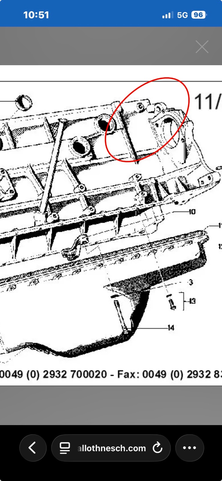

Look at block at cylinder 6
There is a fitting for a hose

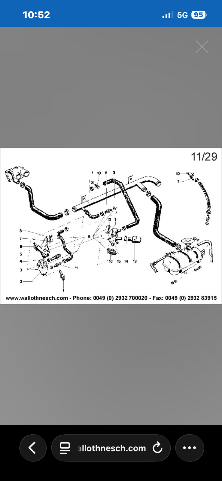

Look at coolant pipe running alongside the block

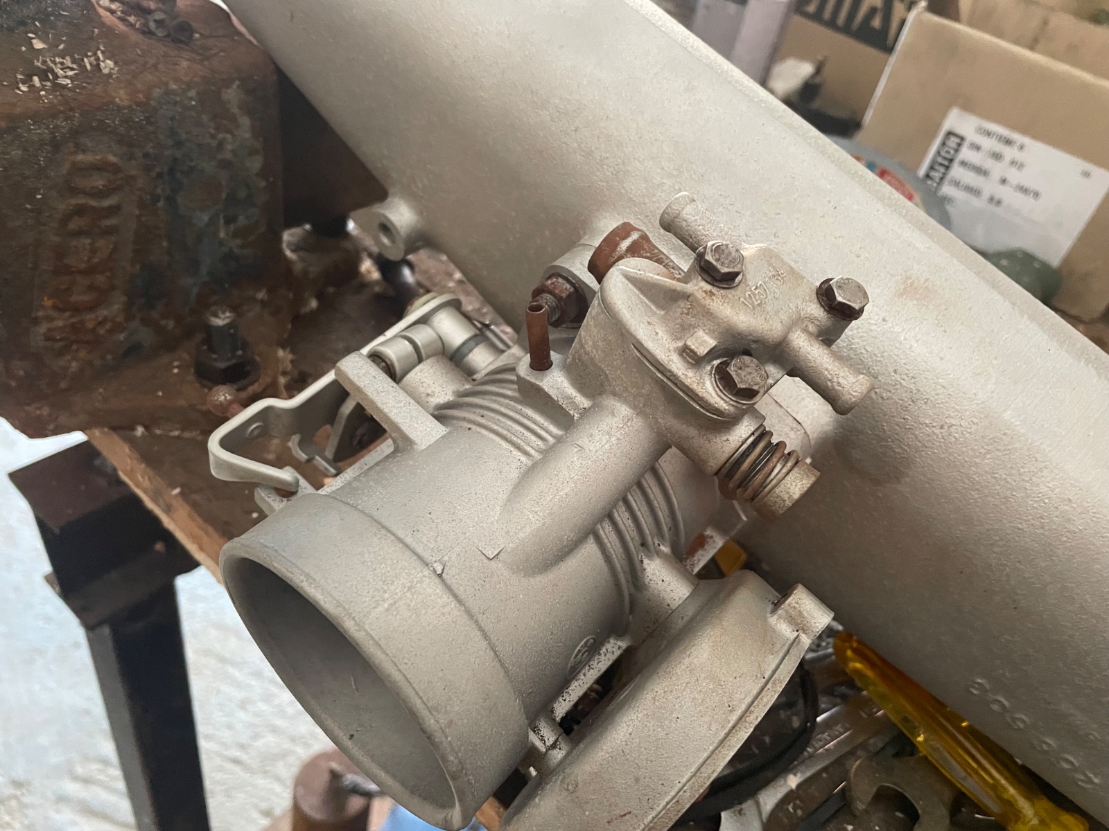

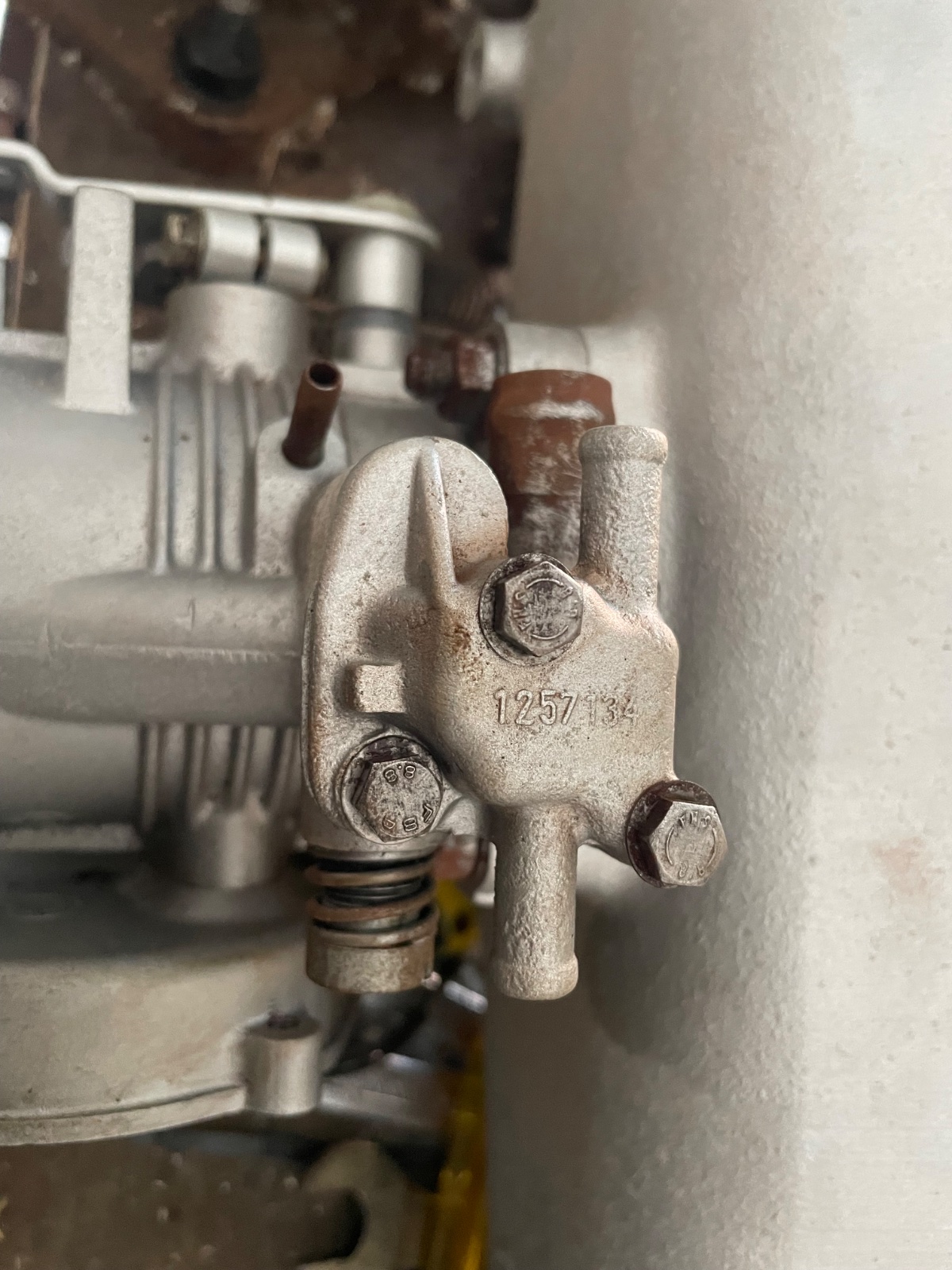

2 more at throttle body
2 more at AAV
Start at rear of block to throttle body
From throttle body hose to AAV to coolant pipe
Complete circuit
