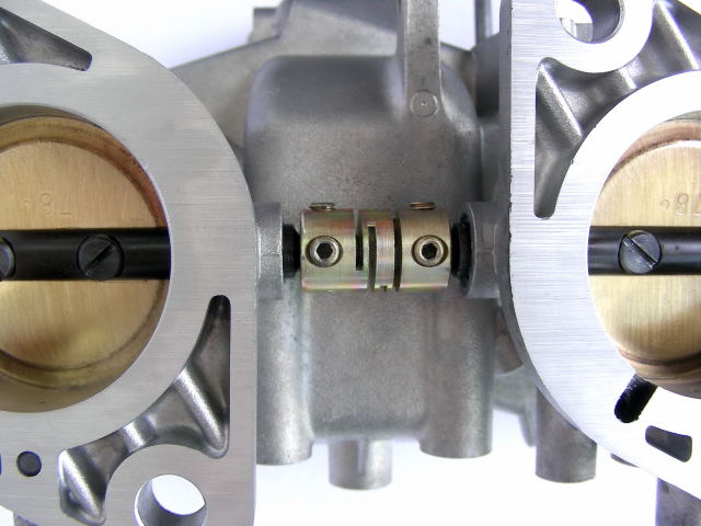

P.S. Here's throttle to throttle bushings
Yes, correct, what I have to hope for is that I don't need to twist it much once the torque is relieved because that will upset the closed throttle mixture settings and position of the plate vis a vis the progression holes and screwing up that balance.
That coupler pictured is used between barrels or carbs? Requires cutting the spindle? What's the advantage of this?

To answer the other poster's question- the picture is of a triple barrel weber for a 911. Eurometrix is a firm that specialized in Porsche induction setups (race) and repairs.
