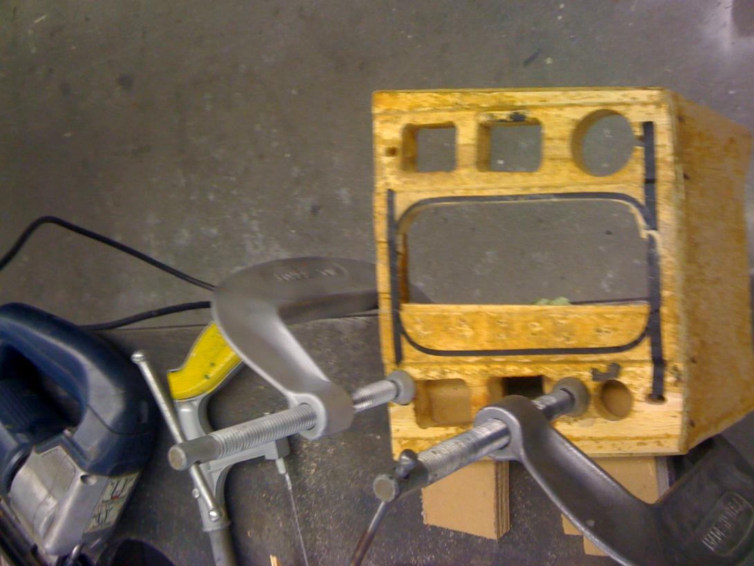

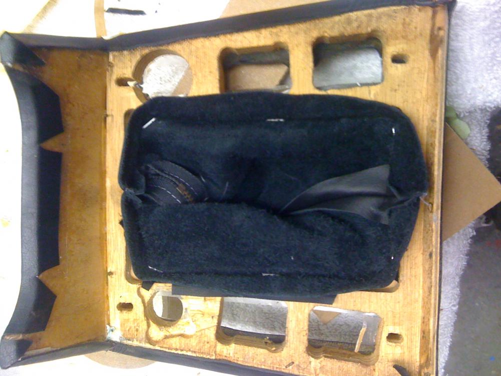

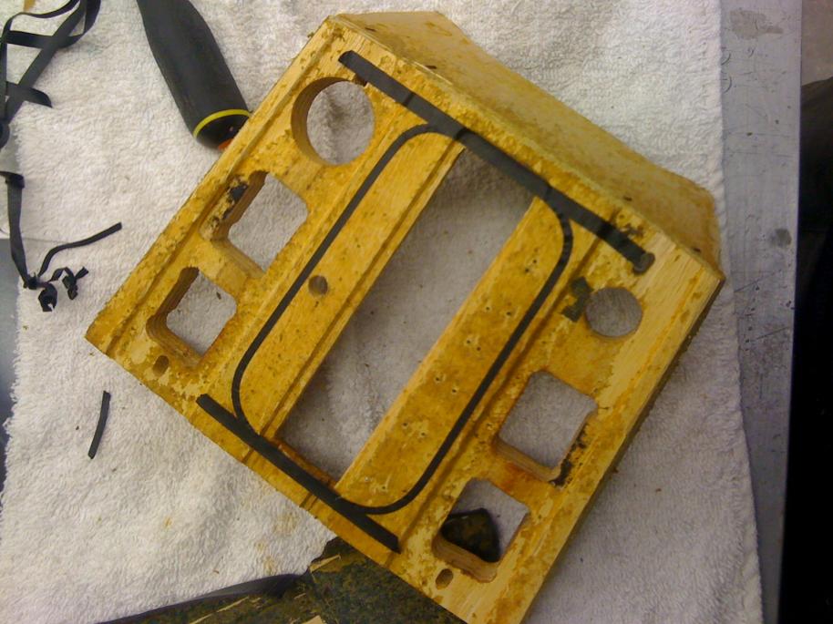

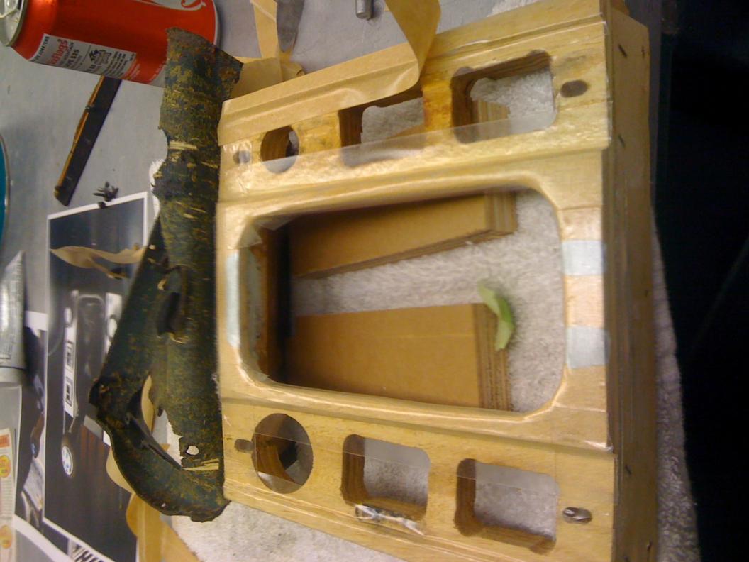

here's a few images of the hackjob I did on my auto console.

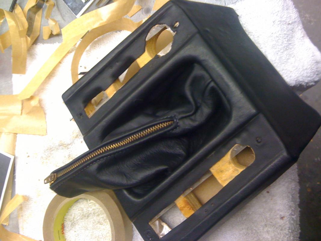

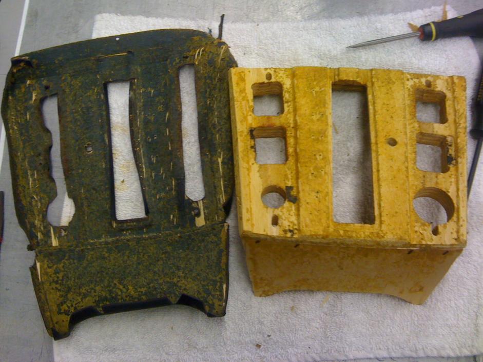

here's the last two.
The shift pattern is a little bit wider on the 5-speed, and so the overall boot is slightly larger to accommodate the reverse throw than the 4spd opening.
this solution i would best describe as "serviceable", as I still need to fabricate a more proper ring to hold the shift boot. Currently it just sinks into the opening, and looks a bit odd. perhaps a carrier ring from a later model BMW with a 5-speed may work?
-Good luck!

no prob, i used a factory shift boot (i like the zipper look), but it did need a bit of a stretch to attach it to the larger opening.
