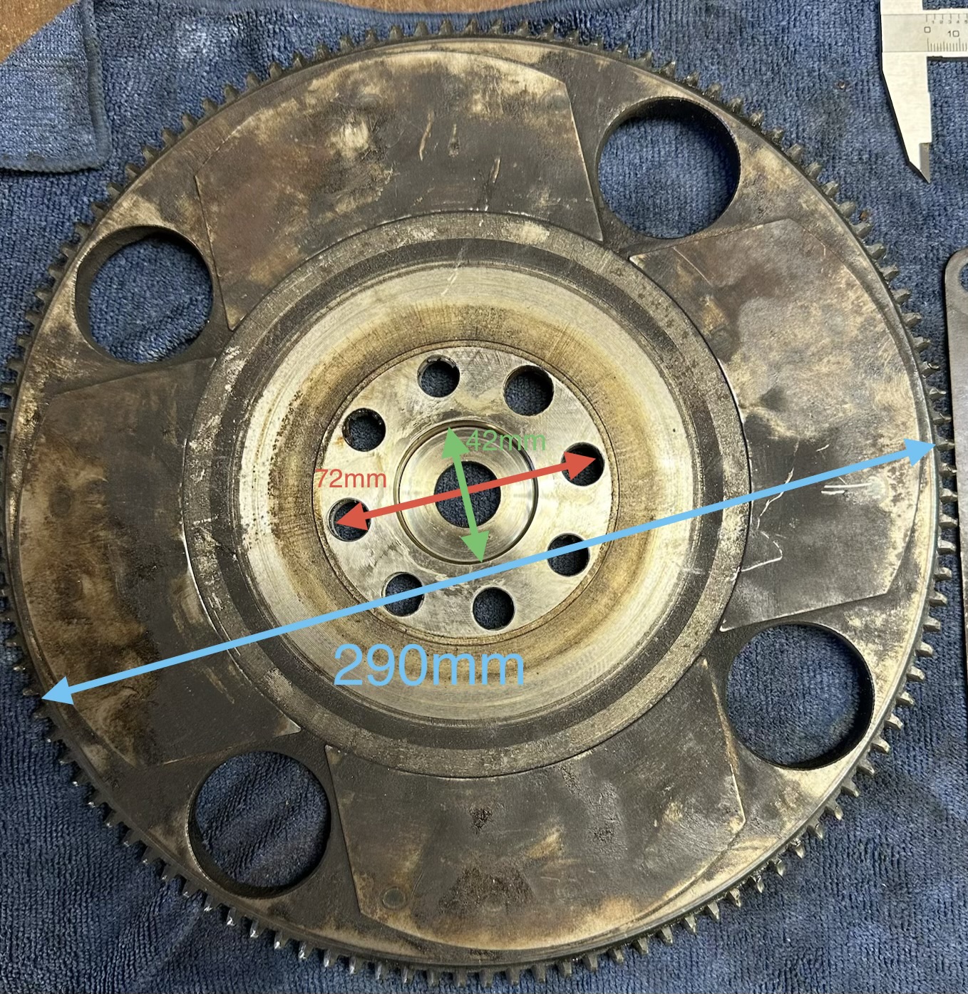

Hi, all. First time poster. I'm having my old 1973 e9 automatic BorgWarner Transmission rebuilt, and the service rep tells me that the teeth are gone on my old Flywheel. So it needs to be replaced. The only problem is that it seems nearly impossible to find even a used one online, so I'm wondering if these are compatible with the ones found on newer models. BMW made the inline-six engine through the early '90s, so I suspect that there are compatible flywheels/flex plates out there that aren't necessarily marked as compatible. Thank you for any light that you can shed. -Steve

Thanks. I talked to Carl earlier today, and he told me that he "might" have one that fits the BorgWarner automatic tranny. I asked him if either of the e23 or e28 flywheels would work, and he said neither were compatible. I assume the ZF transmission is the one that's compatible with other motors, but I don't know for sure. He took my number, and I assume he will call back soon. Still waiting to hear back from the Coupe King. Fingers crossed that one of these shops has one that will work. I'll report back when I know more. Thanks, all!
If nobody else has one, somewhere in the not so easily accessible depths of my loft there should be my old BW automatic and flywheel/flexplate.
My 73 was driving fine, but I converted to a manual. Can't recall what the difference to ZF might be. Remember two different diameter center holes. Maybe the bolt spacing for the torque converter? Post a picture.

I'll ask my mechanic to take a picture of it. Thanks!
Just closing the loop here. Carl wasn't able to find a flex plate before Erik Sliskovich at Coupe King found one, so I drove down to Wilmington, picked it up and delivered it to ATCO Transmission in North Hollywood. They're supposedly going to have the car ready this afternoon. Thanks, everyone for your suggestions.
