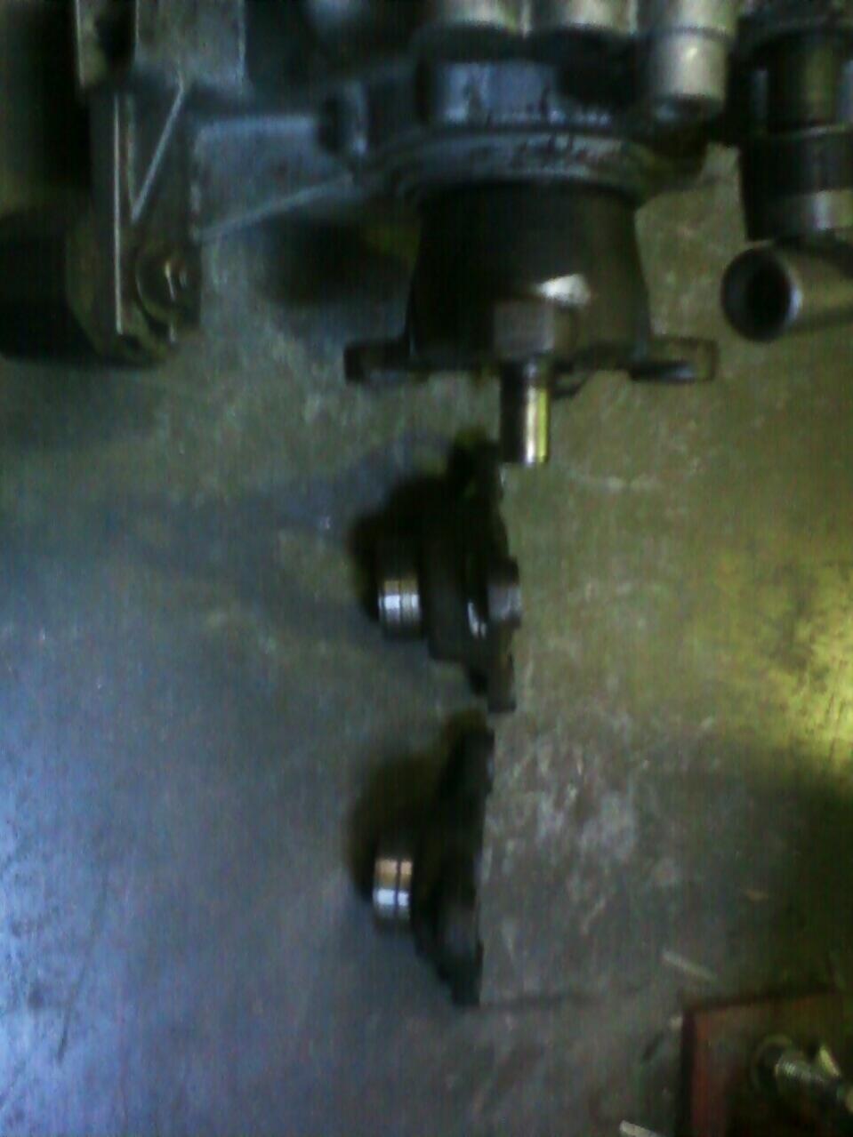

pics of all 3 flanges...

Hi, I was in the process of getting the driveshaft from my auto extended and came across your post. This looks like it will work for me. So this worked for you? Is there anything else I need to know? Thanks
If you want the budget method this is it.
Haven't done one in 5 years like that.
Always better to rebuild the driveshaft
May have to mod the center bearing slots

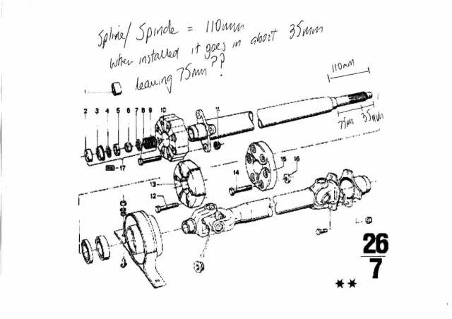

I installed the drive shaft / tail shaft, the spline is about 110 mm long. Once installed it only goes in about 35mm leaving 75mm which I believe is too much. Most of the research indicates that the drive shaft needs to be lengthened about ¾” which is only about 20mm, that would mean that the spline would be in about 55mm out of a possible 110 mm (so half way).
So my questions.
1. How much should I get it extended?
2. The drive shaft centre support bearing is about 30 mm short of lining up with the bolt holes on the chassis. Do I buy a wider guibo?
