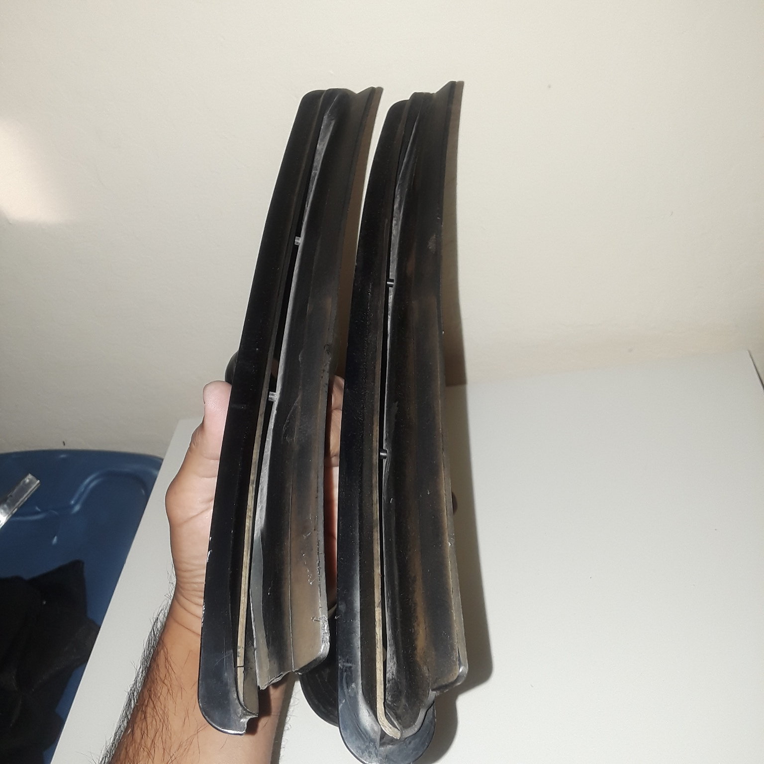

Hello,

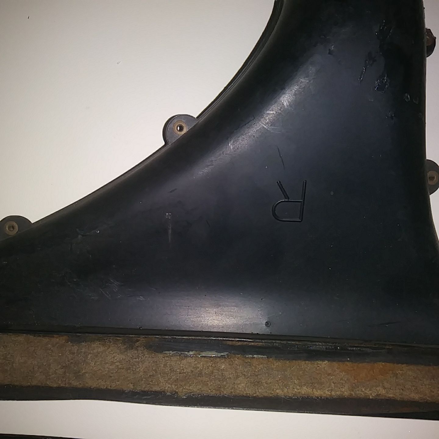

I have a pair of plastic dash defroster vents. All the screw tabs intact. L (left) and R (right) marked. Sold thanks

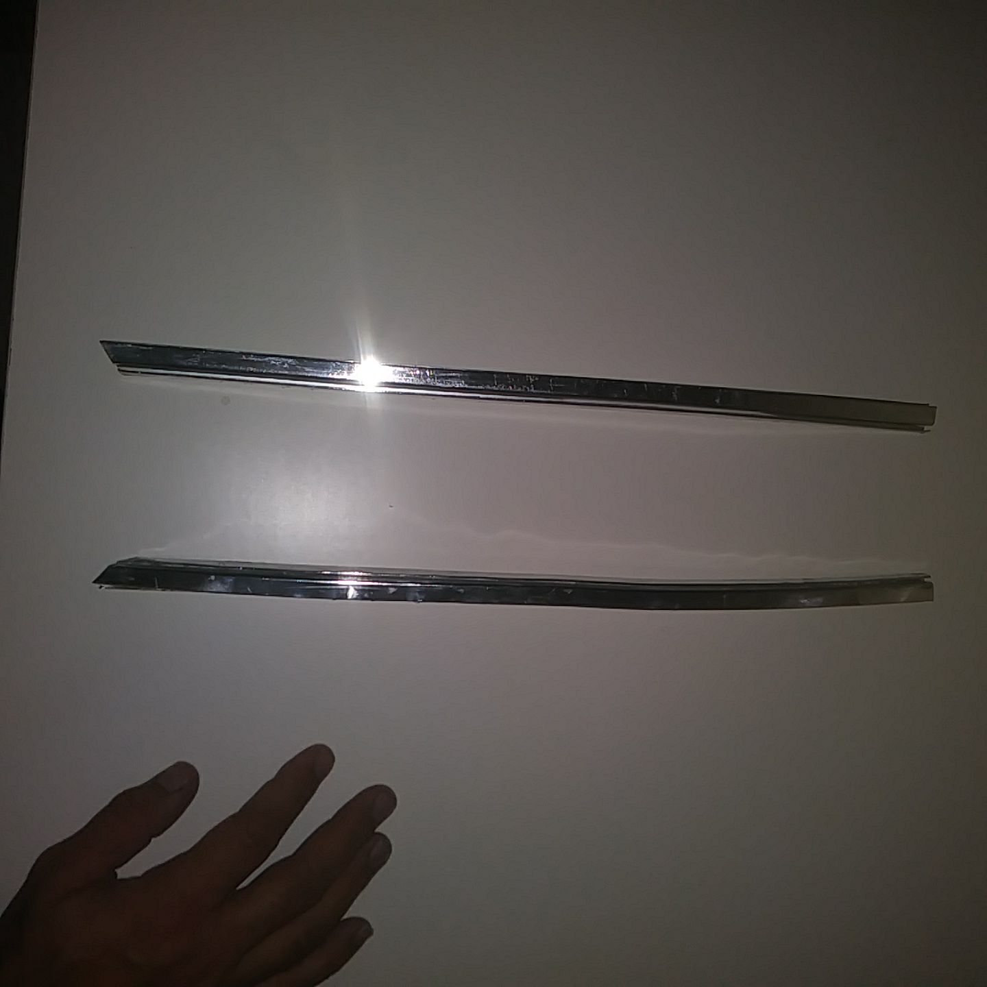

Pair of curved "B pillar" aluminum trim that attaches to rear windows. $75 pair

you should show pics of the tops of the defroster vents ... that's the part that is usually damaged. (cracked or deformed edges)
fyi - the new window trims from W+N is 54 euro. 78 bucks ea. from getbmwparts. part # is 51377740138 + 139. the usual issues of the older / used trims are 1. deformation from removal of the window, 2. deformation of the slot to hold the gasket edge (they should have uniform reveals) + 3. scratches on the chrome work.

I agree with RSporsche 100% . The Window pieces have two surfaces that gets covered with rubber and two surfaces that are revealed. I had bought one from W&N (as they only offered one side , not sure left or right) and the other I had polished and chromed !
Used ones normally have scratches and bends that show...
For what is worth when installing the rubber piece (which are available for both sides about $70 each from BMw or W&N , make sure to put the rubber on the glass First and then press the trim onto the rubber that is on the glass. After the metal piece and the rubber are completely sandwitched together then roll the bouncy section of the rubber that faces the outside the car and press it in Little at a time . With this approach in less than 8 min I was able to do each side .. if you make the mistake of putting the bouncy section of the rubber on the trim Before attaching it to the glass it would be very difficult to force it on the glass, and you would most likely give up...
