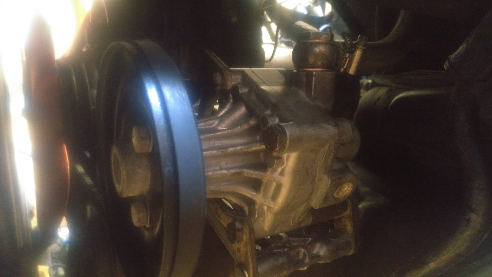

I ended up using the late E28 PS pump too.
Required a custom PS high pressure hose so that both ends use a banjo bolt.

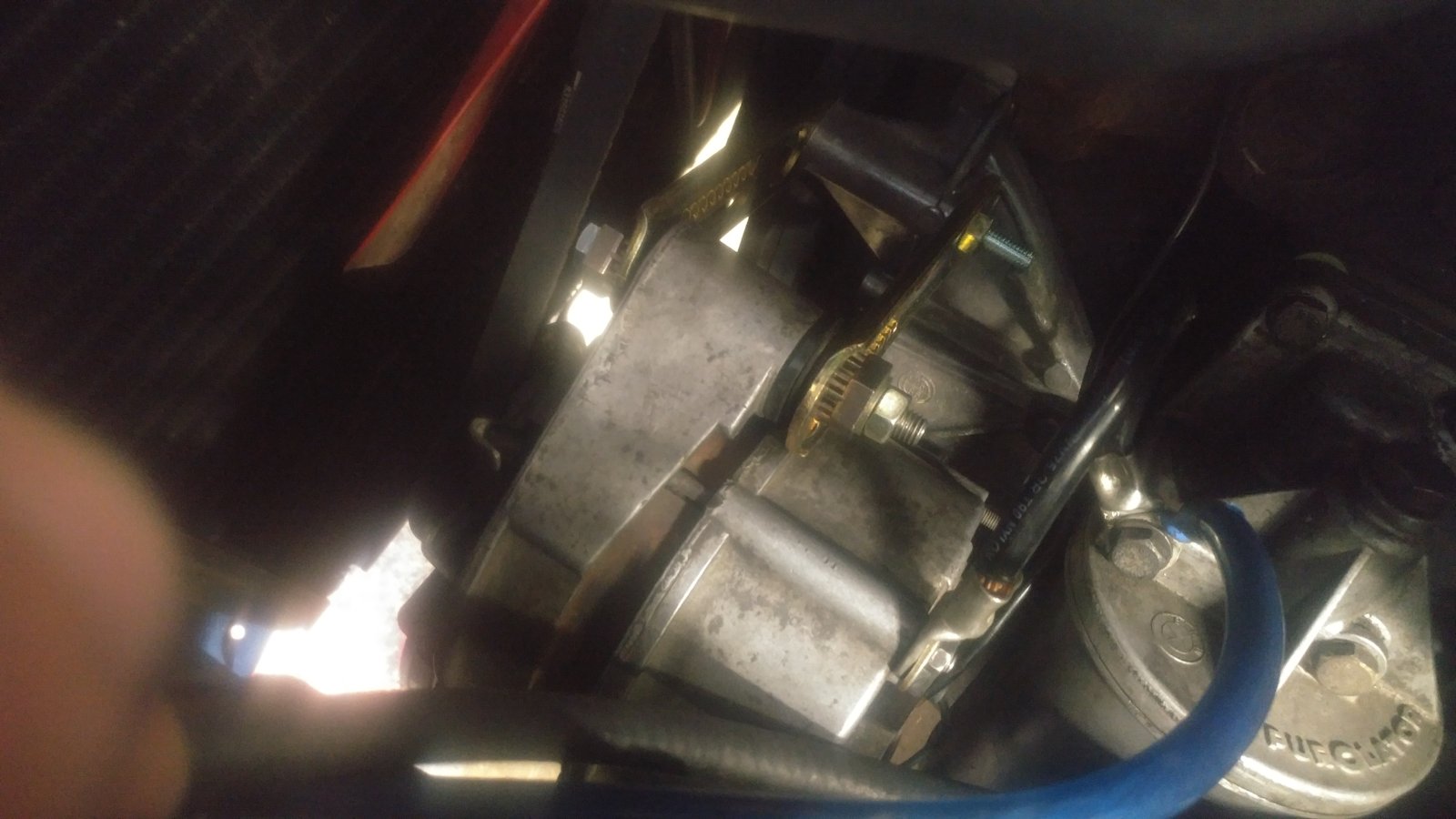

For the alt, I used TWO of those goldish brackets w/the serration for the adjustment nut. Just one side, it was cockeyed.
Everything works great!
