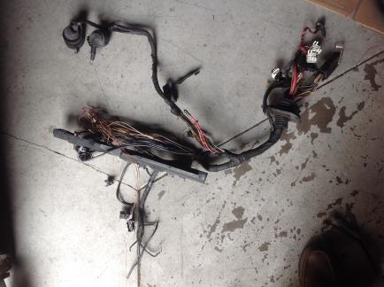

I have just done this.
The engine harness is easy to isolate but you do have to cut some of the tapes which connect the harness for the front of the car and the ABS..
On the LHS of the engine bay where the EMC sits, there is a simple positive terminal. You will need the relays there so keep them too. I kept the whole box.
On the RHS there is the fuse box but after trying to get to this, I stopped the job at a large multi-wire circular connector which feeds a number of wires into this. I worked out that this would include the ignition along with a whole heap of other wires not needed for our cars, such as cruise control, et al.,
When re-fitting, I will separate these and connect the relevant ones through my existing fuse box.
I took one out for you to see today.
