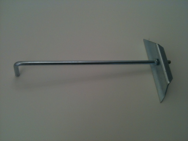

So I ordered the L-shaped hold down w/ bracket from PenskeParts and can't for the life of me figure out how its supposed to work. The stem has a fixed flange, so the length cannot be adjusted. The 90 degree "hook" ends up about 2" higher than the battery!

The trapezoidal piece is supposed to go over the base of the battery (the other side of the battery slides under the edge of the tray by the fender so it's locked in place) then you screw it down. It should hold it tight unless your threads are shot like mine so I bolt it from below. There should be clearance between the top of the battery and the handle.

The trapezoidal piece is supposed to go over the base of the battery.....
...which assumes that your battery has a flange at its base that extends out along the two long sides. If your battery just has smooth sides then the OE hold-down has nothing to push against.
I fabricated a non-stock hold-down for my coupe that has two rods extending up vertically above the top of the battery that secure a piece of flat stock across the battery top. It definitely looks non-original, but my battery isn't going anywhere.

Thanks, guys. Yes, my battery does have a flange. So there's supposed to be clearance? That's what was throwing me...

Yes the battery is held at the base flange, the hook at the top is the handle and doesn't touch the battery top

And what about the wave washer? It's threaded onto the stem pretty tightly; does it go above the tray or below, after the stem has been threaded through?

Typically the wave washer goes on top, the bolt bears down against it when tightened. It's a DIN style lock washer. Least that's where I always found them, under a bolt head.

Parts diagram shows the washer threaded onto the stem below the tray, and the stem came with one already threaded onto it just below the flange, so I have two...

No washer needed under the tray or on top, just screw the post into the tray. You might want to clean the threads with a Tap first.
