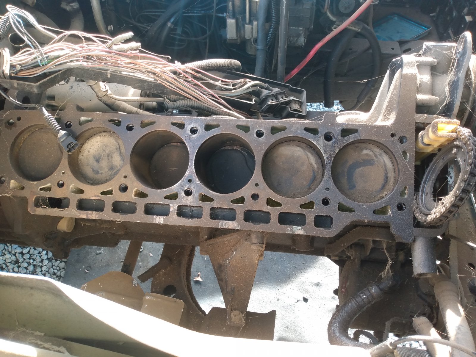

The car’s original b28 would have been my first choice. Unfortunately, this is how it looked when I bought the car
All clear. No more words needed.

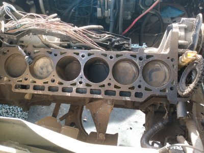

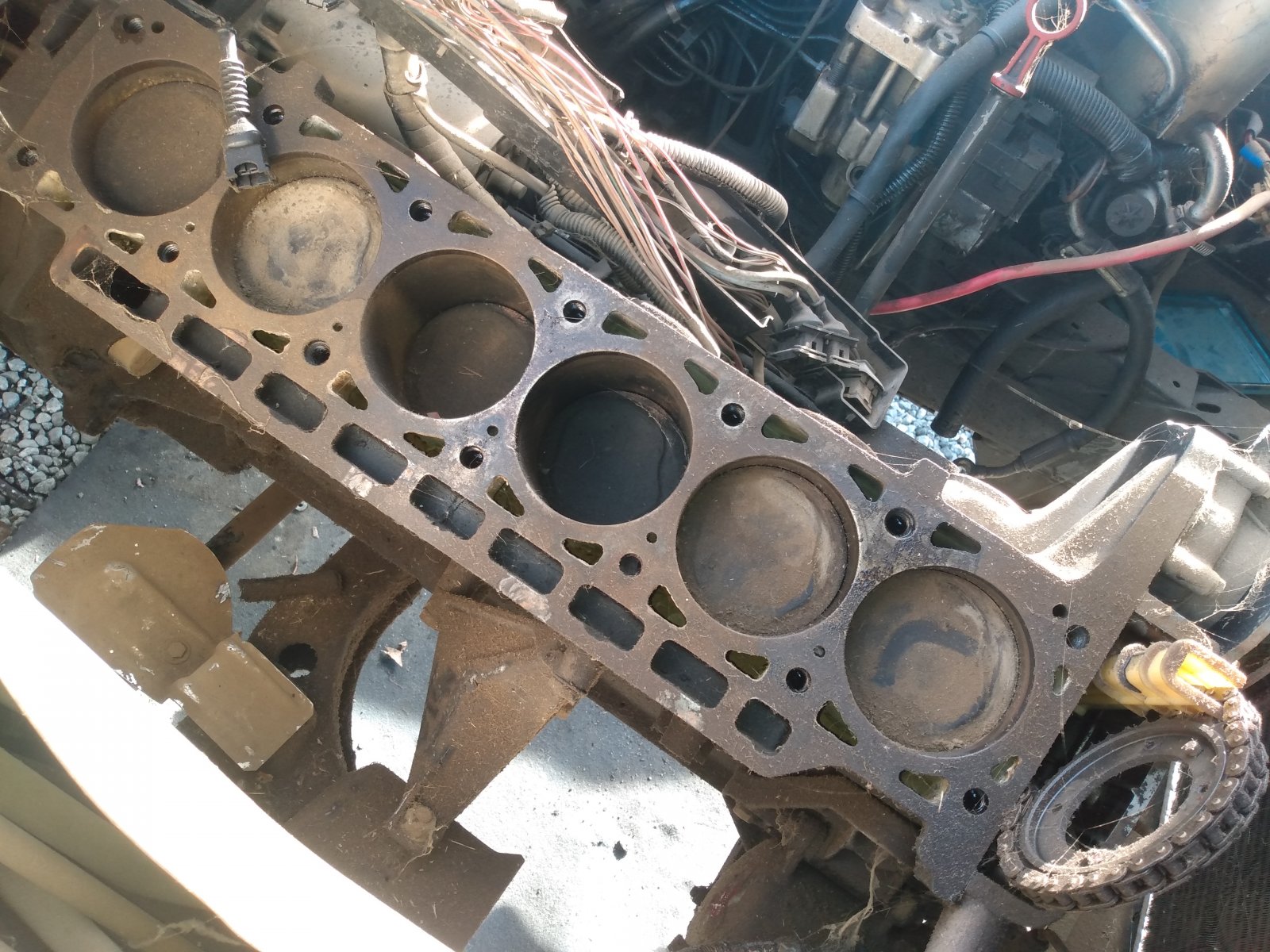

Okay, so I called the parts place selling the e32 (M30B35) engine and they were going to perform a leakdown test on it but called back saying the engine is locked up. They even put oil in the cylinders and let it sit overnight but no luck. I am assuming this is from sitting for a long time…
They offered it for $225+tax
Is it worth driving 1.5hrs one way to get it? How likely is it that the cylinders will need to be rebored?
With that in mind, I am now thinking maybe if I get it and with my bad e32 engine, I can make a running one...?

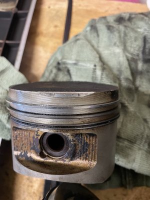

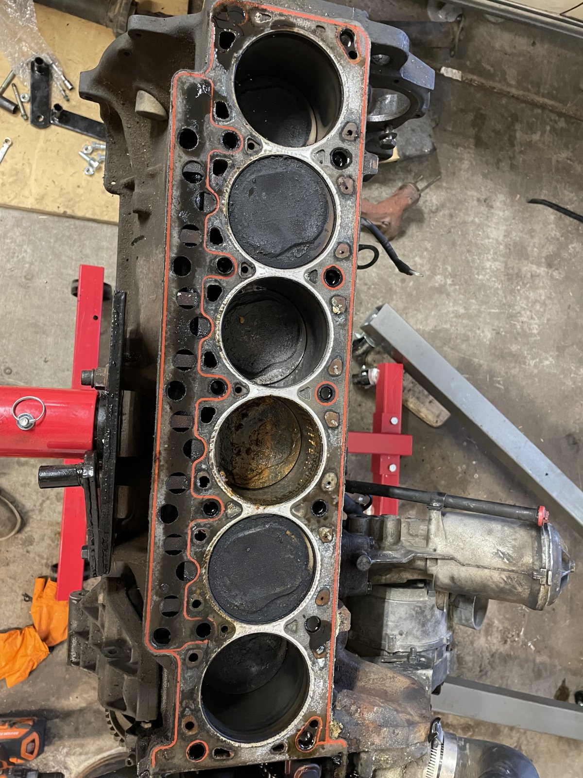

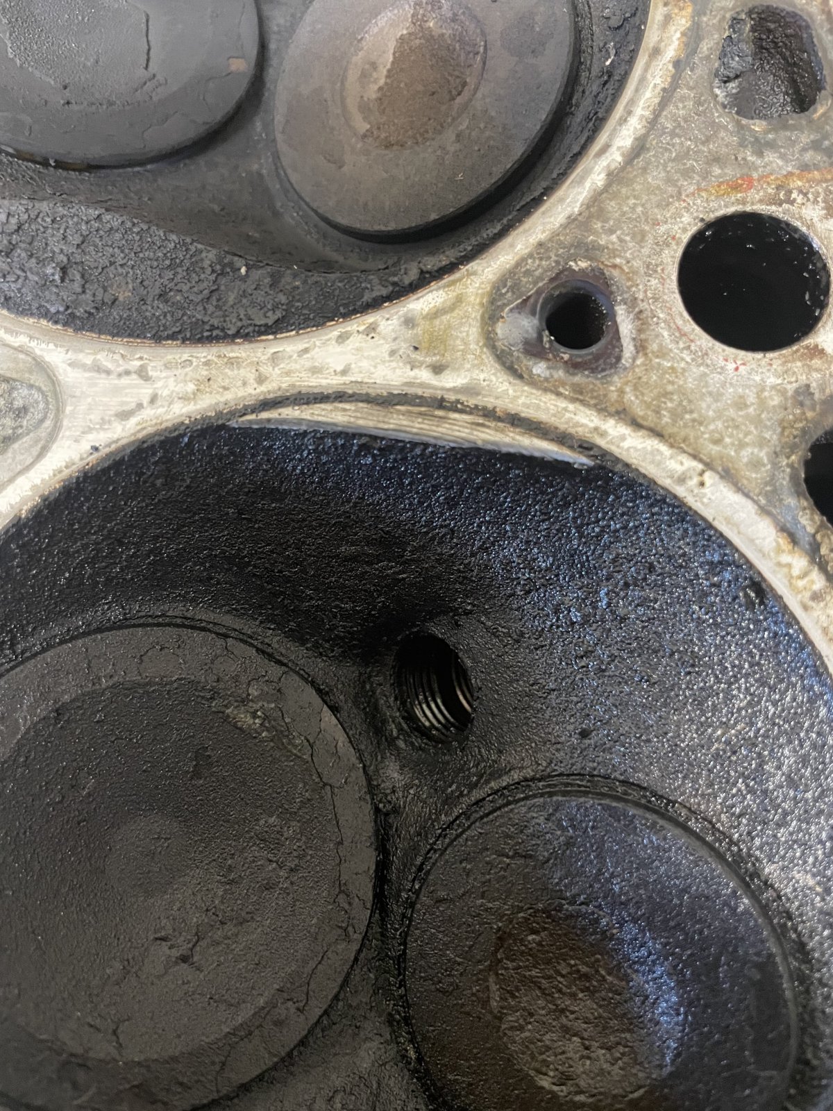

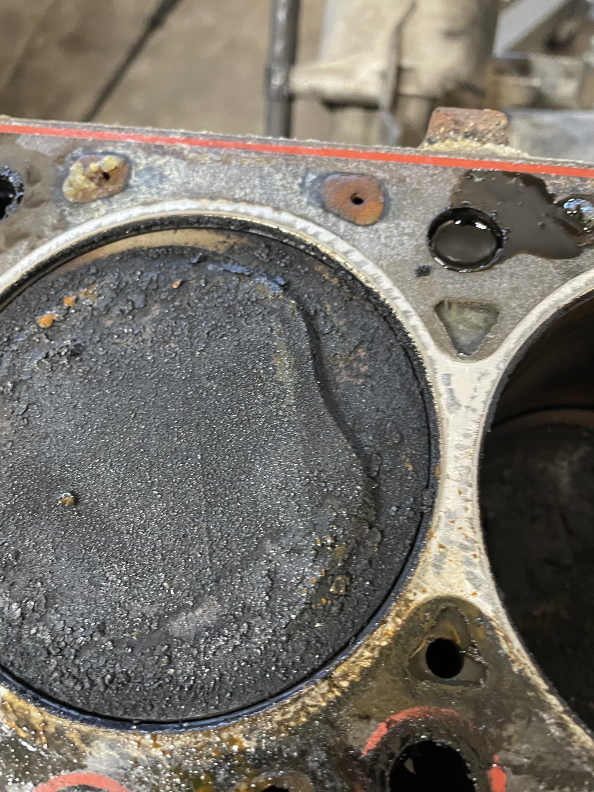

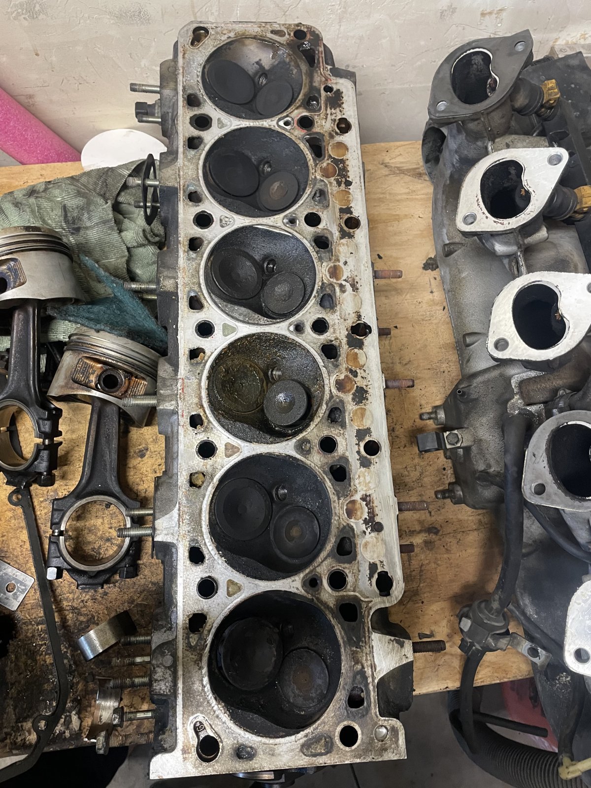

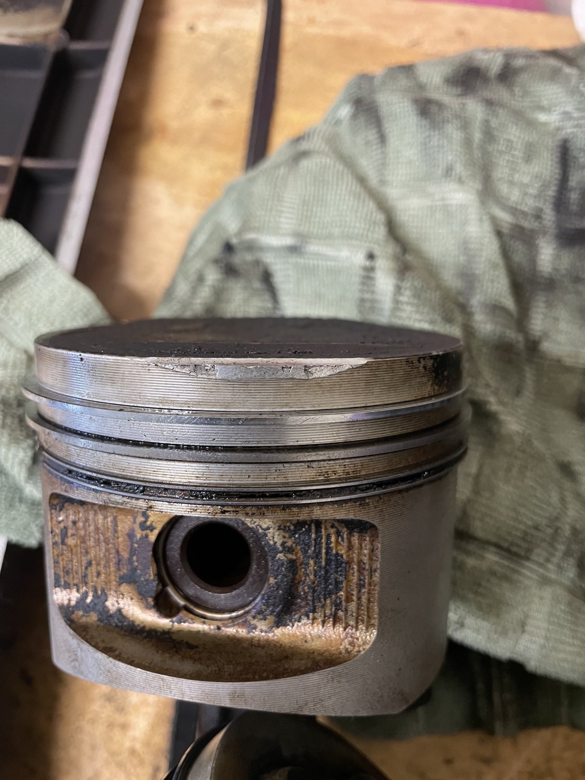

Revisiting the B35 motor I have, here are the issues I found:
  1. two spun rod bearings + one rod bearing was completely missing causing the rod knock. Piston edge was hitting the head on a small area. head seems to be okay. this is probably due to lost oil pressure.
  2. One cylinder had light rust but When I cleaned there was a little surface pitting (compression test was around 200PSI due to oil/fluid in cylinder)

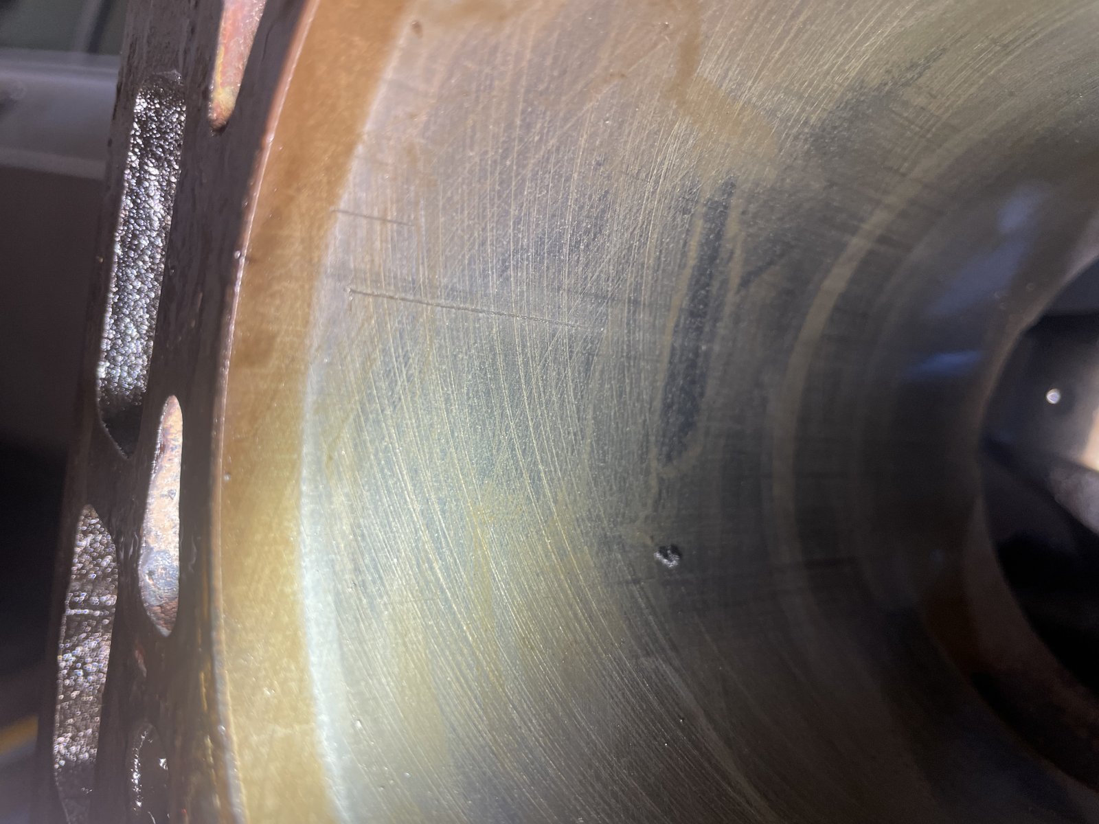

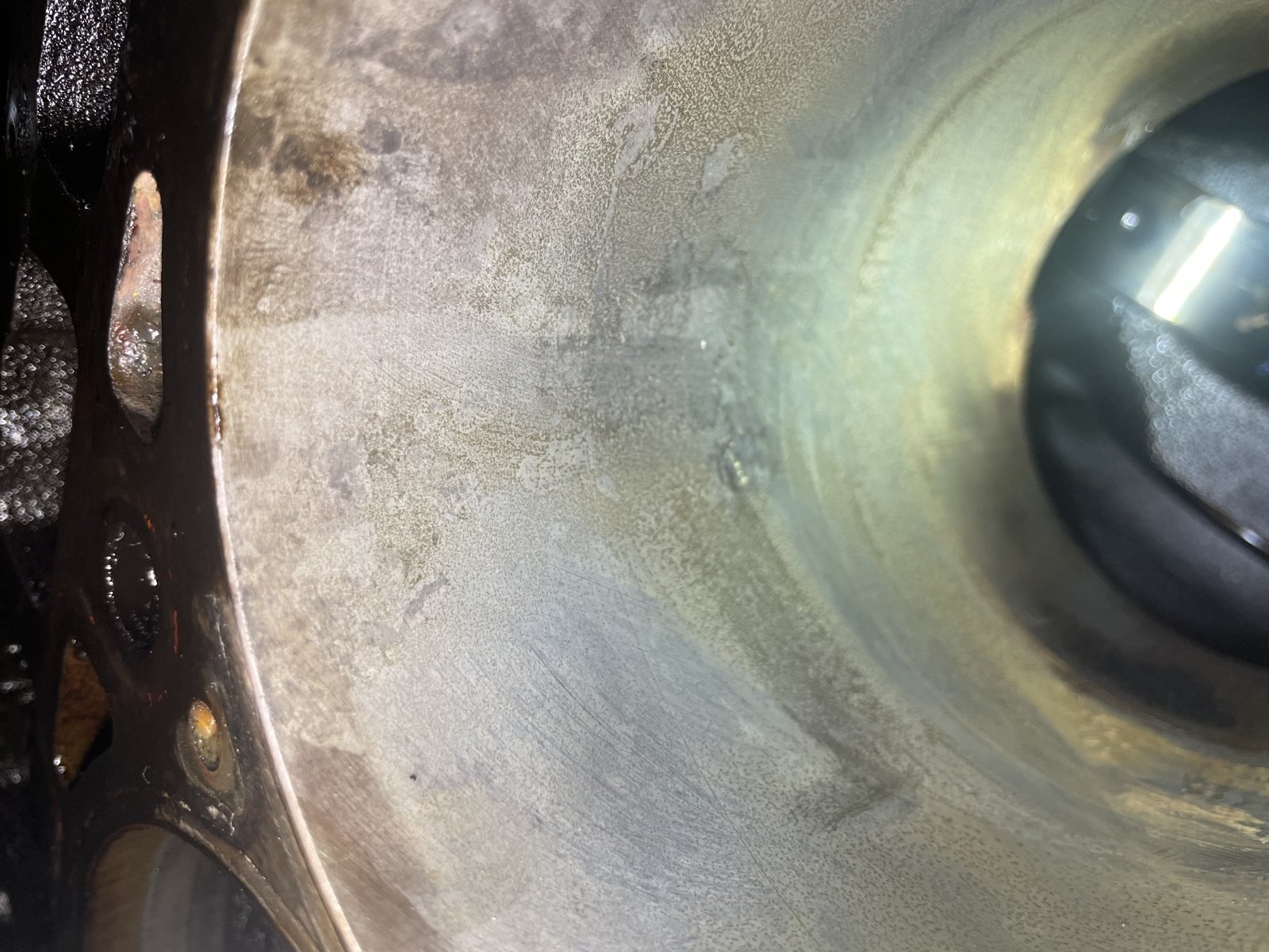

  3. another cylinder (the bad piston) has two scratches that I can feel with my finger and my nail catches on them. one of them is ~ 2" long. (Compression test for this cylinder was ~60-70PSI)
  4. I found oil in most of the head bolts block cavities. is this normal?
the 4 other cylinders compression test was around 160-170PSI

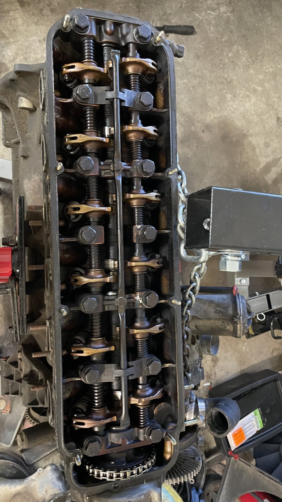

More pics

Never pay money for a siezed M30b35..
Tell the seller to take their own trash out.
Your pics show me an engine that needs to be hauled away.
