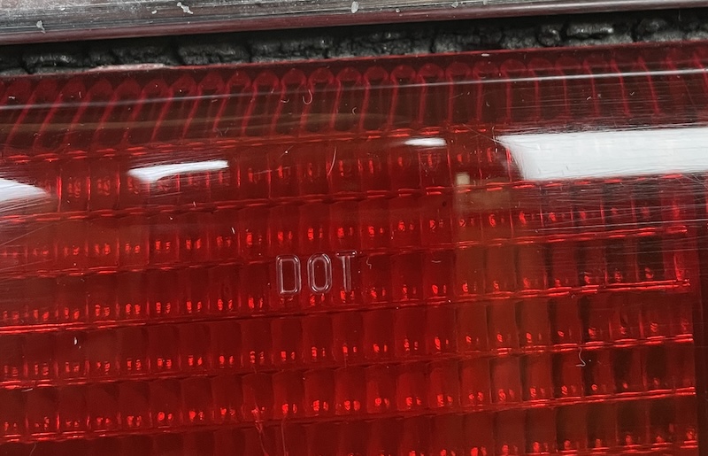

This on my right tail light only. All other markings on both tail lights are identical....
My guess is that the left tail light is a used, non US replacement and that before replacement both were marked with DOT. The DOT marking on US E3s may be the only difference from ROW E3 tail lights.

Still confused, but getting better. There are three pairs of lenses: 101/102 ECE, 103/104 France only, 105/106 USA, odd numbers always left side. The French pieces came with amber reversing lights, these are out. The rest might be just numbers and signs. Late production lenses seem to have all markings, so they can be used in the ECE area, nearly the whole world, as well as in North America. @Dick Steinkamp showed the DOT marking, I found that on my spare lenses, too. ECE parts have markings for nearly every single lens, particularly ECE R6 for "direction indicators" and ECE R7 for "position lamps" and "stop-lamps". When I went through the pictures of the poor Bavaria sold recently on BaT, the rear lights had no ECE markings, maybe a set of original 105/106.
