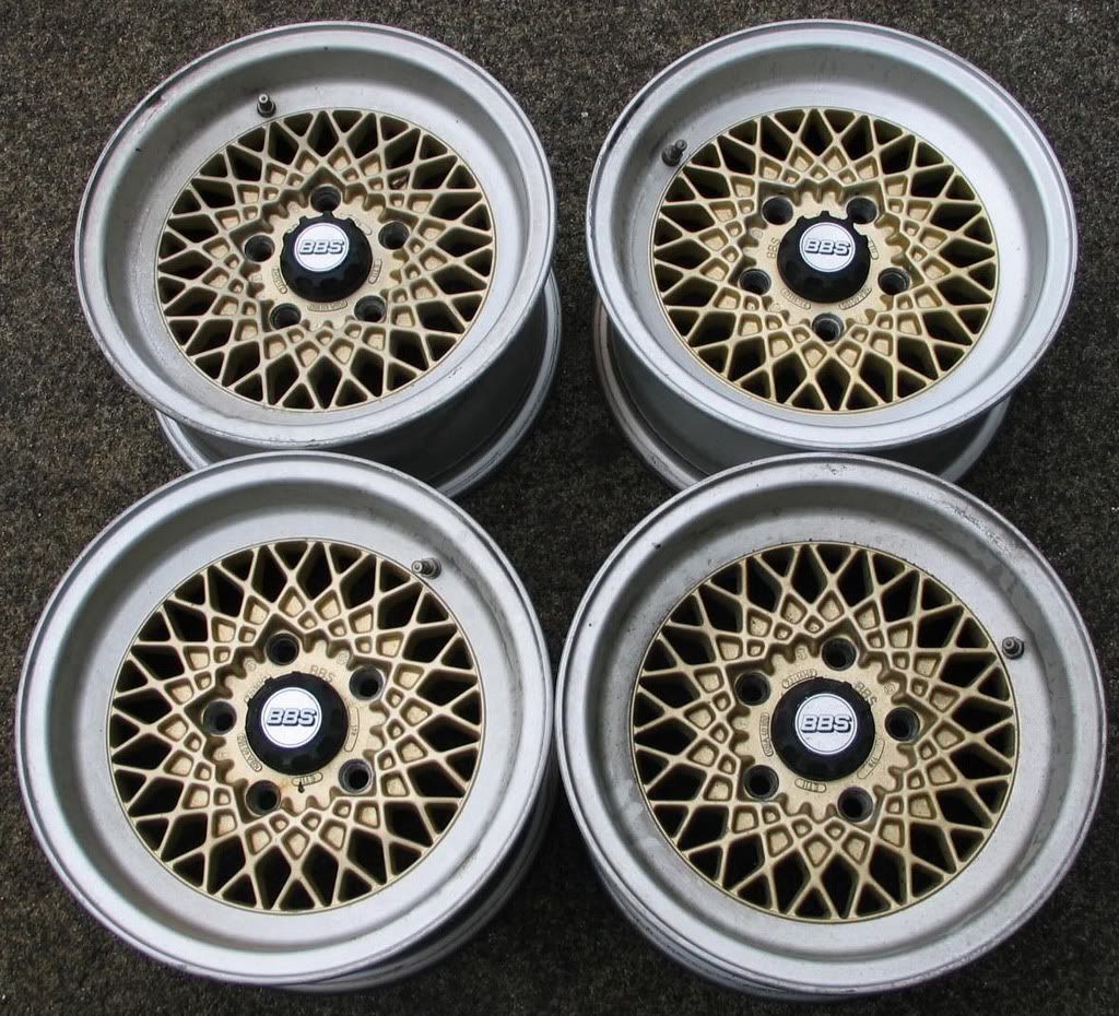

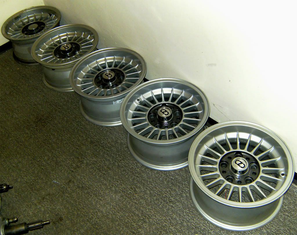

First of all, if you want to go for originality, no 14" BBS Mahle belongs to a CSL !
There´s only one rim, and thats the 7x14 alpina-style !
If Et10, Et11 or ET12, whatever!
2 mm, you should not care a damn about it !
You like the BBS-Style ? Mount them on your car !
You want go for originality? BEWARE !

thanks coupeking ....
you have a picture of the rims I'm looking for?
in fact from what I'm looking for the circles that are almost equal to the wheels that brought his good friend orangener photos ...
have photos?
have an "et" of 10mm and the rays are slightly curved 30 degrees ...

Hello,
on the theme "Mahle - BBS" I have collected some information. In my view, the aluminum plant Mahle had produced the first prototypes. These have been produced but apparently only for publicity photos and were not officially for sale. The problem is to raise these rims is very problematic of the tires.
Then followed a venal Produktiontyp was poured where cast BMW, Mahle and KBA40069 in the rim edge.
And at some point the production of the company BBS was taken over and now Mahle-BBS, and KBA40070 cast in the rim edge.
Finally, a few pictures and documents
http://www.file-upload.net/download-1908646/BMW-Umr-stkatalog.pdf.html
http://www.file-upload.net/download-1908652/RA-38.pdf.html

formidable Gosch,
I've made felicwe with little ...
finally I see with my own eyes the differences and the circles that I'm trying to buy ....
