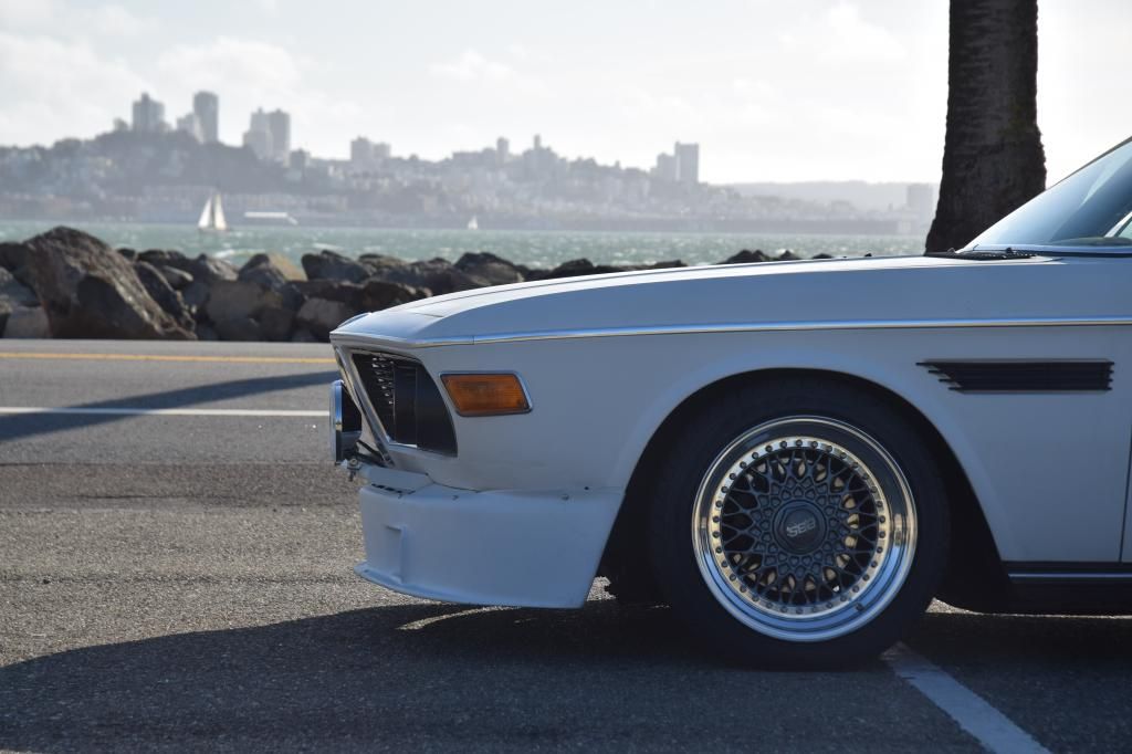

I have been searching for a set of 16" RS II's and was hoping someone could confirm that the 16's with et11 offset are the way to go. I'm not sure whether I will go with all four corners the same or staggered. Can someone confirm the offset for the 16X8's in the rear?

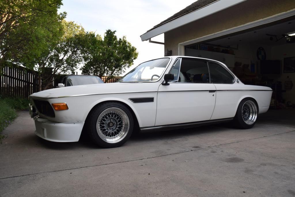

These are 16x8 and 16x10. I mounted bigger outside lips.
Barry
Offset

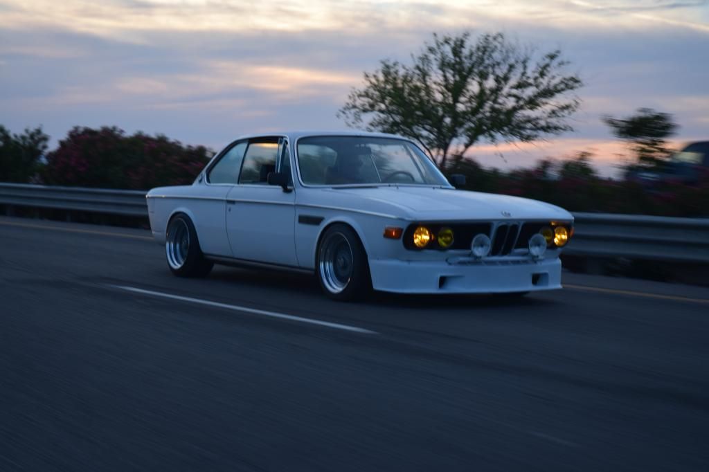

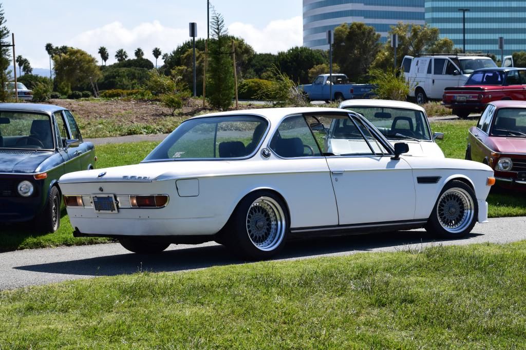

I have never felt the 16" alpinas fit very well. I wondered if the offsets were more suited for a six series. Over almost 20 years I have had a number of wheel and tire combinations on my car. I set up my car to drive (not to show) so I expect the tire not to rub on the front rolled fenders even if I hit a curb parking at full lock. I think the only 16" x 7" wheels that will do this on my car with a a modified euro suspension are 20mm offset. Since some BBS are split three piece I would go for 20-25 mm offset and use a spacer of 1-4 mm if needed.
I like a matching 16 x 8 on the rear where the offset is less critical
