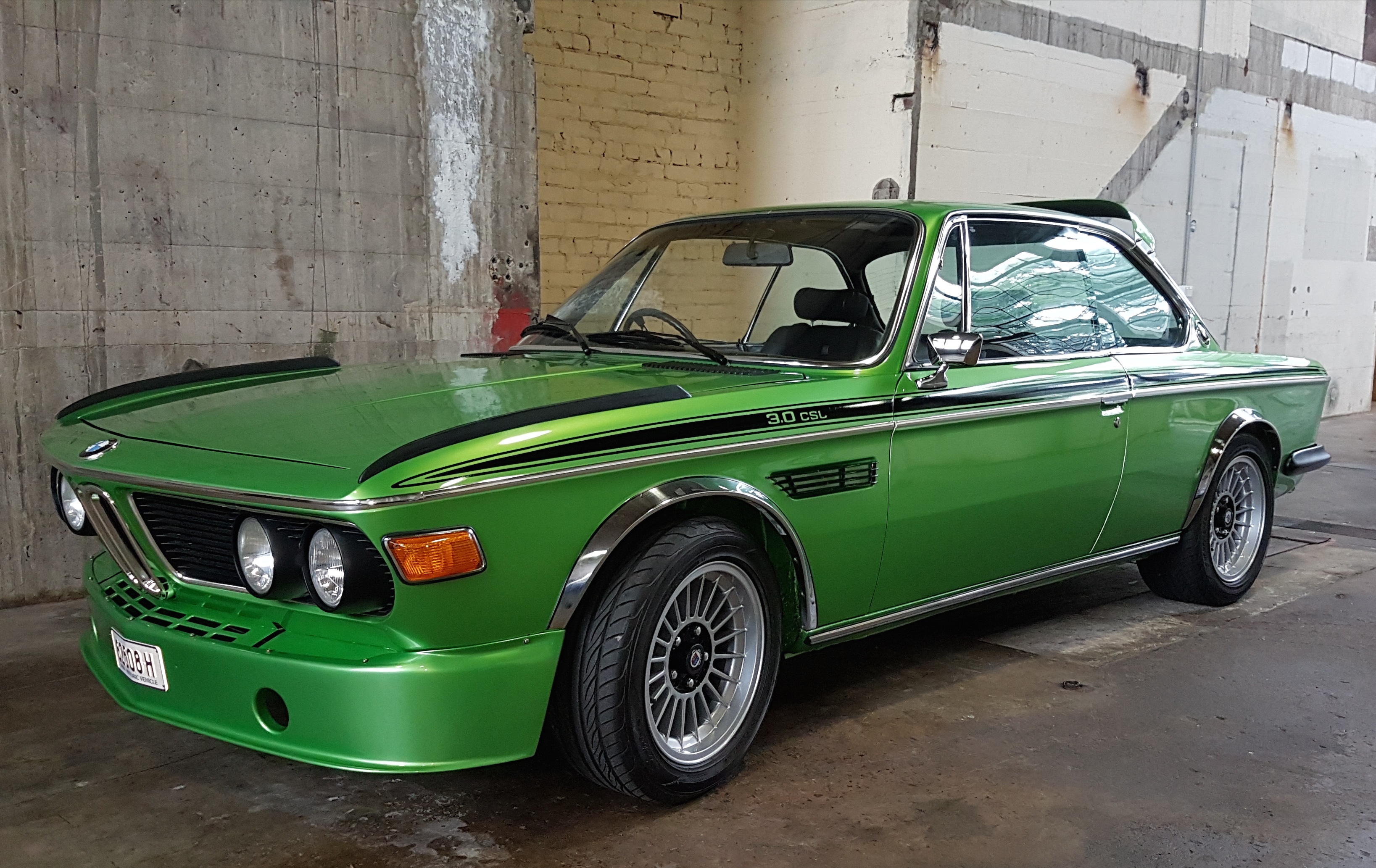

Beautiful CSL Mal!! Are your BBS’s 16x8 at the front?
If you kept your front wheels and just replaced your lips to 1 inch lips instead of the current 2 inch lip, would that fix the problem?
i tend to think that with standard springs you will have less of a problem than with lowering springs. as long as you run 205/55-16 tires, the width of the wheel is less important. those are beautifully finished BBS wheels.

Mal, are you running 205/50 or 205/55-16's? standard matching original diameter is 205/55-16

You are likely going to have problems with a 8x16” ET20 hitting your shocks, not your lip. It is when you space it out to avoid the shock that you will risk hitting your lip.
doesn't a lower ET offset number move the center of the wheel further out? or am i remembering it wrong again? its only a 4mm difference than the RS 006

Yes. ET20 is 20mm closer to the strut from center. So a lower number such as ET11 (which is standard for 7” E9 wheels) moves the wheel only 11mm closer to the strut from center. However, an 8” Wheel at ET11 would hit the fender. The main problem with 8” ET20 wheels up front is that the tire is very close to the strut. Lowering the car won’t change that fact, and neither will camber plates. You solve the strut clearance issue on a factory setup by adding a spacer, which pushes the whee towards the fender. Once you do that camber plates can help you clear the fender.
Also stretched tires help. Personally I don’t like the look of a 205/55 tire on an 8” wheel, but I think it would okay up front. I have this setup in the rear and it looks pretty’s tupid IMO. I don’t mind the look of stretched tires on 18” “stanced” cars but it looks pretty lame on my car. They look too small, not “stretched” in the modern sense.
