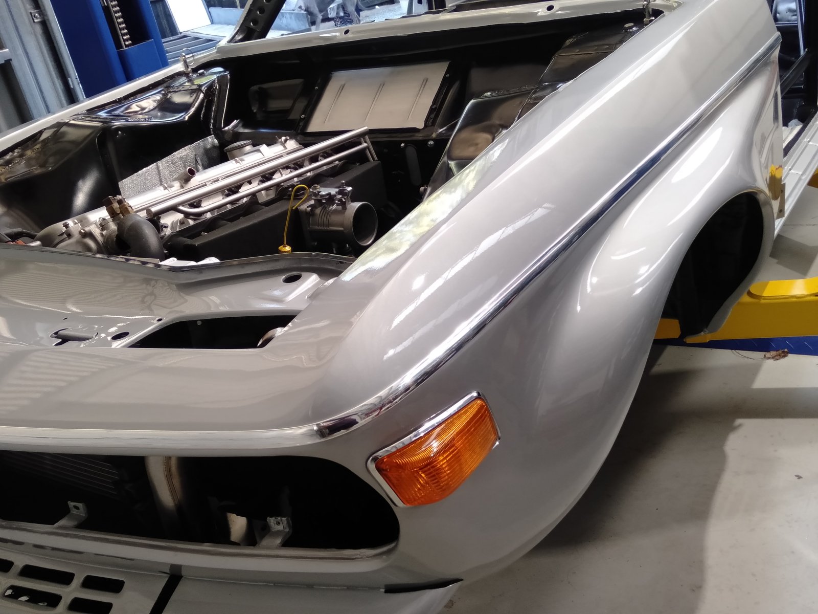

I tried searching using a variety of terms and I haven't be able to find anything on how to remove the side trim.
If anybody has done a write up on this I would appreciate being pointed in the right direction, thanks.
