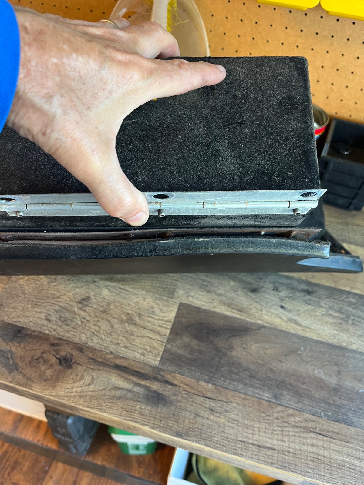

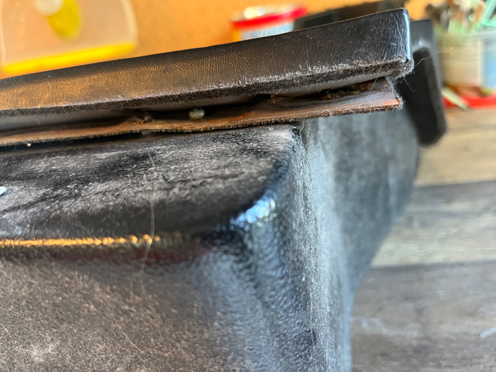

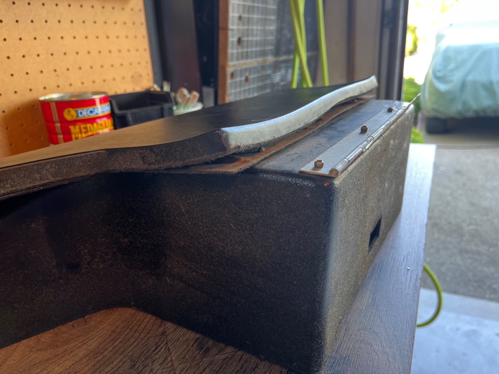

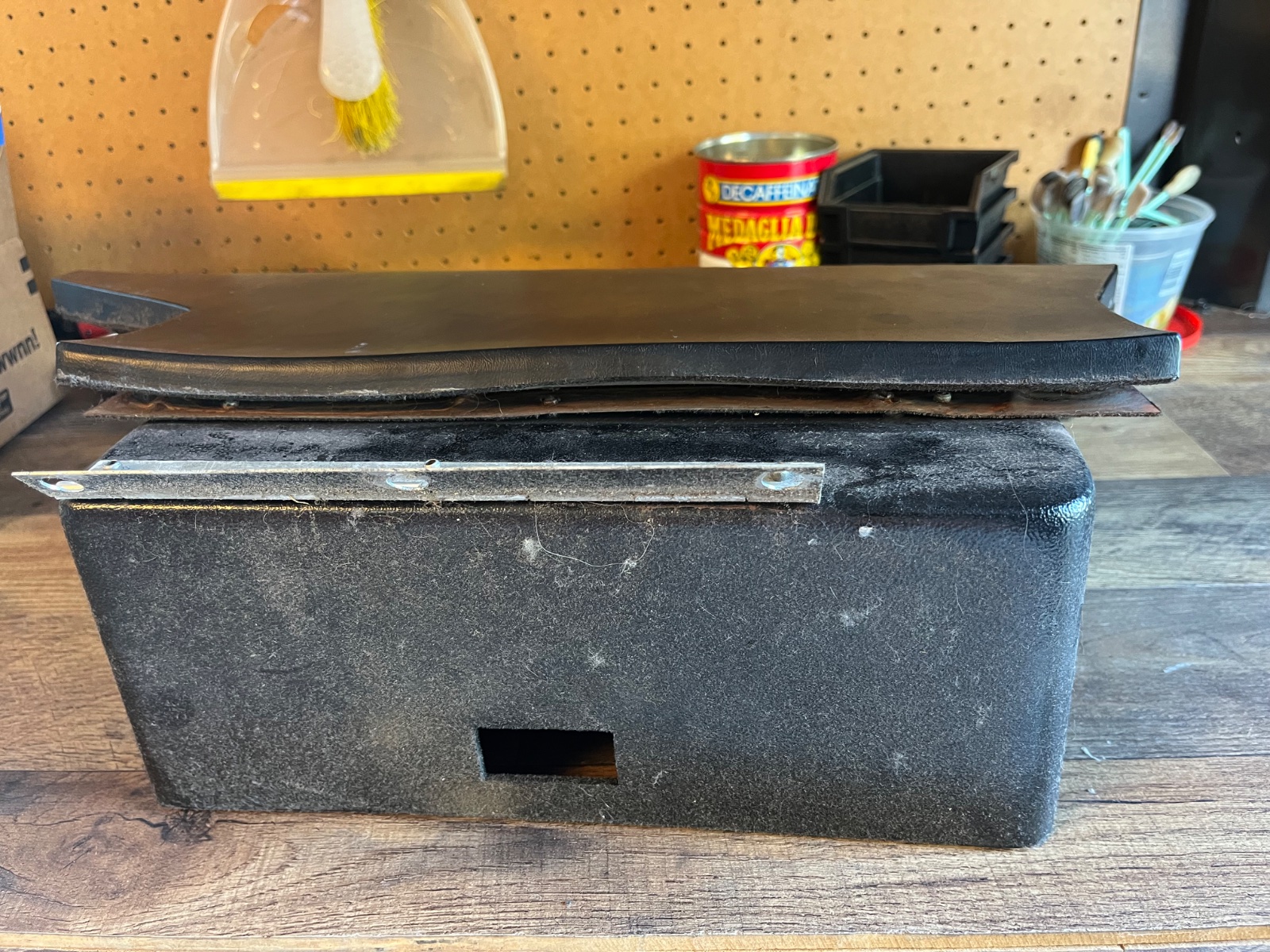

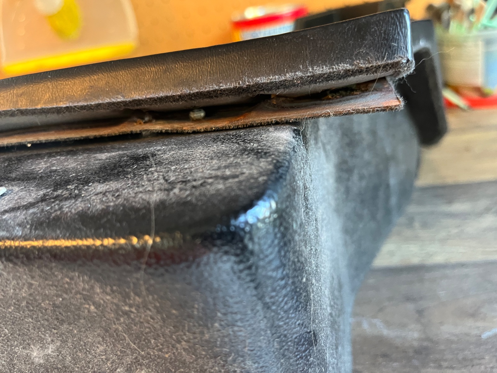

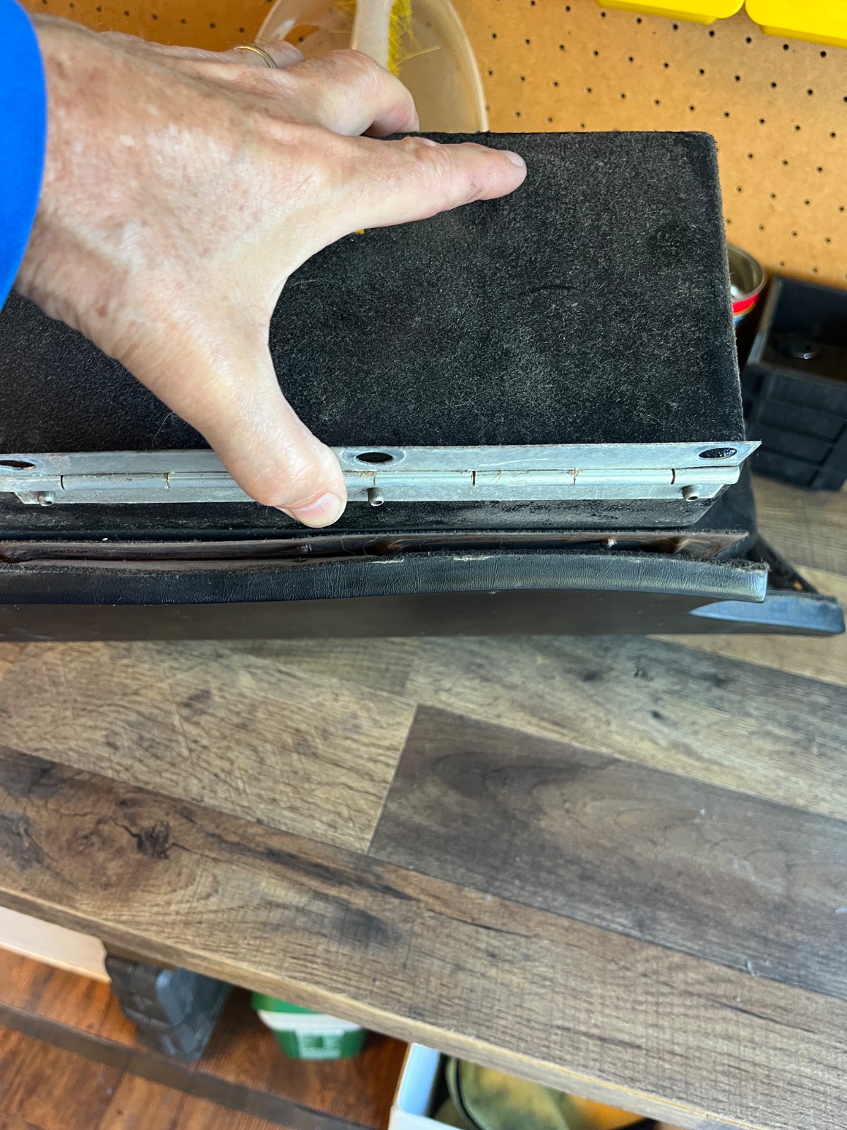

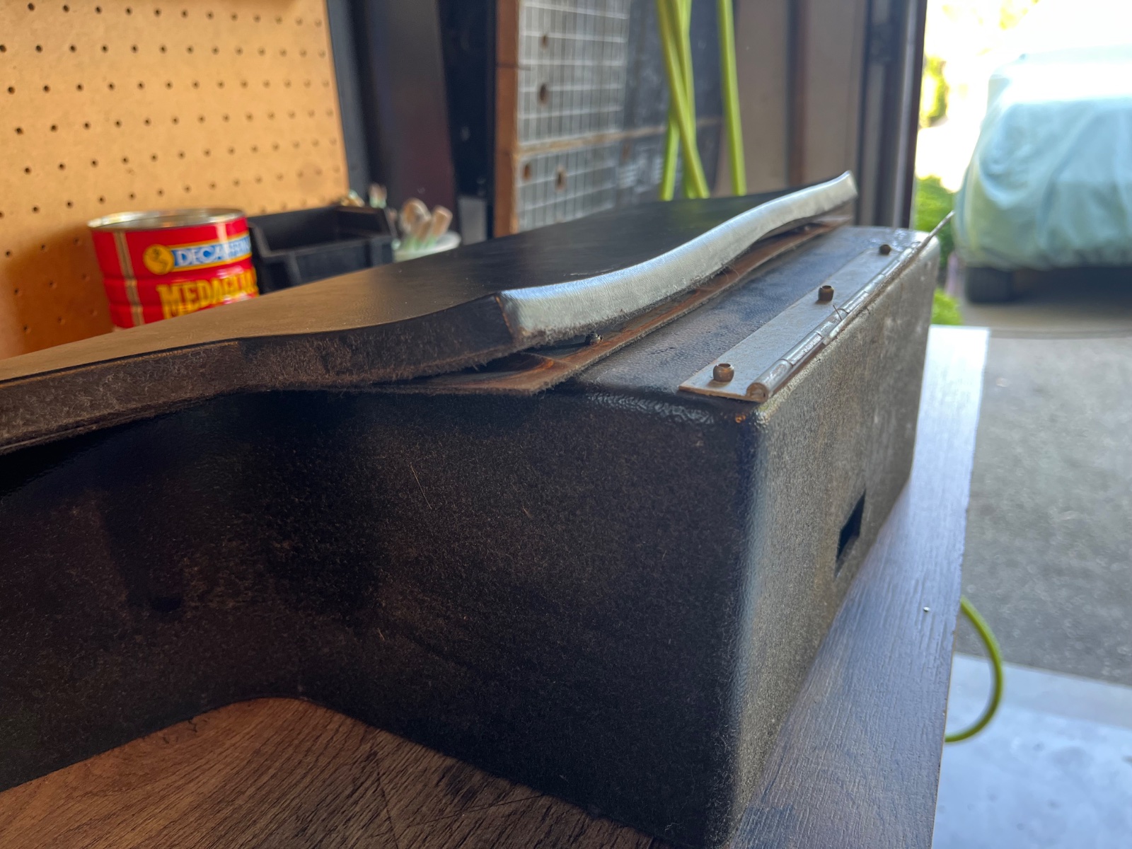

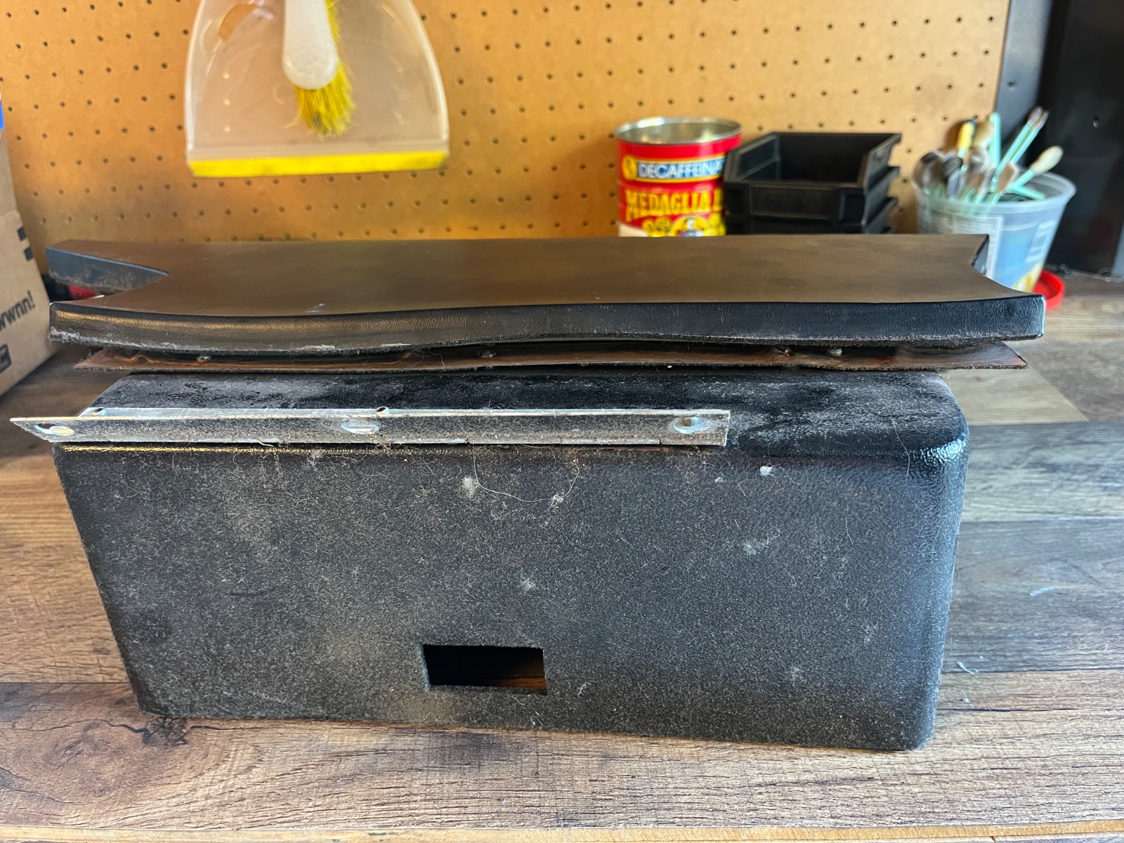

Took out glove box to re-flock it. Before do that I would like to fix the bottom. See pictures. Recommendations for glue? Also any updated recommendations for flock?
I followed this thread but wanted to know if any udated sources

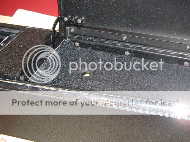

The glue used for the E36 glove box repair is here:
I stuck with old faithful, JB Weld. I would heat the box up to 175 F then clamp for a few hours then glue. Use blocks of wood to clamp down on so the clamp itself does not leave an imprint. The retraction off the metal substrate was due to shrinkage so the heat will allow it to stretch before gluing. May be overkill but mine was retracted like 4 inches off the metal substrate so I had no choice.
