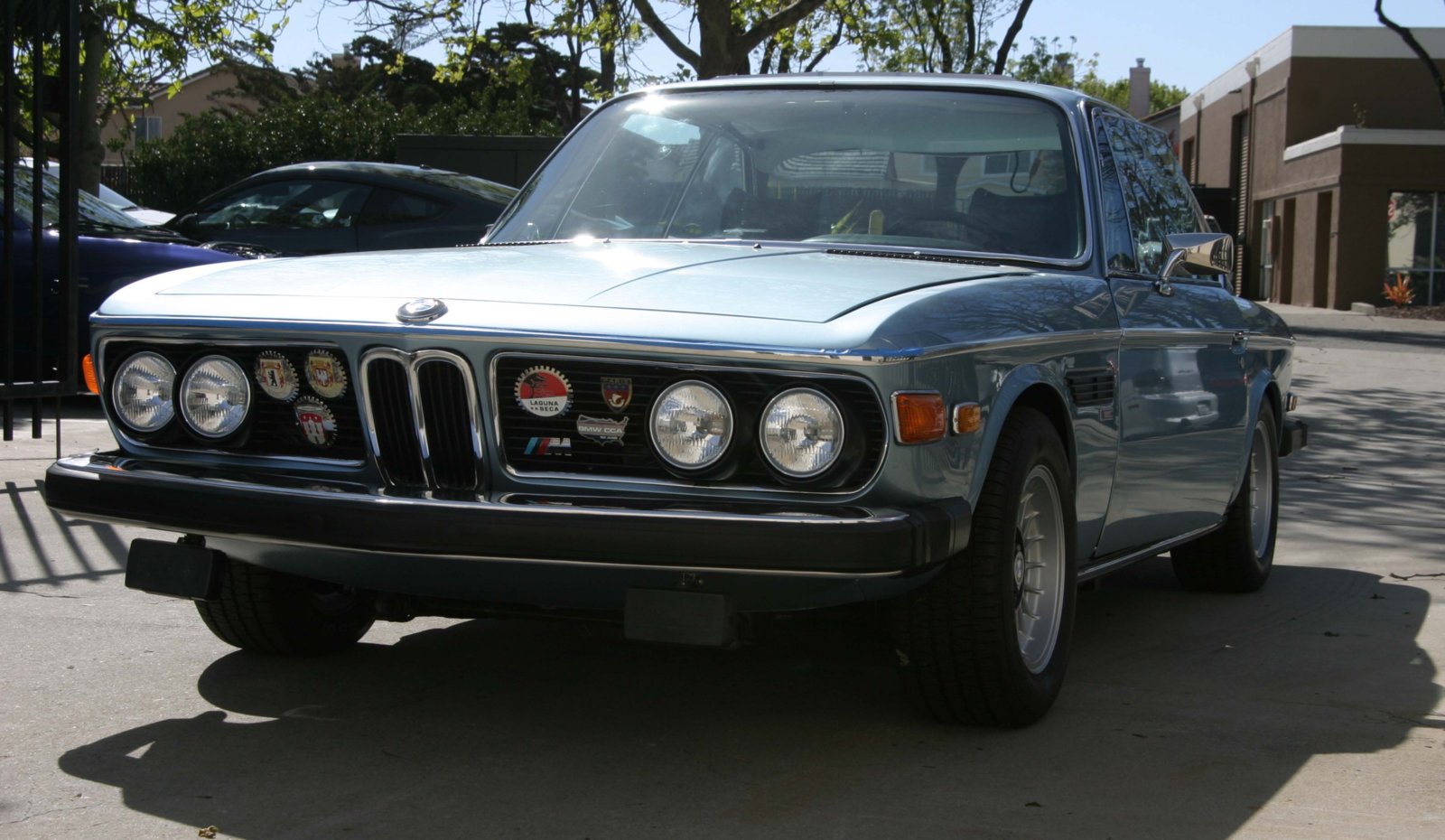

I assume you have the euro headlights (Hella or Cibie) and not the sealed beams. My Hellas illuminate the road better and brighter than the more modern cars I have. It helped to use Terri's gadget for leveling and aligning them, and also found that the bulb color choices matter, at least for Sylvania.

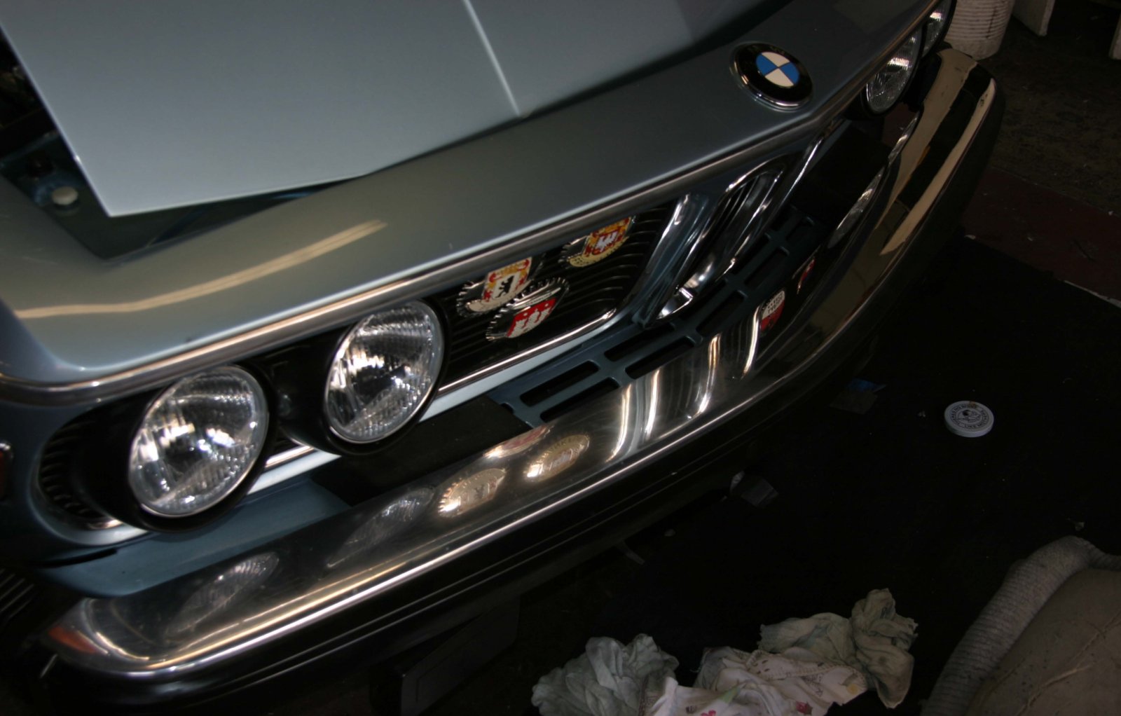

Direct wire from battery to relay to bulbs.
Osram/Philips H1 55w precision-focus, ultra
high luminance bulbs

all h1's
adapt mount to fit notches
thay are dead flat
look the cleanest
put 100 watt bulbs

I fitted Cibie CSR lights, which are stock looking 5 3/4" lights, but with 21st century reflector optics inside. There's no shield for the bulb so the beam pattern and cut-off is all done by the reflector, means all of the light from the bulb comes out the lens
Plus lo beam relays and 6mm wiring direct from battery
I often go for a late evening blast, as the roads are quieter. Helps to be able to see....

yep ... the rewiring to get power direct to the lights without going through the light switch is a great modification. that will get you the correct voltage at the light. this has been discussed in other threads that you want to use the H1 low beam lamps and high beam lamps ... just different optics. the H4 low beams aren't that good
