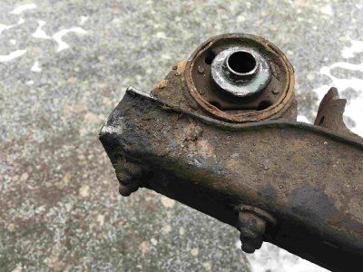

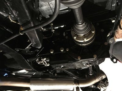

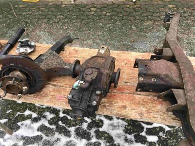

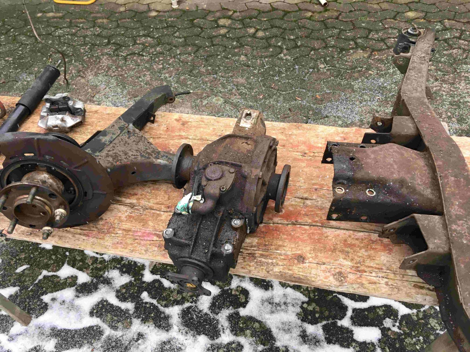

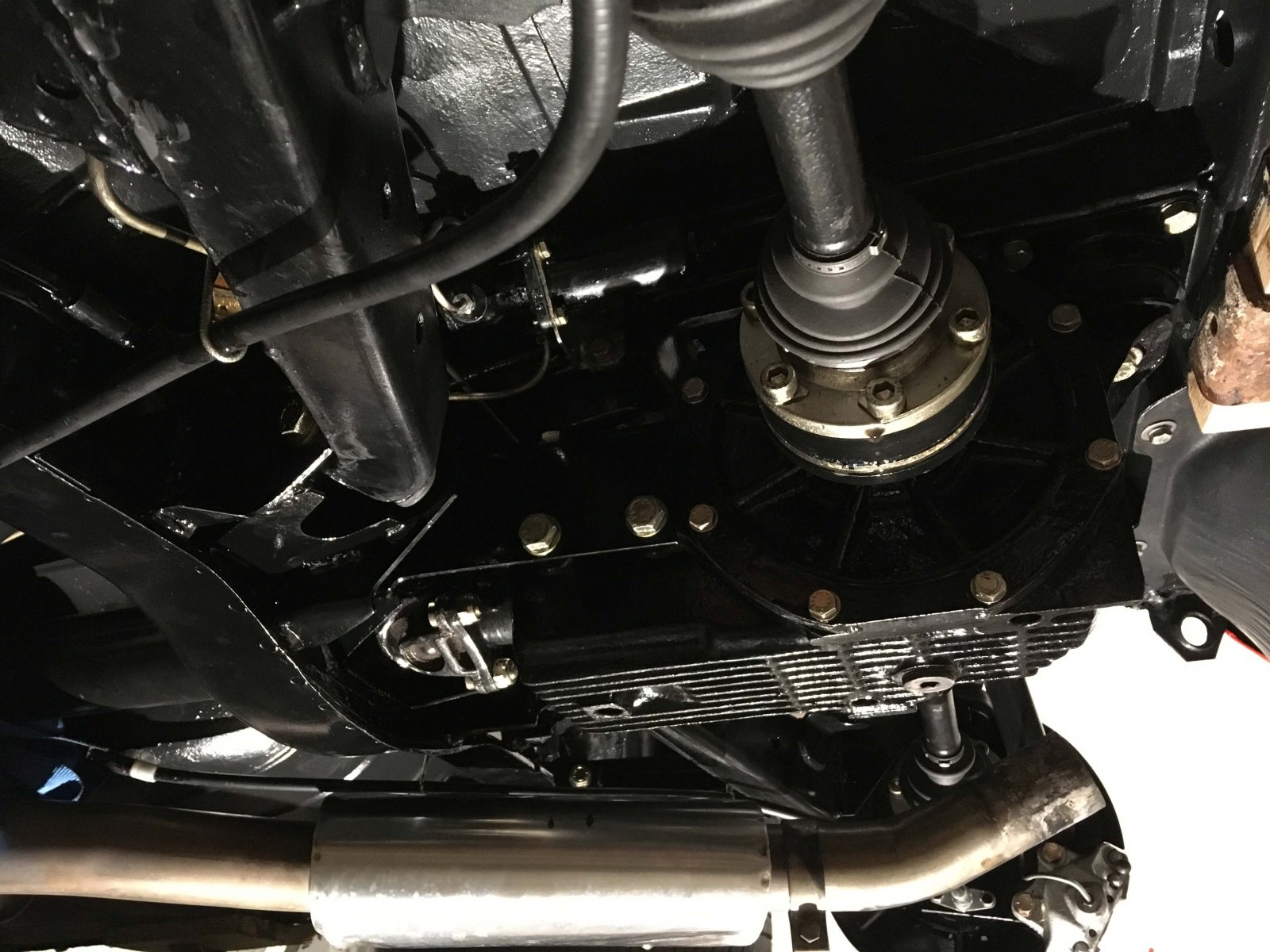

The solution of Eric is really fine. I made an add. support to the frame behind the rear axle drive.
I removed the complete rear "axis" incl subframe.

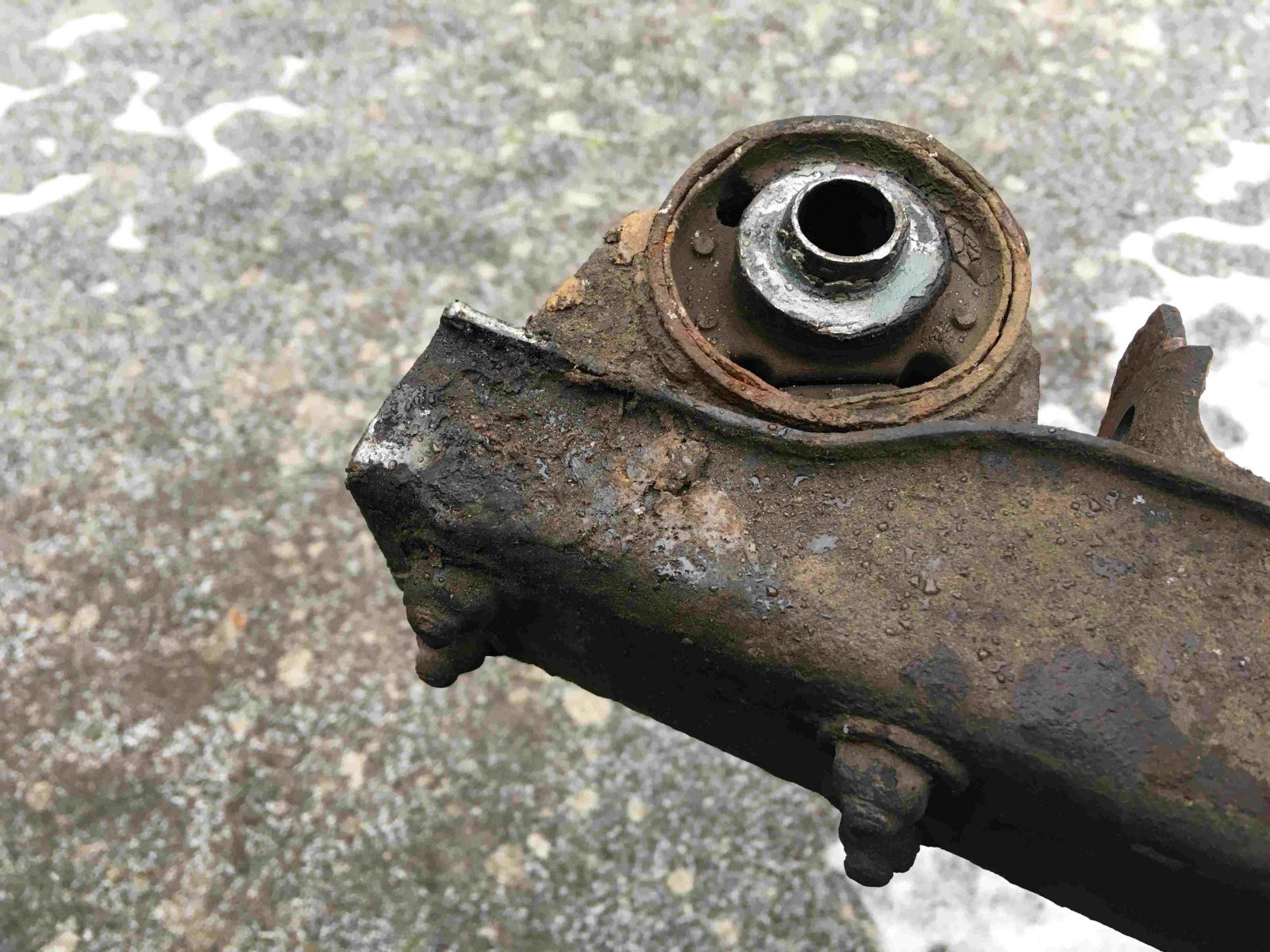

I found rust (not detected before), aged seals (rear axle drive), missing grease in output shaft, rubber mounting (name?; see picture) in a really bad condition,....
Be aware, that the screws od "rubber mounting" /2nd picture/ are 10.9 and not onl 8.8
It was as at every time before: After more than 40 years every part needs a specific support and a lot of love......
