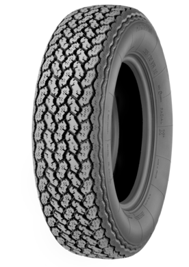

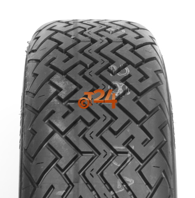

The profiles are really different….. they both look period correct but the Pirelli‘s look ultra cool! View attachment 133335View attachment 133336
They definitely do. Lot of the early 911 guys around here will run the Pirelli or Avons which are super sticky but wear out quickly but these cars don't get miles piled on so they likely time out before they wear out anyway...

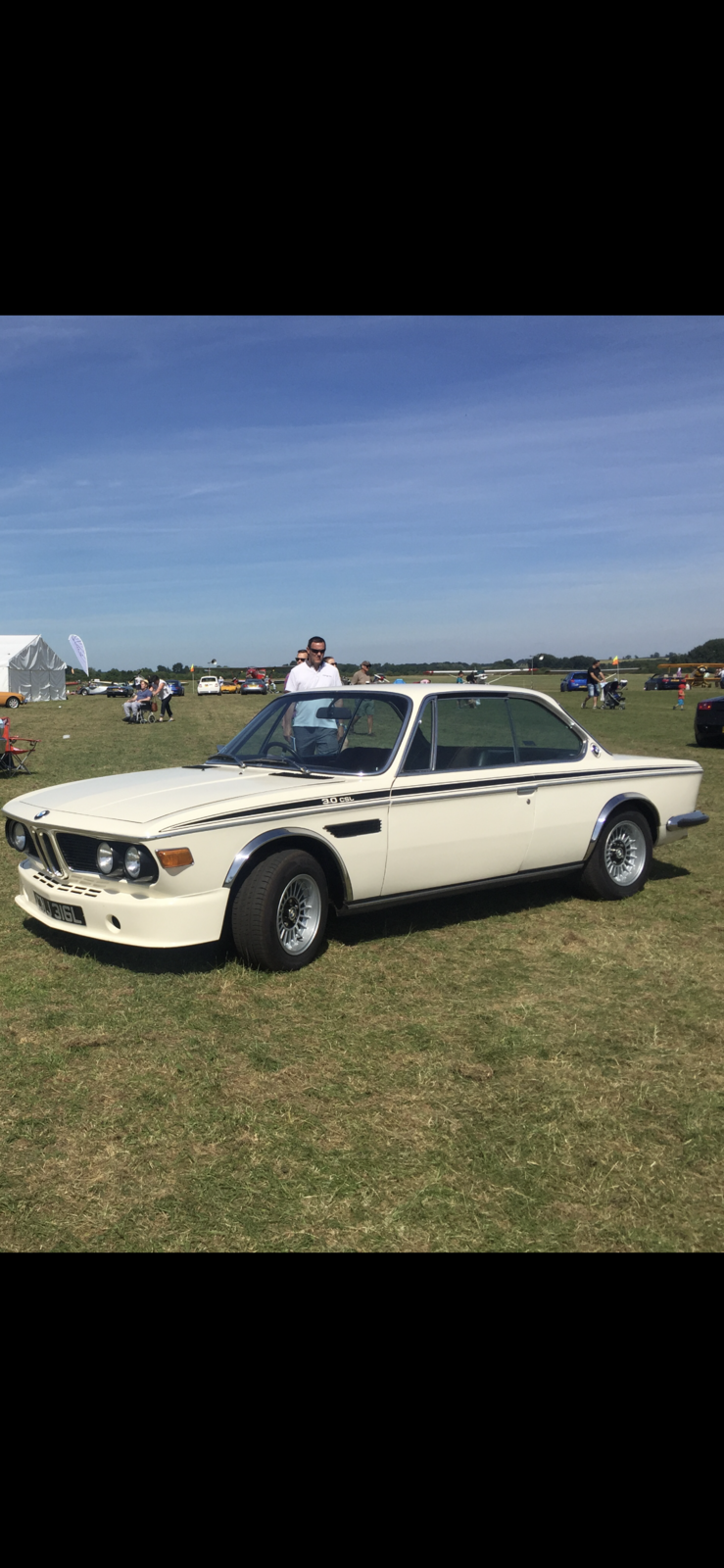

These are the 16” Alpina staggered wheels. Front are 7” with 205/55/16, rear are 8” with 225/50/16

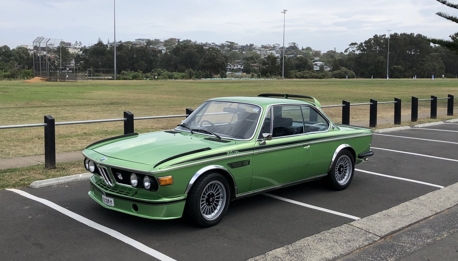

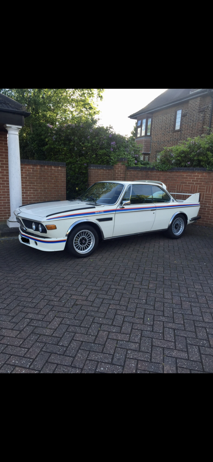

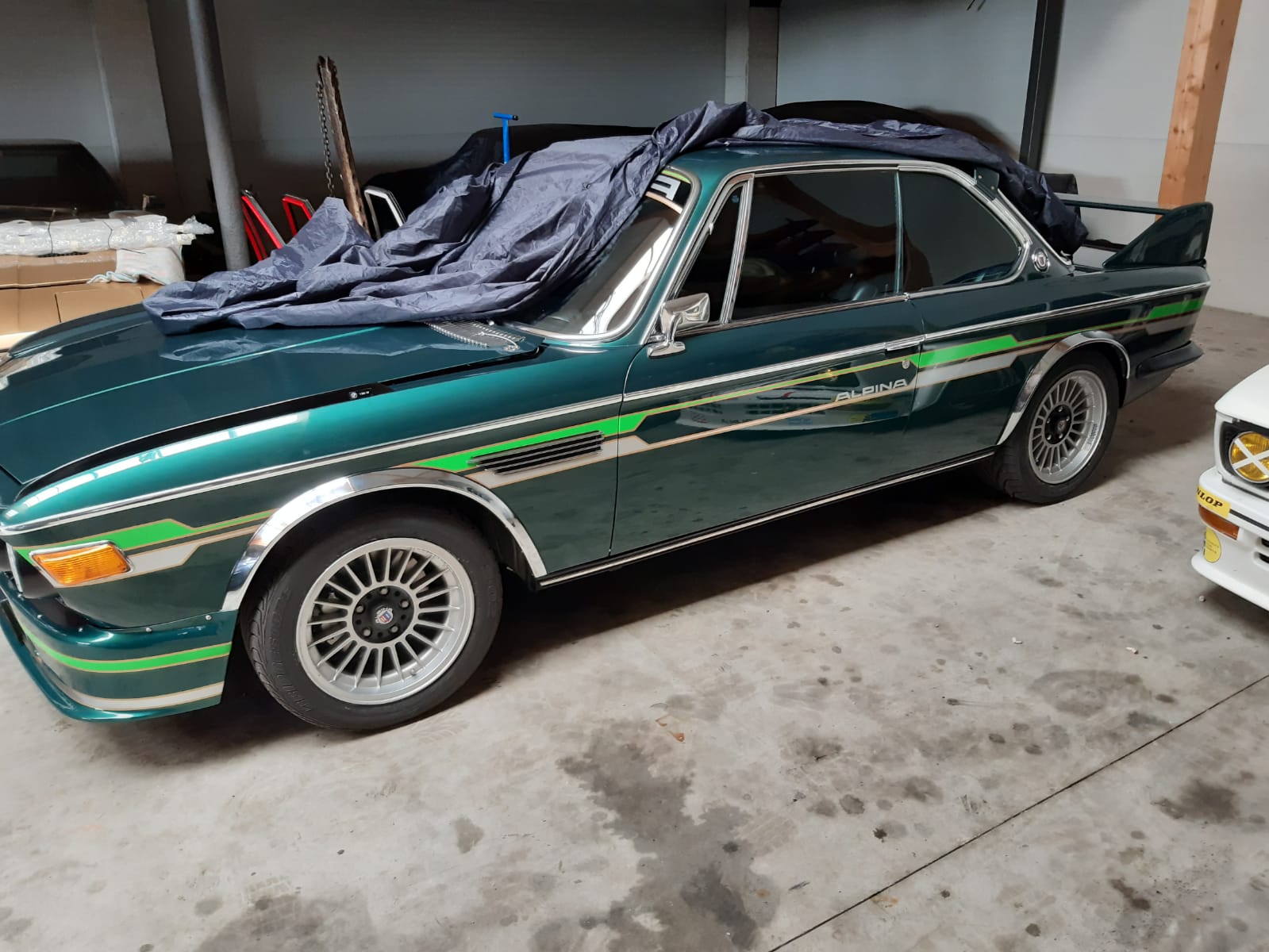

I run the 16" staggered set up, as I think they look great. I don't have rolled fenders or camber plates. I do have very slight glancing of the tyres but only would happen with aggressive driving or flying over speed bumps. I have decided to live with it without camber plates or rolling fenders, because one day I might put back my 14" original CSL rims.
Furthermore, it has been suggested by some to roll the fenders when going for a 16" set up, however I don't believe it is plausible to roll both the fenders and the silver trim arch on a CSL as the trim would distort. (Would love to know if anyone has actually done this).
