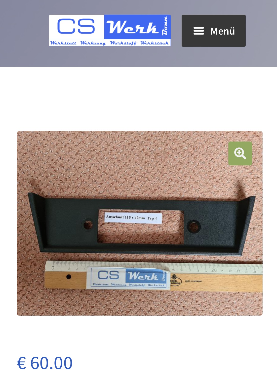

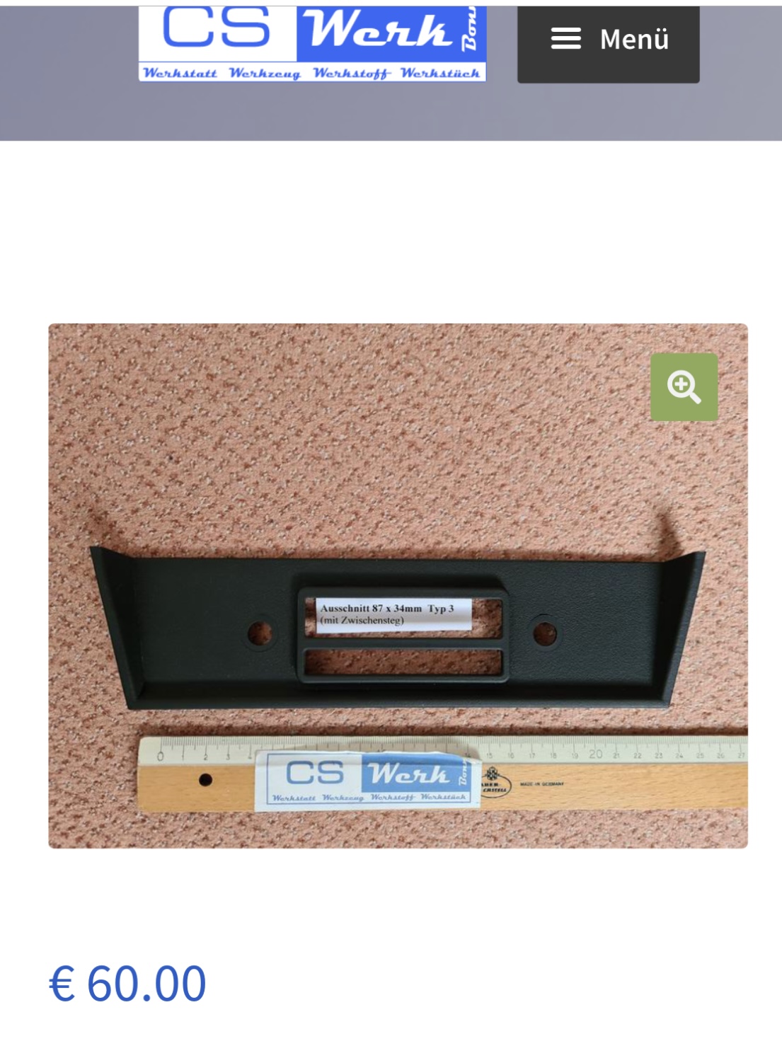

CS Werk is selling kits for radio installation.
As you may see it is "just" a sheet metal bent, so nothing which cannot be done at home or local shop.

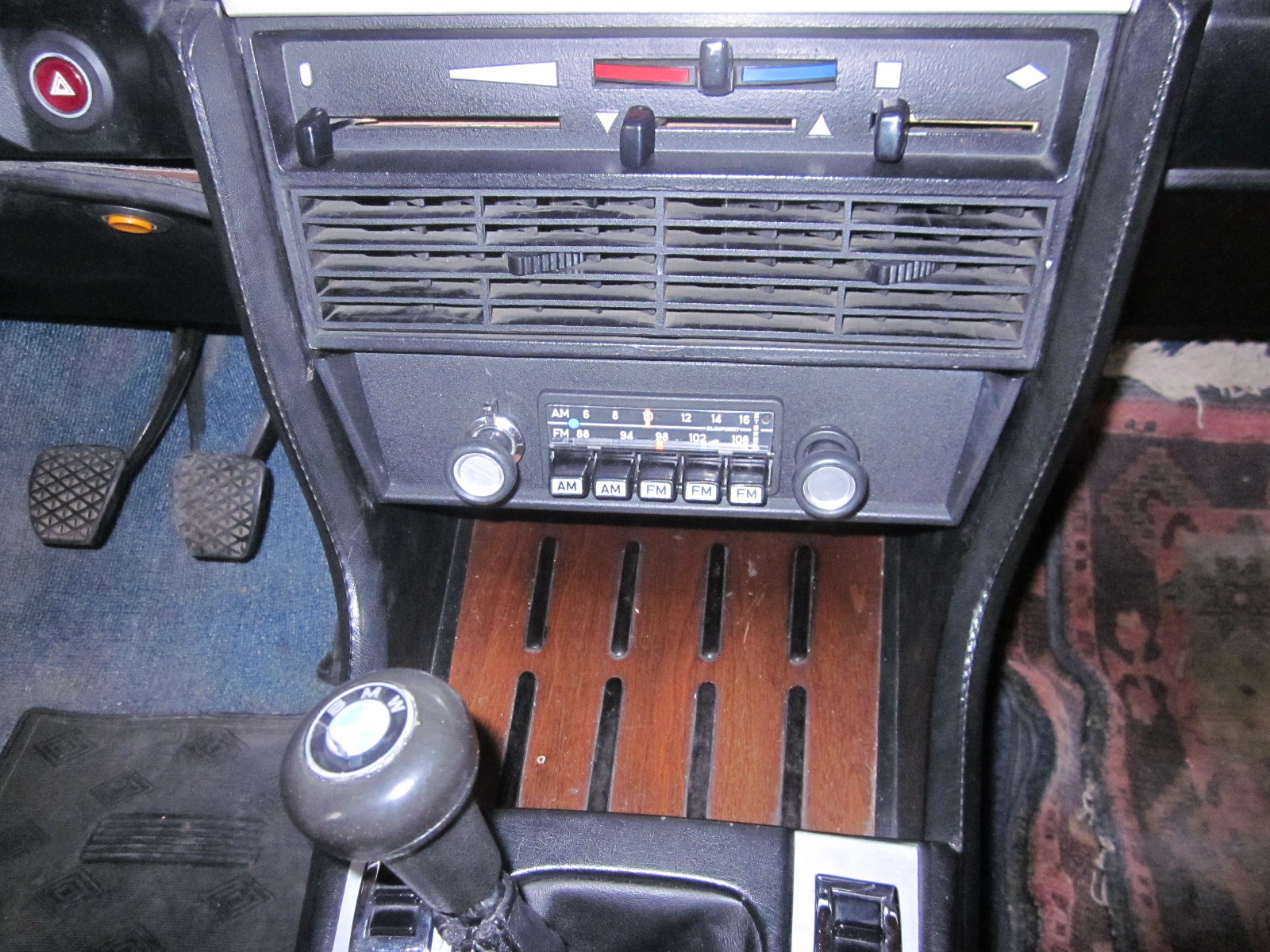

Best to buy Christof's & be done. Even with the correct radio bracket, while it looks simple, without the correct tools with be much more difficult. Highly recommend buying a small 90° ratcheting driver set.

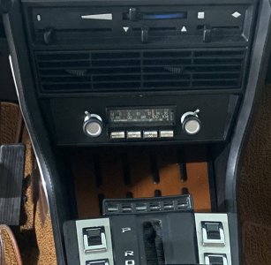

View attachment 174723View attachment 174724
Thanks for the suggestion on the tools. The top photo looks like my radio. So I am sure it will go into the dash as expected. Are there any other photos of the top radio as it was installed?

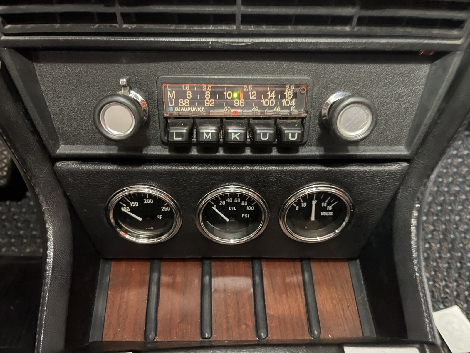

Unfortunately I do not have any other radio photos nor any measurements as the tapered plastic faceplate is designed to fit directly below the air vents. The first photo is back in 2011 when I purchased the U.S. AM/ FM Frankfurt radio, faceplate & bracket from a forum guy in the U.K.
Several years ago, the U.S. Franfurt one day stopped working completely. I bought a European Frankfurt LMKU from Enoz on here.
Soon after that, I added the Oil Temperature, Oil Pressure & Voltmeter. Also purchase an Bluetooth Out of Sight Audio Mark 2 module mounted to the rear of the center console behind the radio & auxiliary gauges. outofsightaudio.com.

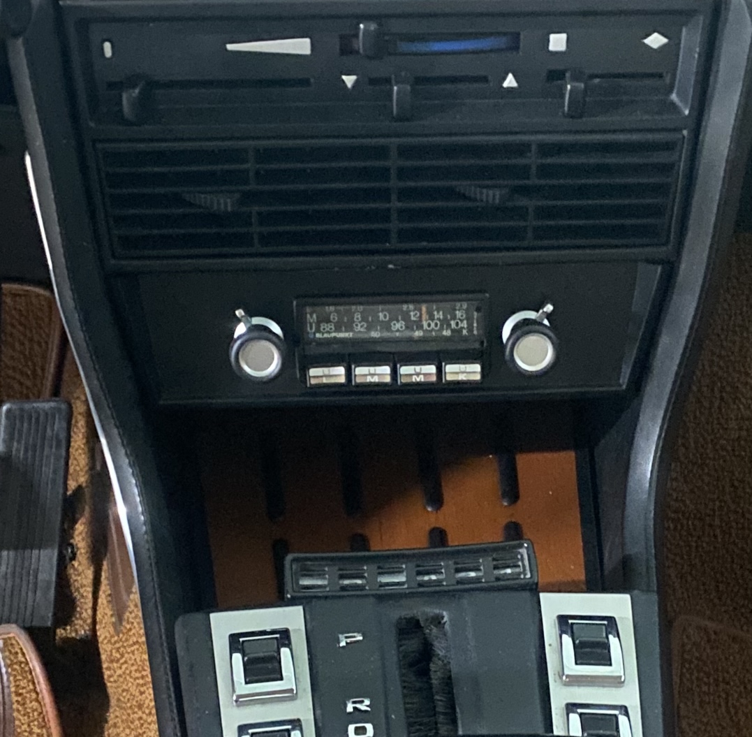

My radio has a larger middle face with its own cover. I had to remove the cover to have it fit in the opening. This caused a gap between the push buttons and dial, that I covered with a piece of foam for now.
I should have asked Christoph to send me one with larger opening without the raised edges or one with the middle bar. The third picture is ideal for my radio. I will once back in Europe.
