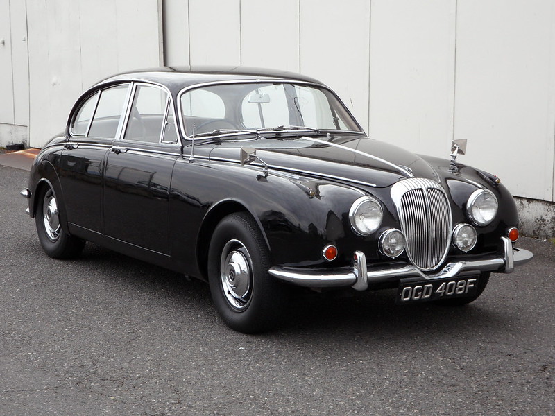

The quirkiest car I've owned was a 1967 Daimler V8 250. Essentially a Mk II Jag with the beautiful little 2.5 liter Daimler hemi head V8 and a 4 speed with OD.
It was delivered new in Scotland so was RHD. The RHD caused me no problems driving it here and it added a lot to the quirkiness of the car. The turn signal was on the left side of the steering column like is normal today. The right side lever operated the Lacock od.
