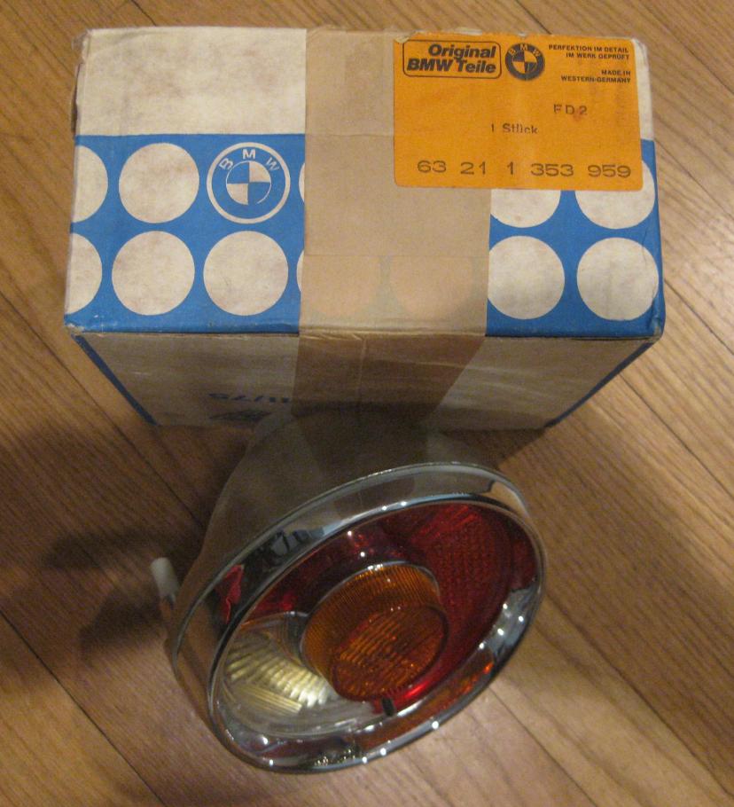

I know this is an E9 forum but I also know many E9 owners either currently own or have owned 2002s and might be able to help me out. I have a pair of NOS BMW 2002 round complete tail lights and my issue is the part numbers that are on the original box just don't seem to match or exist anywhere on the internet or the RealOem site. The tail lights were produced in 1979 and have Made in West Germany on the boxes. The part numbers for the tail lights are 63 21 1 353 959 and 63 21 1 353 960. Below is a photo of one of them.

Have to dig through the old parts books for this number...
Listed as taillight assemblies for pre-'74 '02s (non-touring), but "special equipment European regulation" parts. What that means exactly, I'm not sure, but the lens and reflector carry different part numbers from the standard part. The top of the reverse light lens looks a little different from a standard taillight, from what I can make out in that picture.

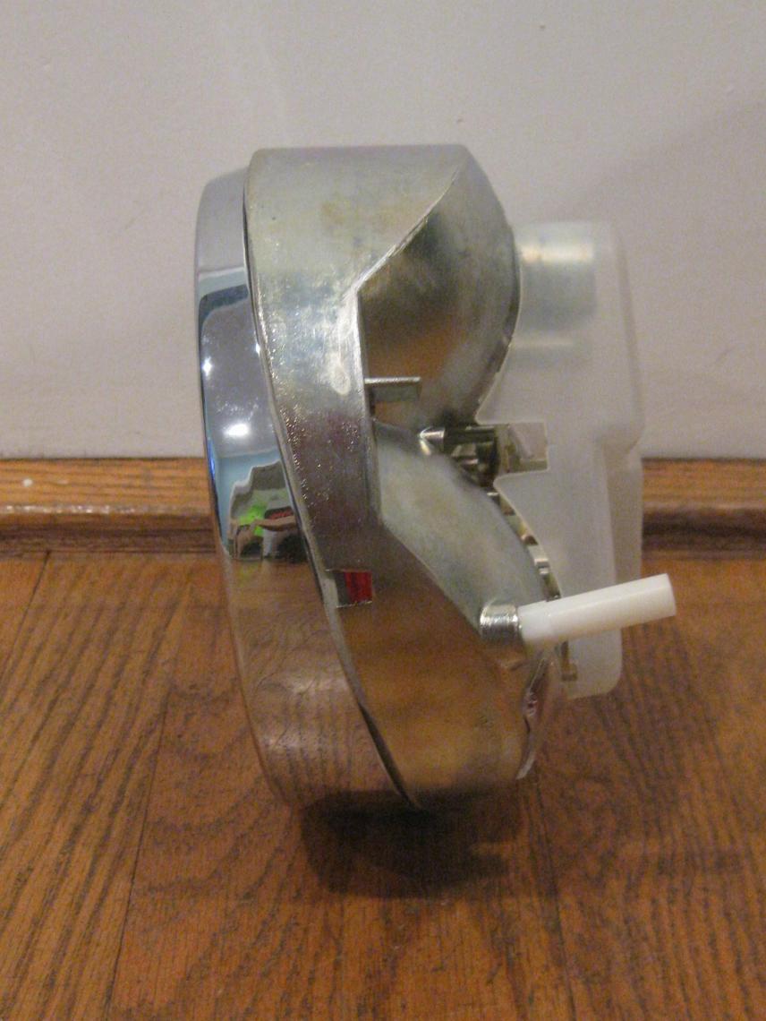

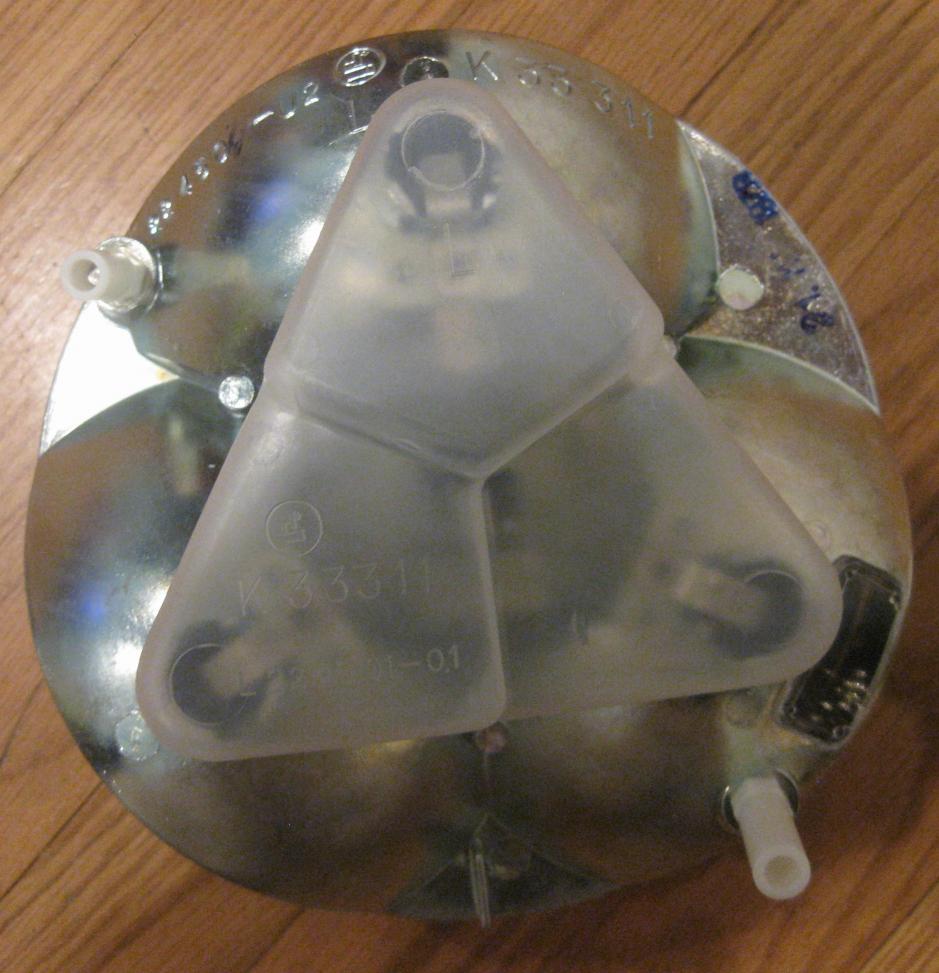

More Photos Added
Below are a couple of photos including a side profile. Hopefully these photos help.

Touring? BMW 1600GT? 3200CS? Looks to have a contoured rear face.

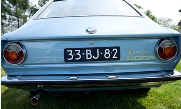

on another note, i think Chris is the winner - i found a rear pic of a 2002 touring on ebay

Yes they are 02 tail lights according to my paper Teilekatalog.
63 21 1 353 959 Rear light kpl. Left
63 21 1 353 960 Rear light kpl. Right
For Europe up to Modell 73
1602/1600-2 Ti/1600-2 Cab./1802/2002/2002 Cab./2002 A/2002 Ti/2002 Tii
