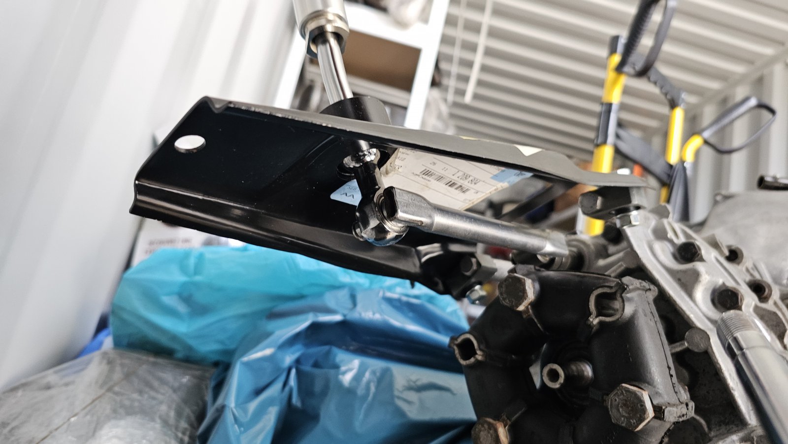

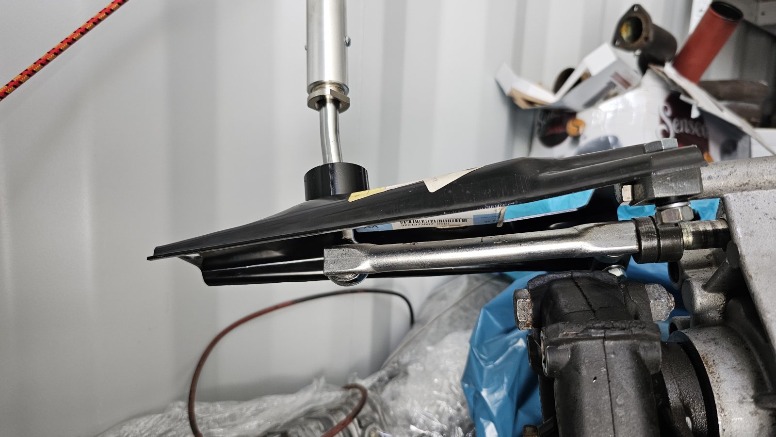

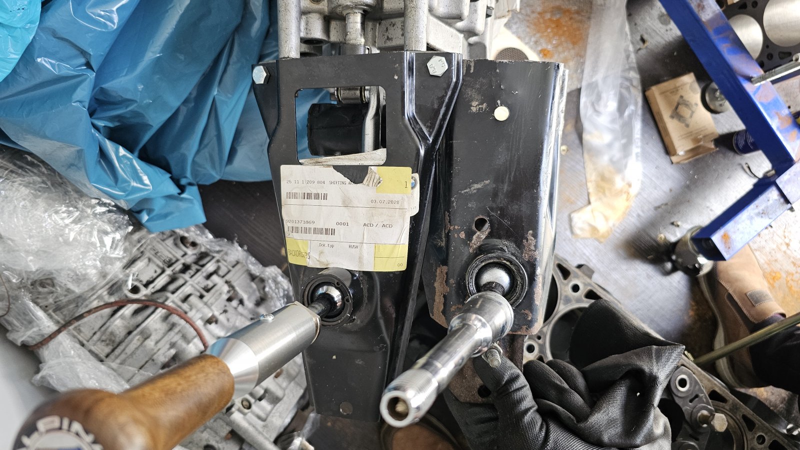

Have anyone used 5 speed shift plate from E23 in E9 before? I think this is an early version. Perhaps it is too wide? The car is far away so I am not able to test
Is the length correct for the placement of the lever?
It is placed a tad further back than the other shift plate (the correct one). I am making an adjustable rod, but I'm not sure if it is worth the effort if the lever ends up too far back. What is the size of the hole in the body?
