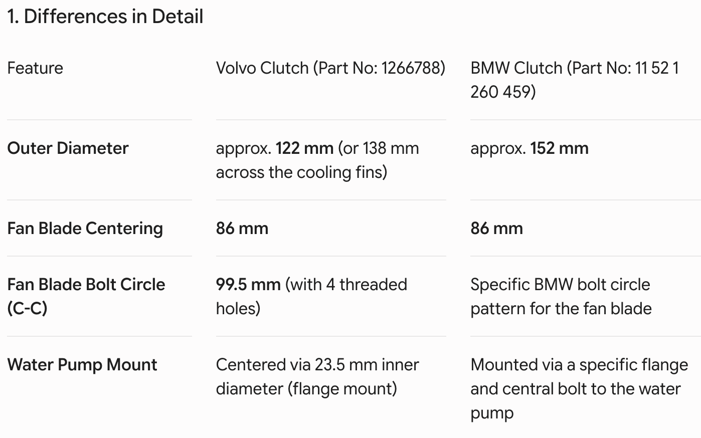

I ran this thru Gemini:
Summary​
While the centering diameter for the fan blade is indeed identical at 86 mm for both clutches, the significantly larger outer diameter of the BMW clutch (152 mm compared to a maximum of 138 mm for the Volvo clutch) and the completely different mounting setup on the water pump prevent them from being interchangeable. Therefore, they are not identical.
Summary​
Thank you for doing this. I don't know how to use AI (Gemini) to get answers like this. I've heard that some answers are unreliable, but in this case it points out pretty verifiable differences.
