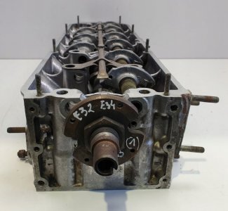

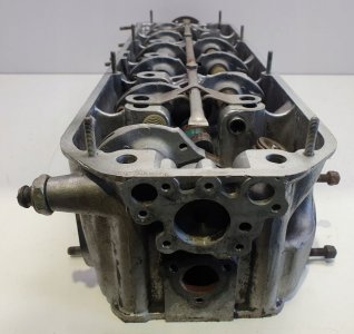

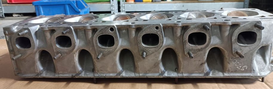

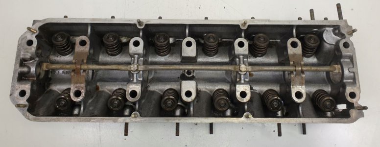

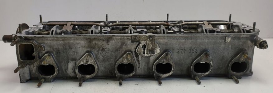

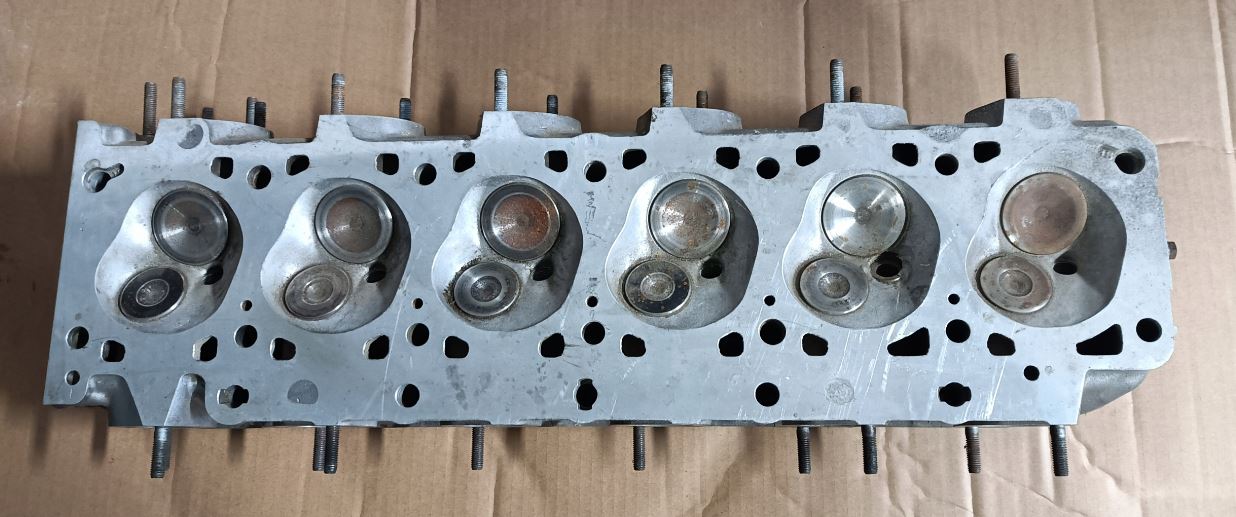

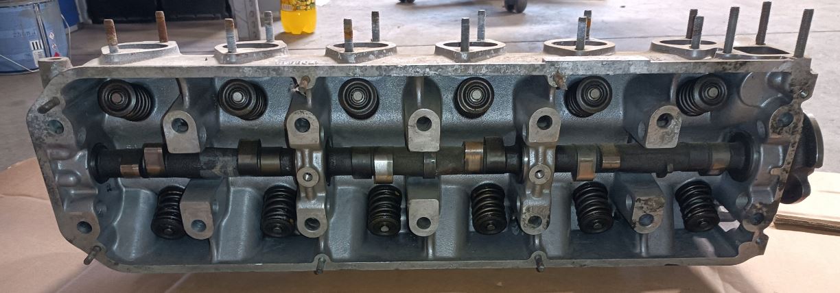

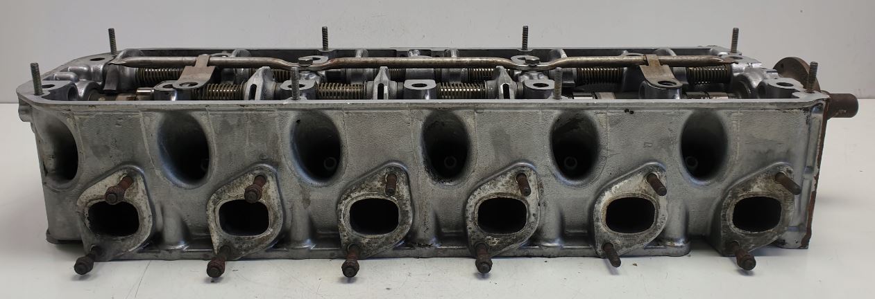

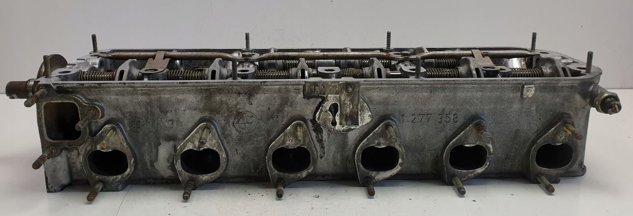

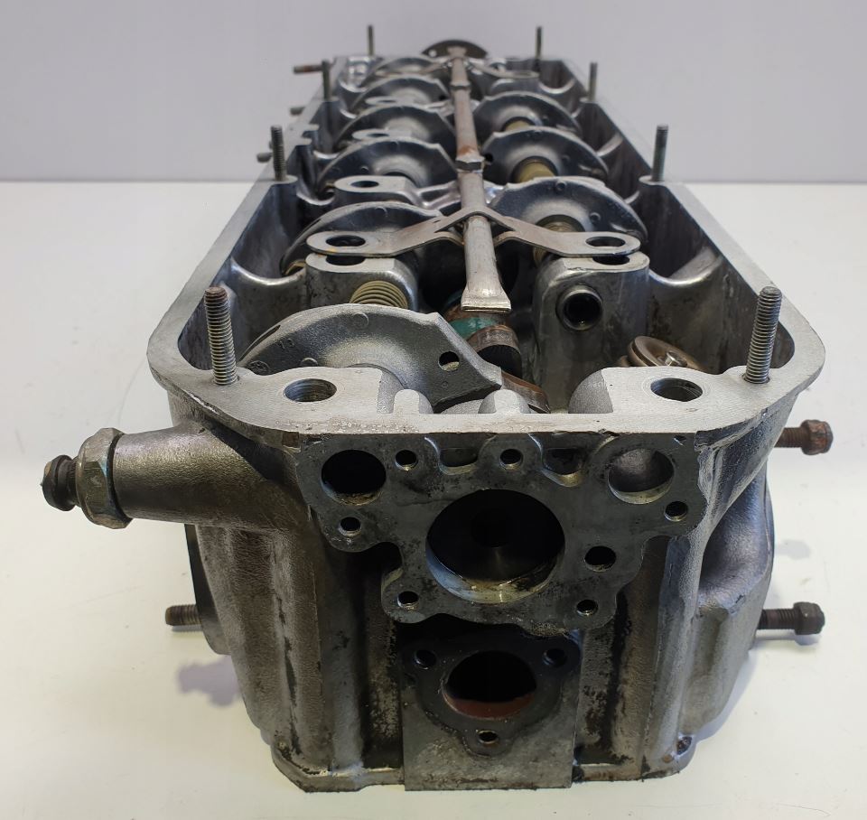

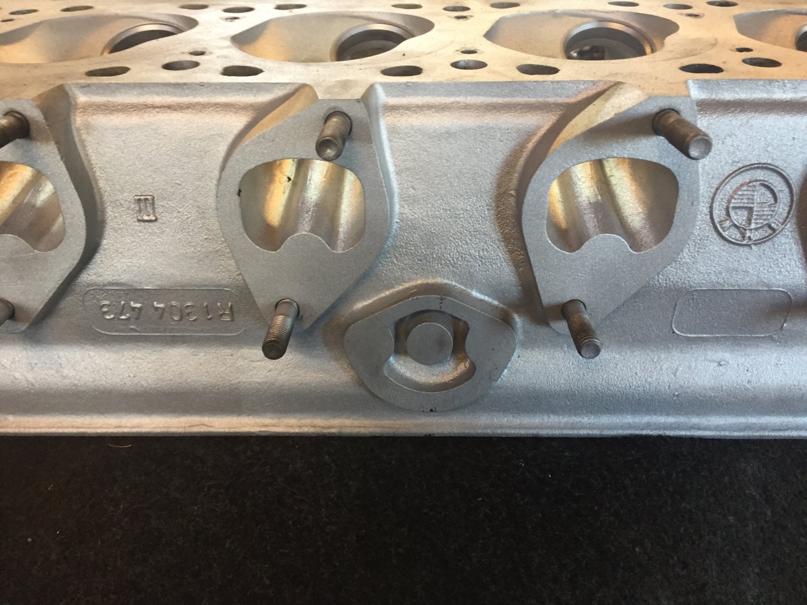

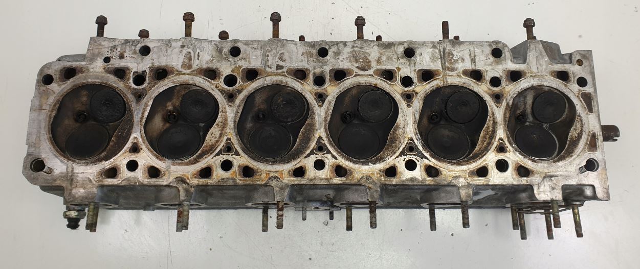

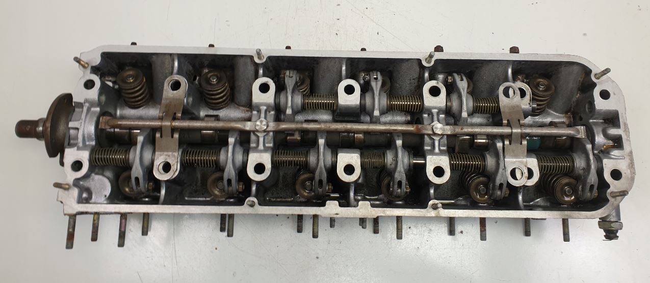

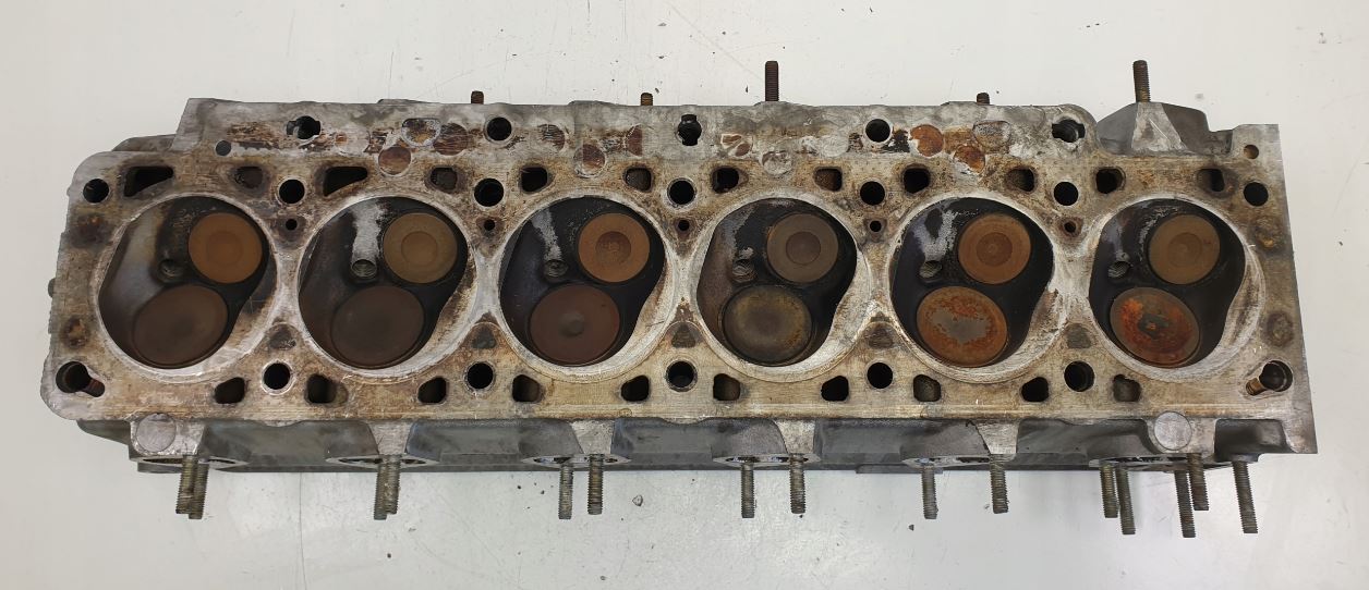

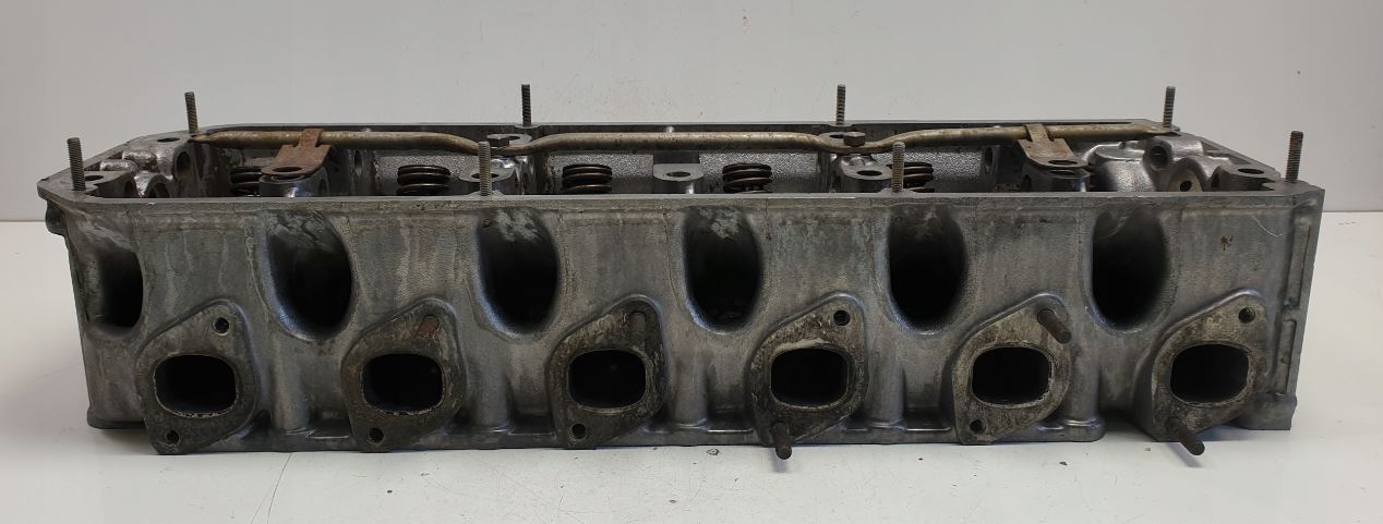

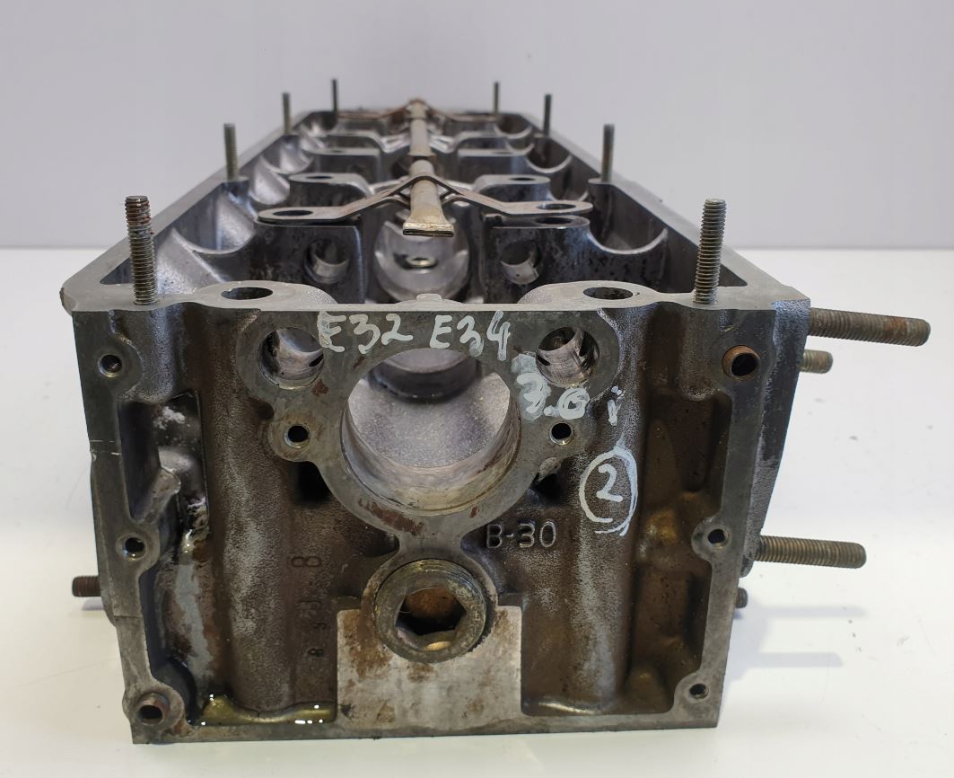

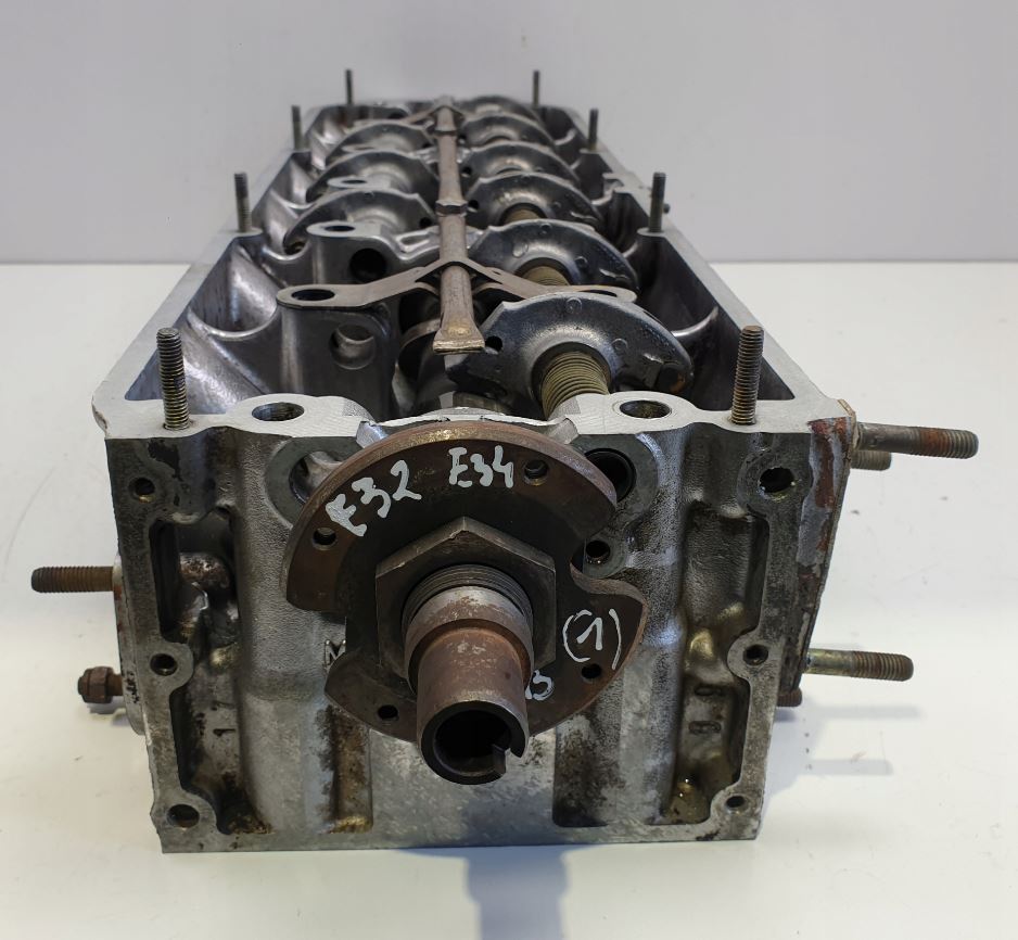

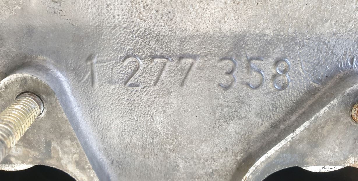

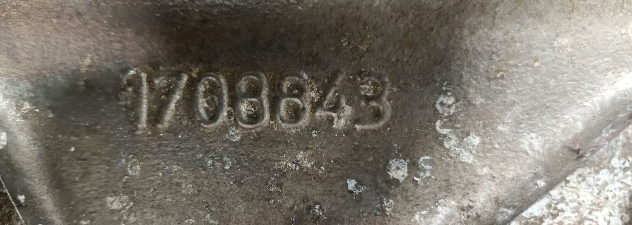

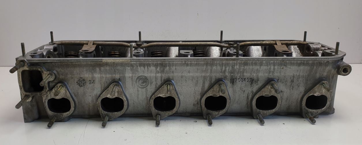

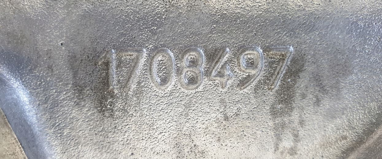

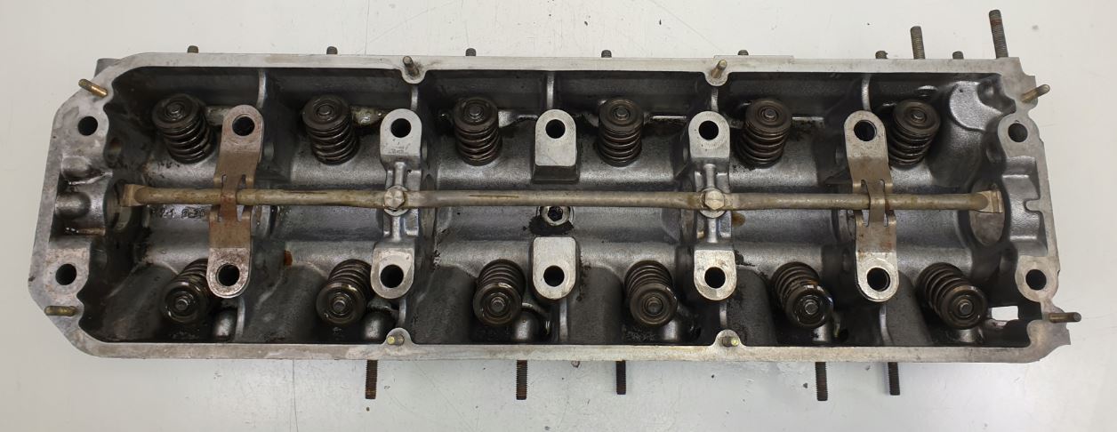

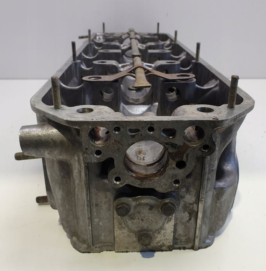

Here are two examples, well pictured:
1. BMW # 1708497
2. BMW # 1277358

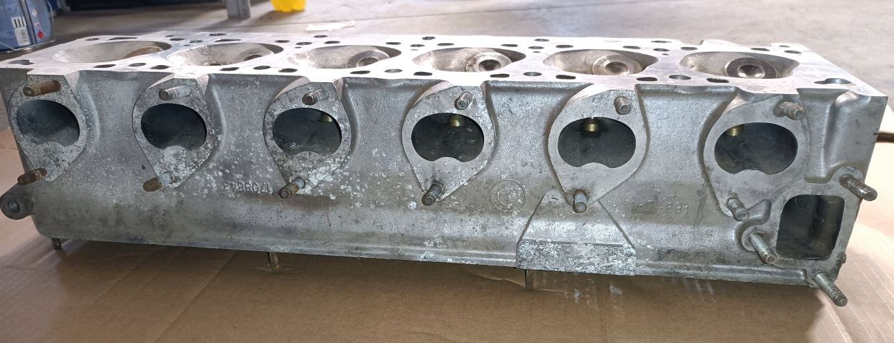

Wow, that library is heads and shoulders above what we had :).

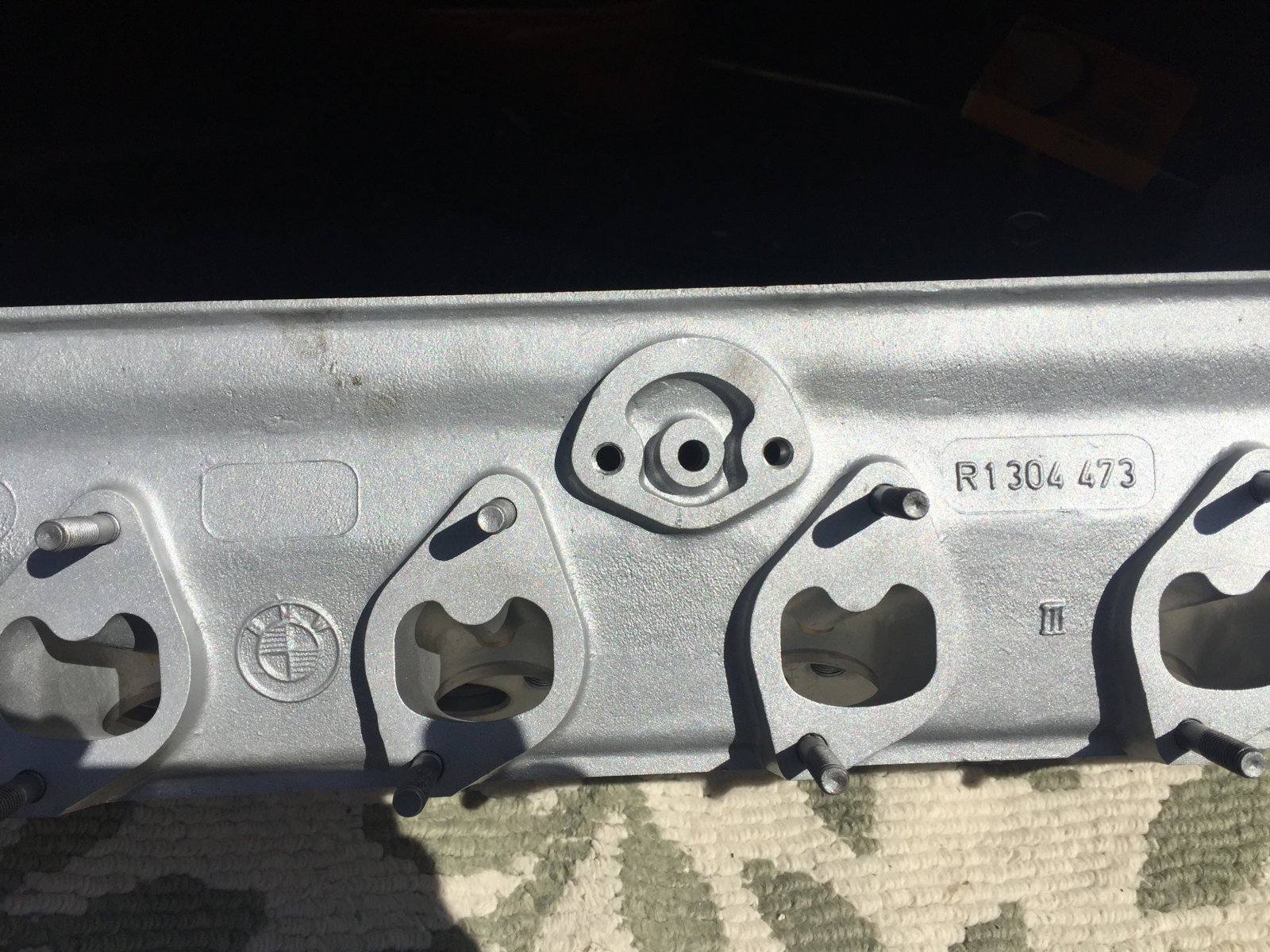

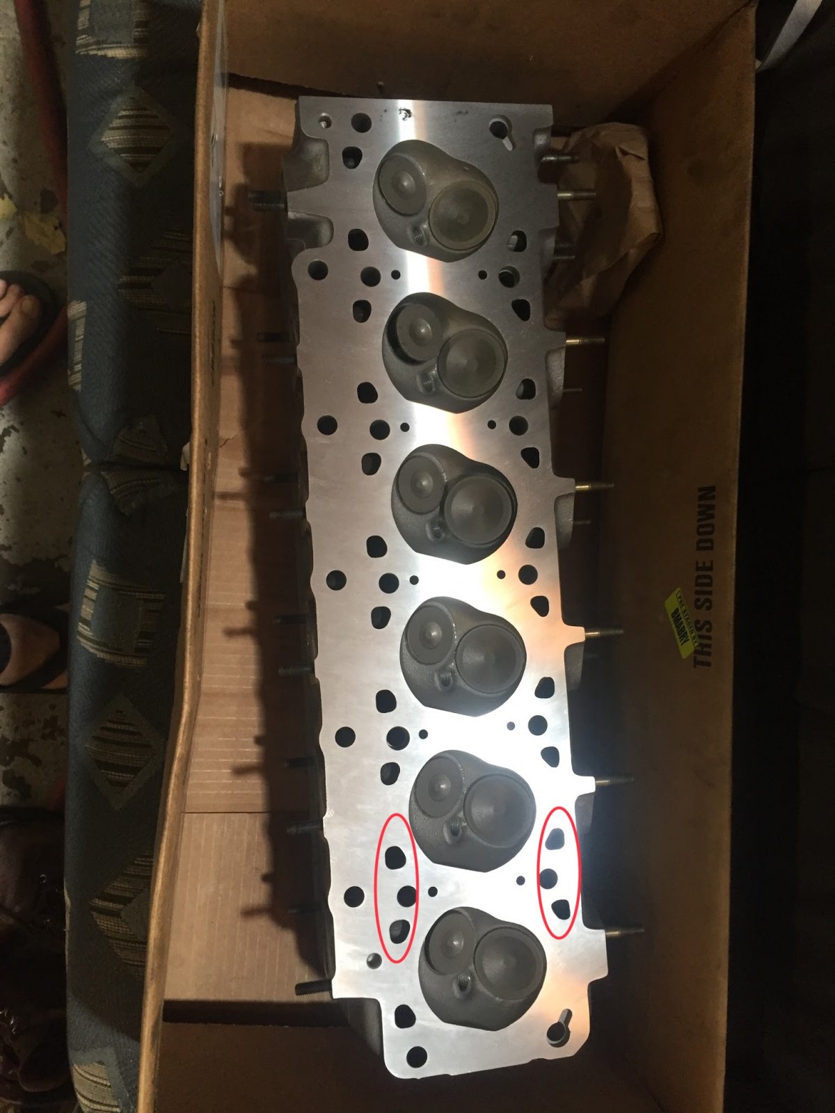

Here is the head I got from SFDon for my E24, and is a DOT-R head.
The E9 head is a also a DOT-R head the PO got as a new short block, but I have no good picture to share.

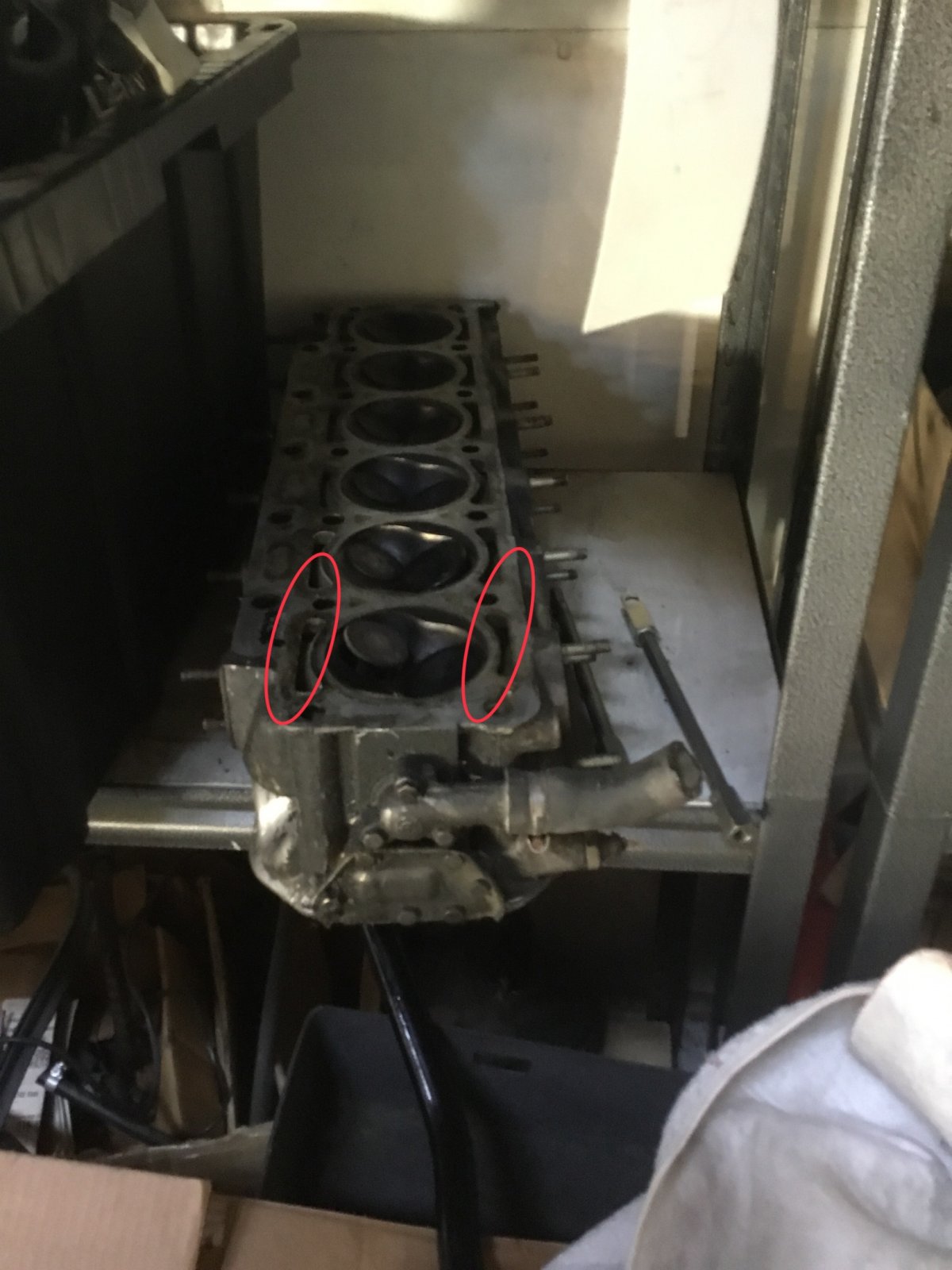

Kris - great idea, but I have a suggestion. It would be helpful if you were to provide an overview of some kind, and to characterize the heads you have pictured in accordance with your overview. For example, I know there are early m30 heads with slots for coolant passages that were not the best, which were often replaced if the owner had overheating problems with later heads. And in addition to the heads found on later M30 engines, there are Spanish made replacement heads. I also know that the b35 heads have a different combustion chamber and larger intake valves. So, with my limited knowledge, I can get to four groups or categories. I'm sure there are more.

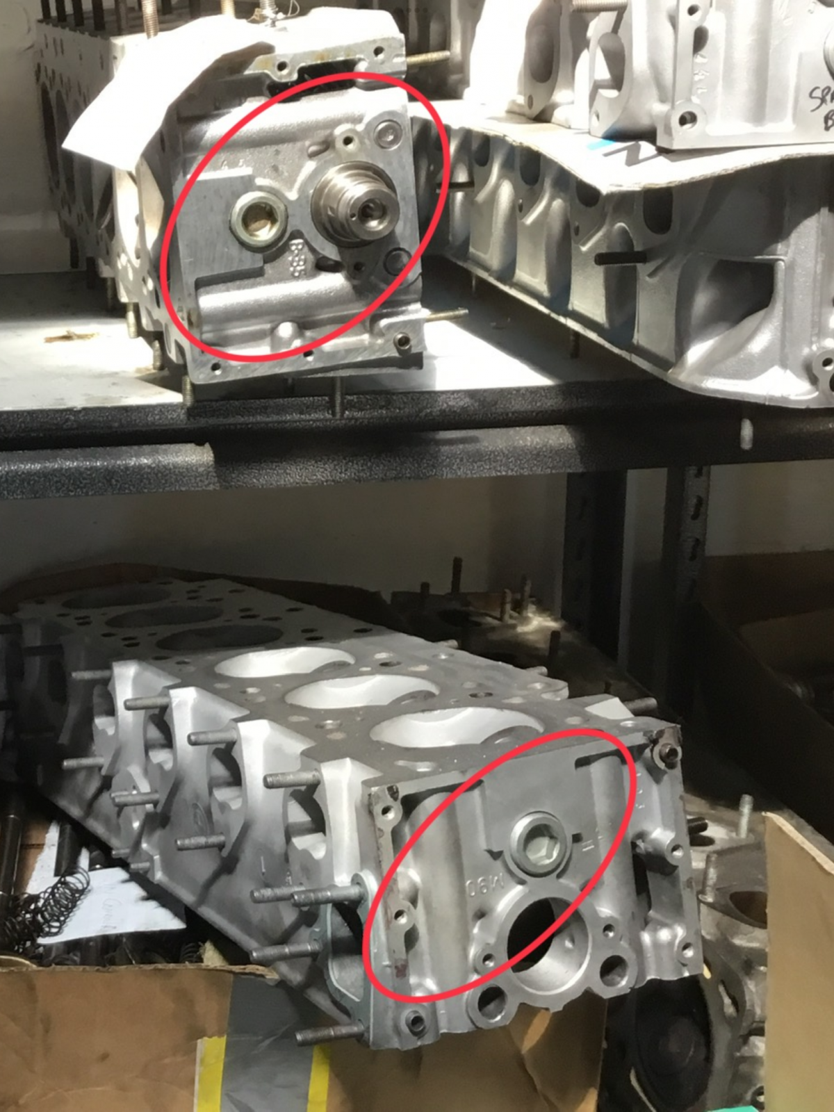

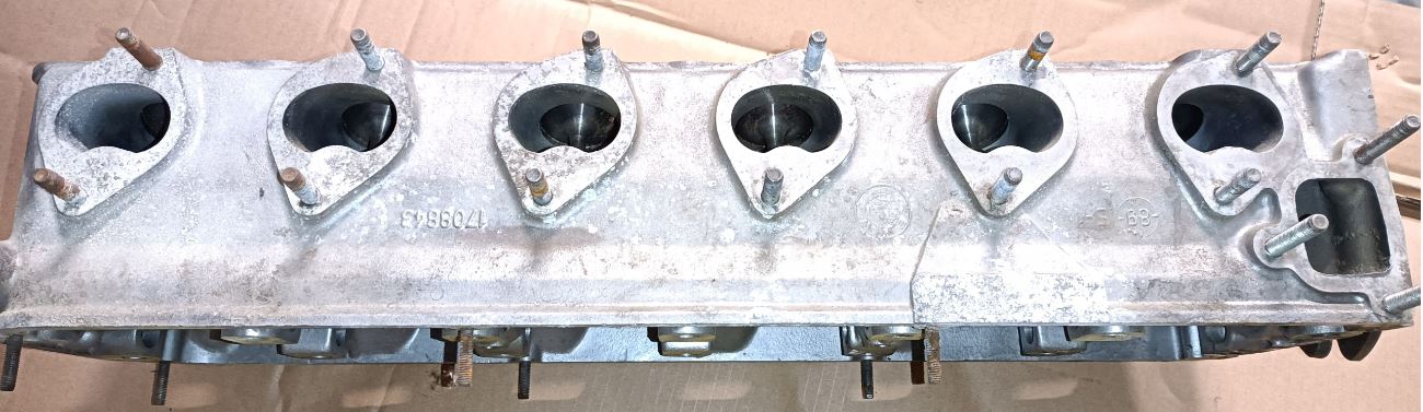

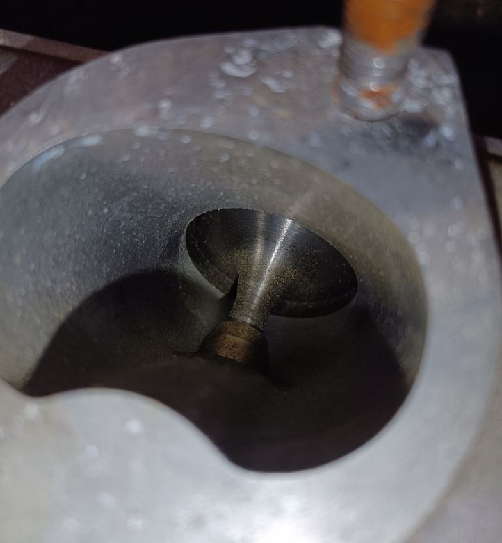

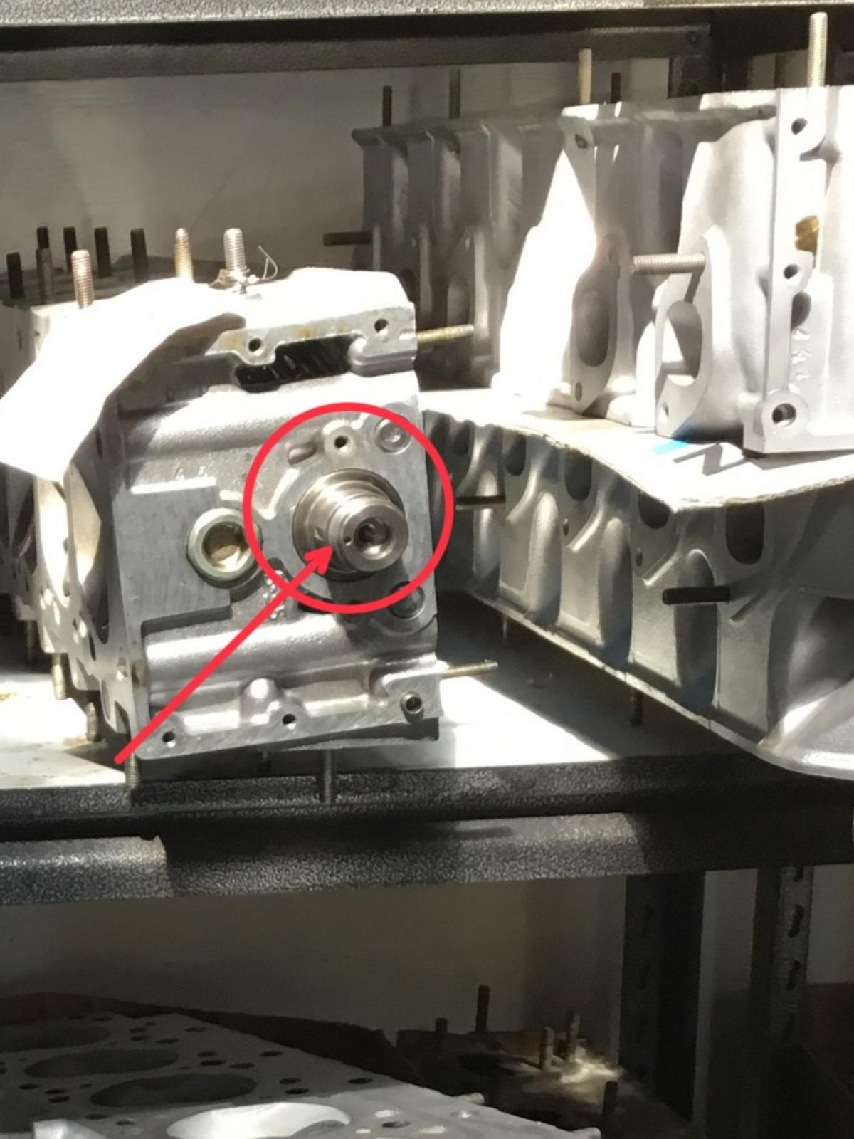

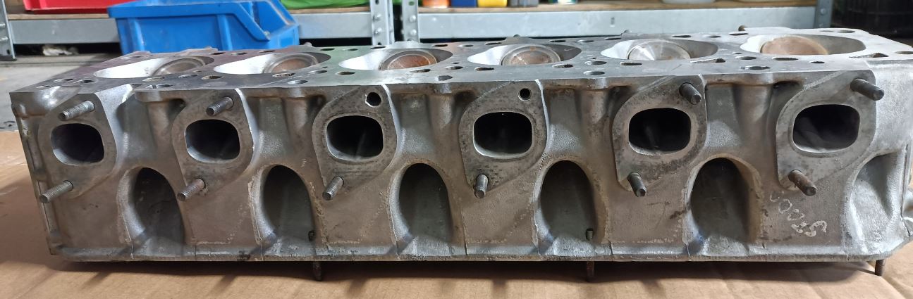

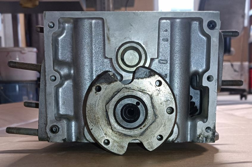

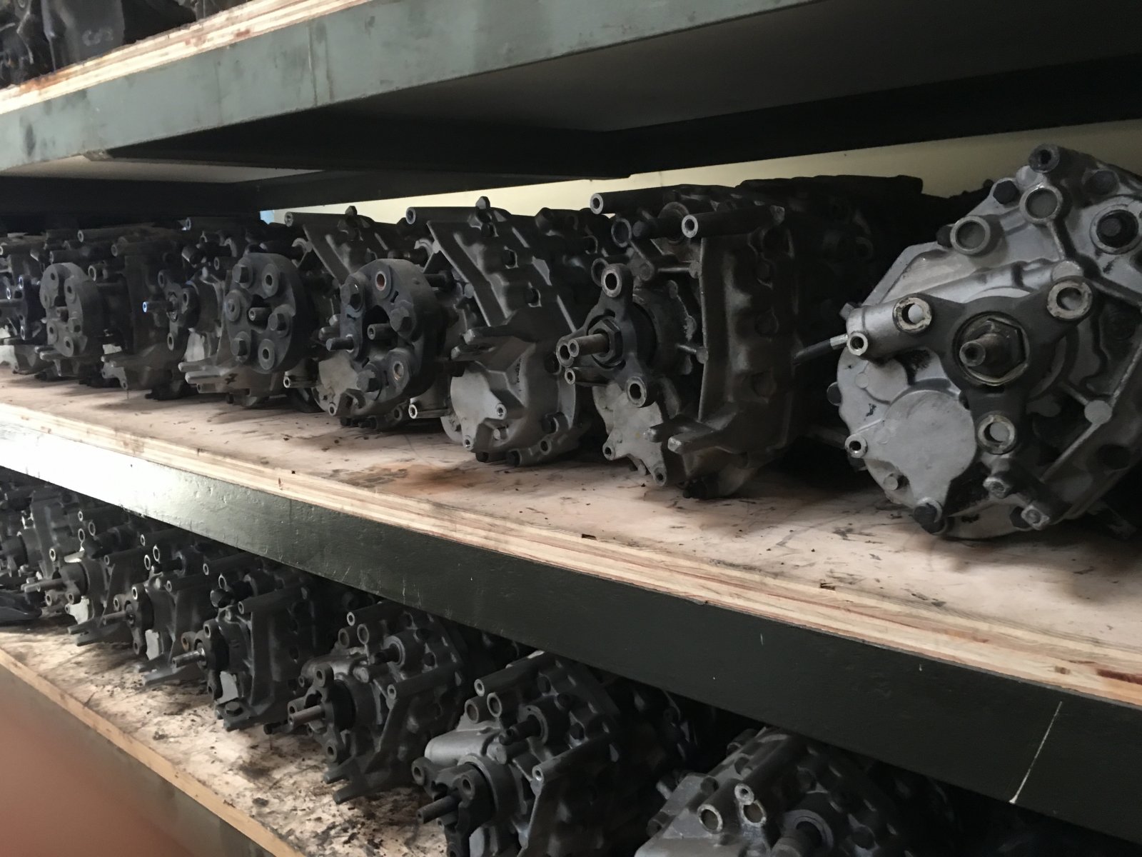

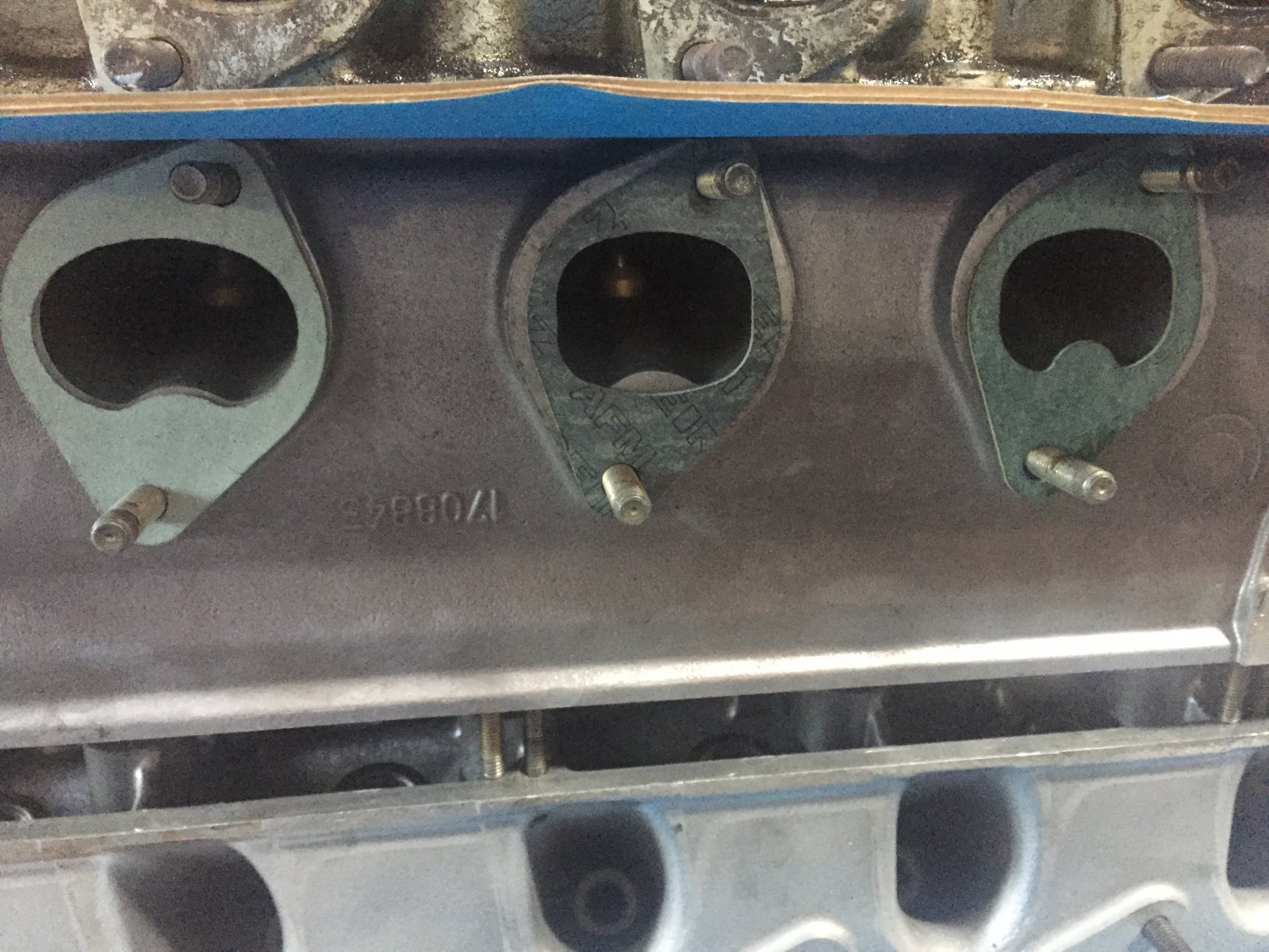

There are 3 different intake ports on our big six heads.
Early, middle and late. Here is a pic of a b35 head with all 3 gaskets.

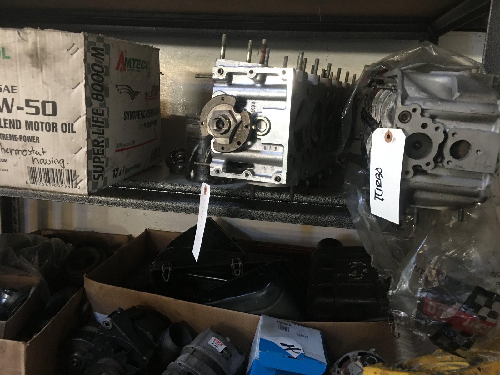

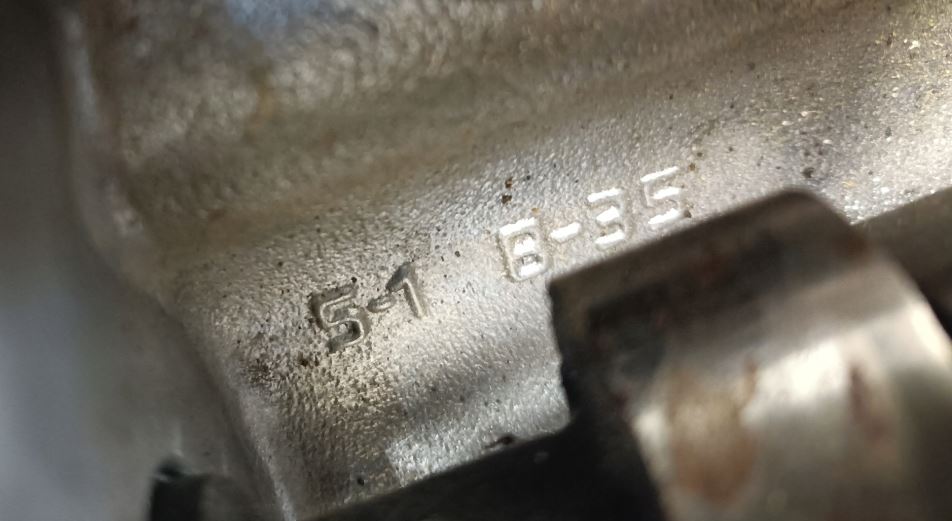

Heads have identifying castings. Some examples…the turbo head has “turbo” cast on intake side at rear. The DOT replacement head had a yellow sticker at the top on the intake side- it was a result of DOT anti theft regulations.
m30
m90
b35
turbo

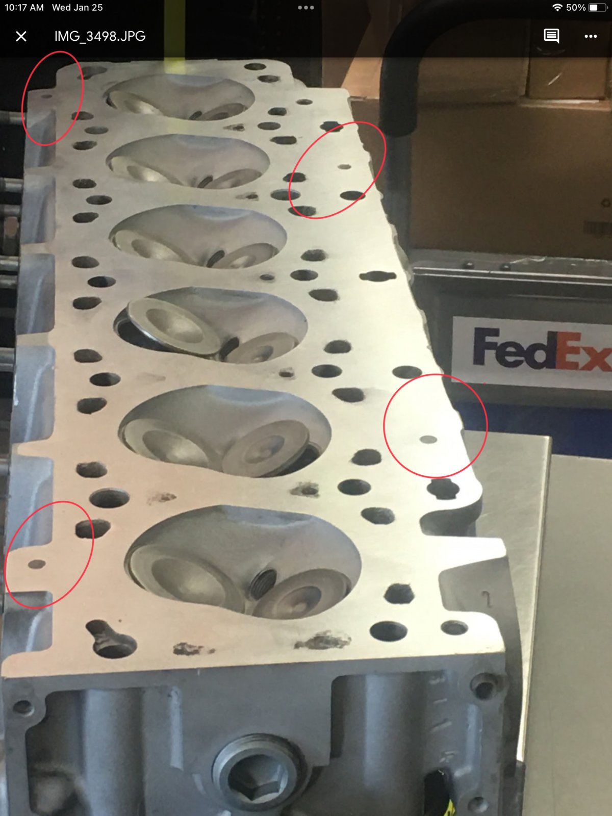

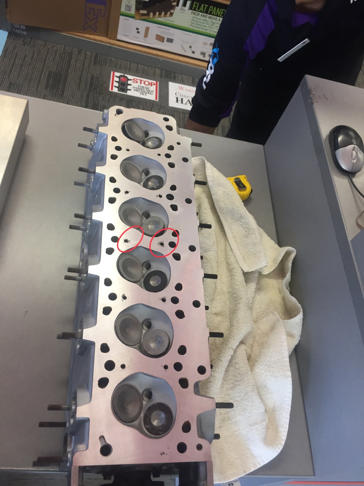

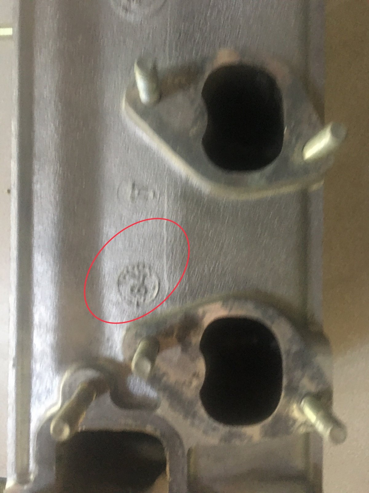

There were no dimples in the beginning, small dimples next and finally- big dimples.
Dimples showed casting thickness without needing to measure.

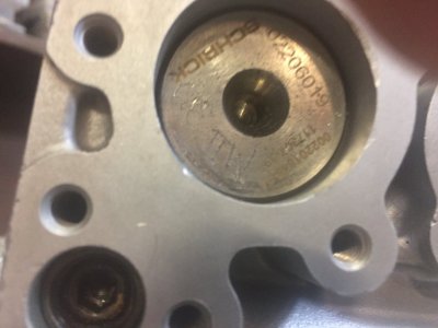

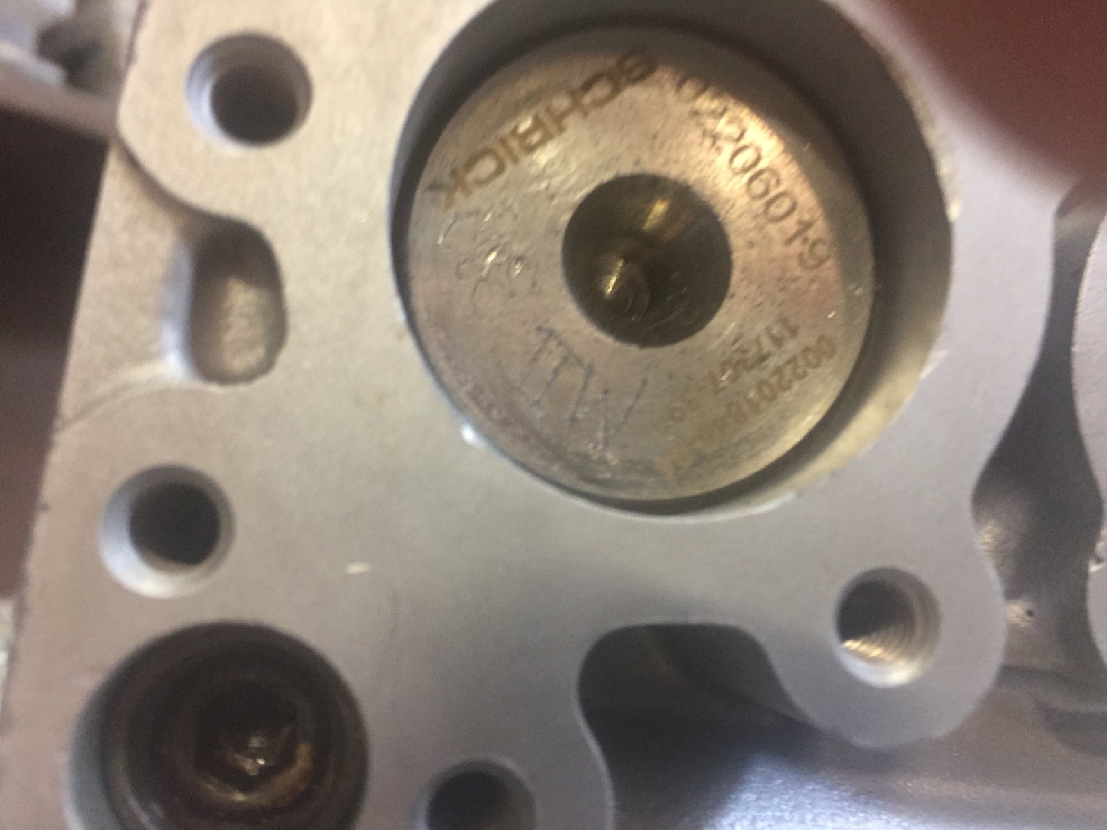

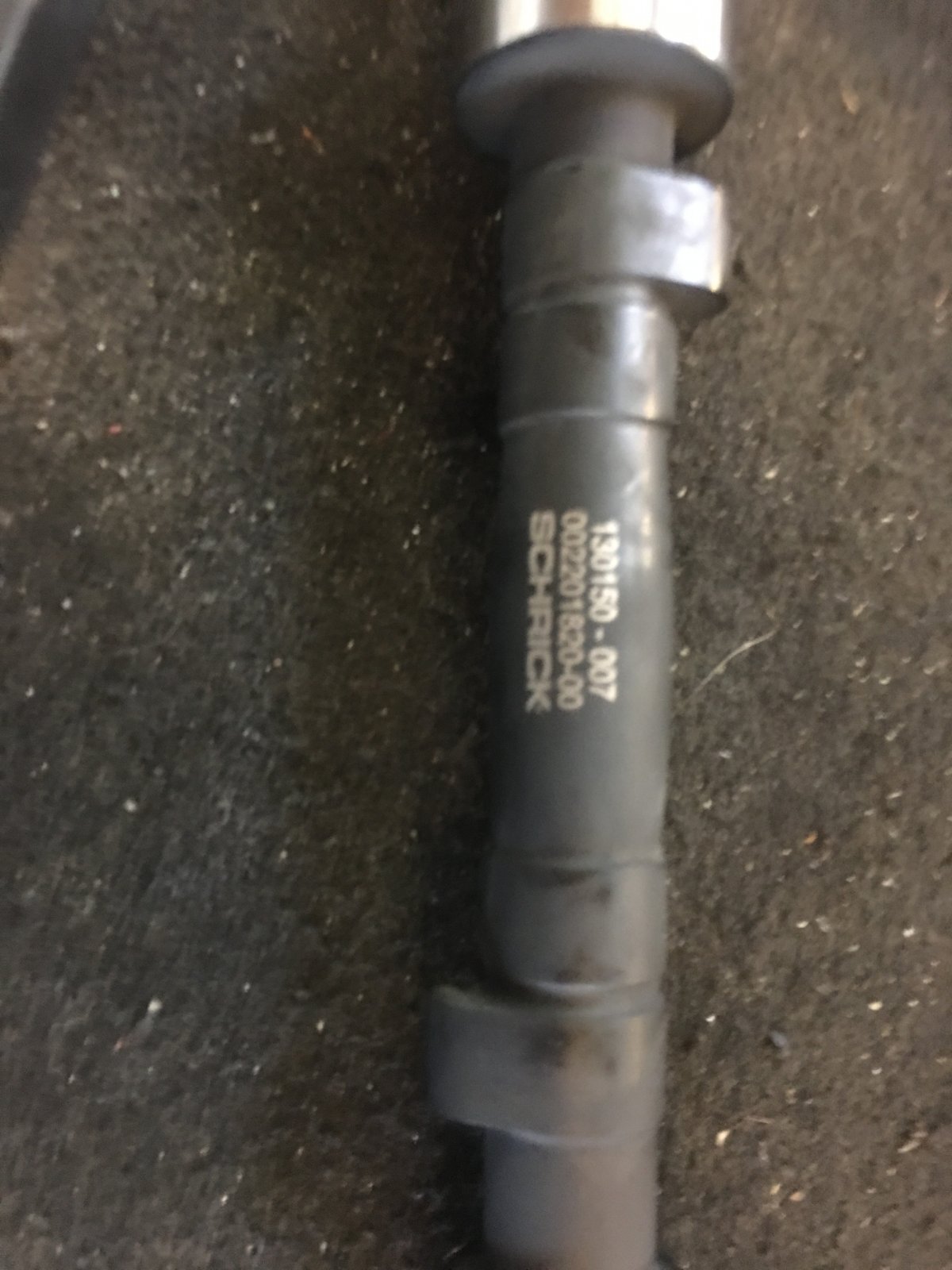

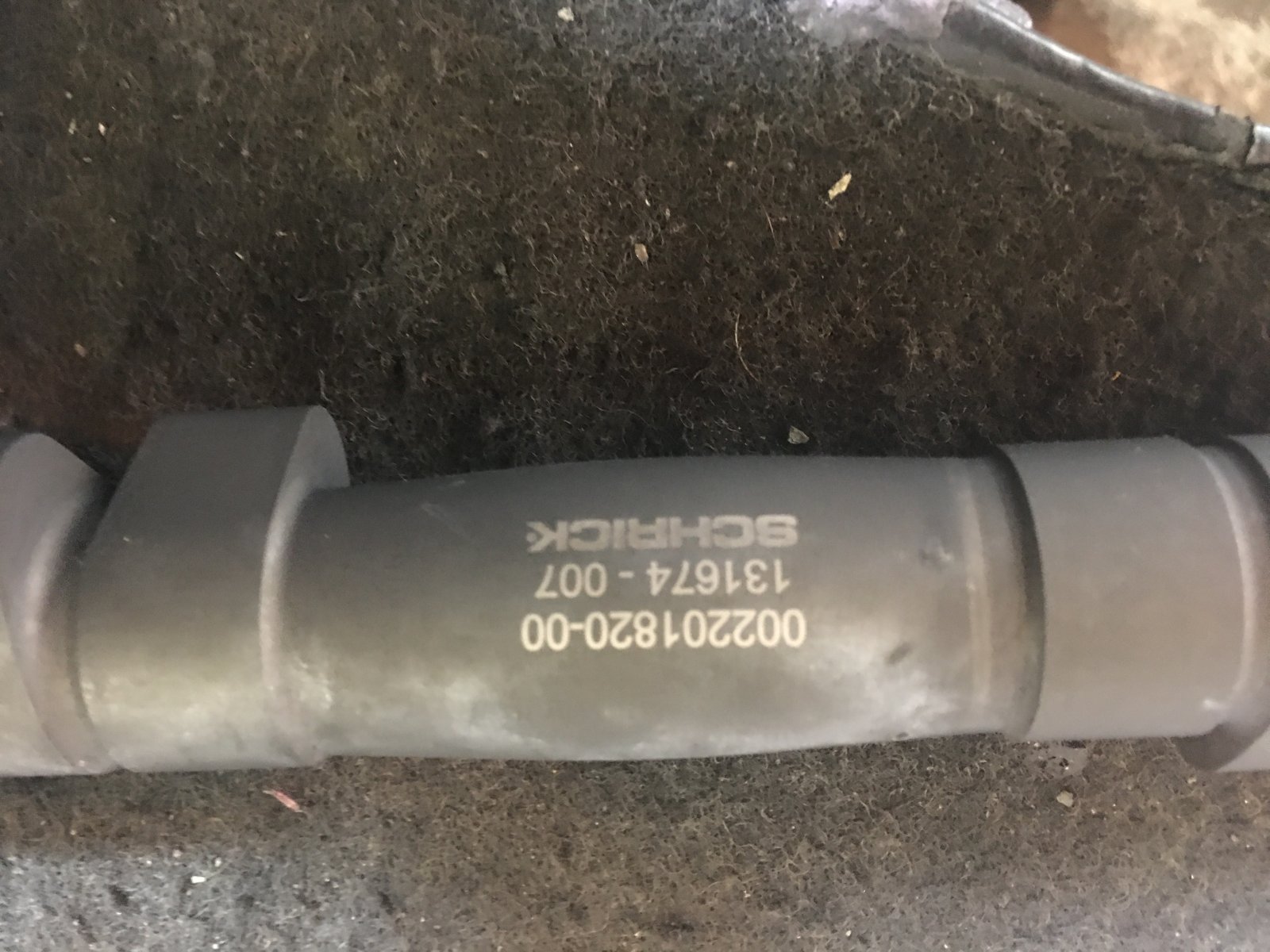

Schrick makes sport cams for all three versions

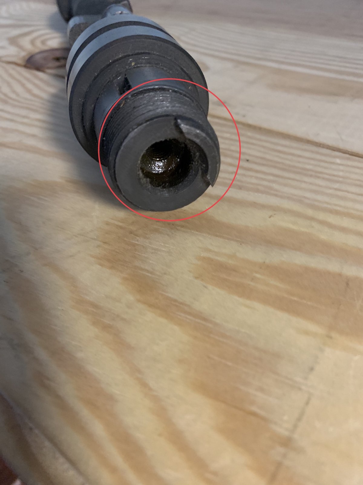

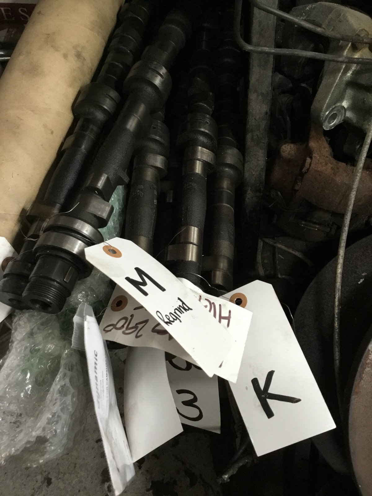

There are many different factory grinds.
3
7
8
K
H
M
B
M is USA early Motronic - 260 duration
K is 80’s euro and late USA - 264 duration
H is 1982? One year only in USA?
3, 7, 8, B are 272 duration
