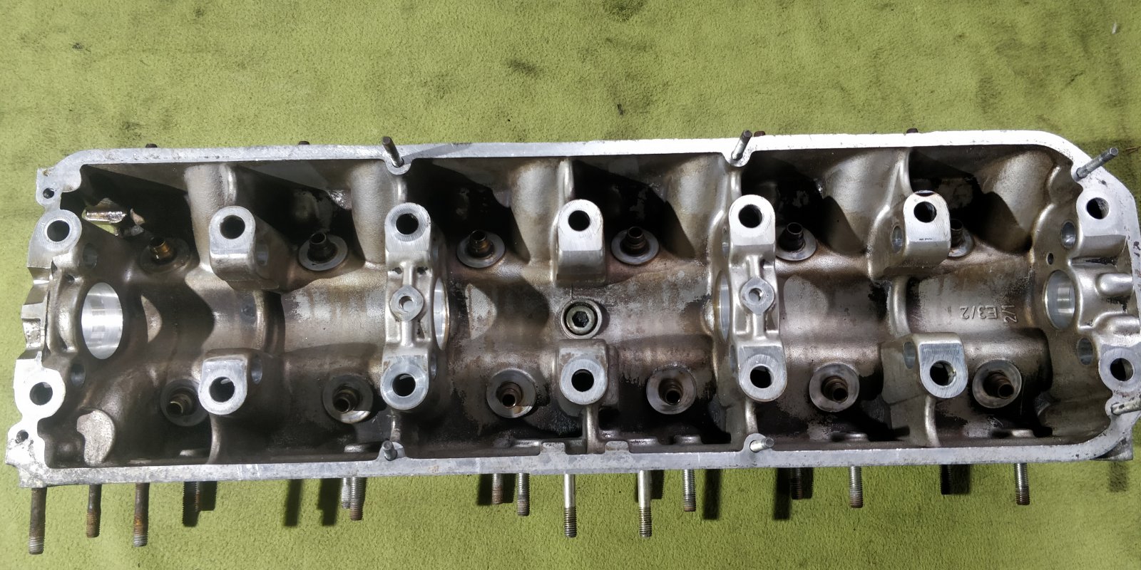

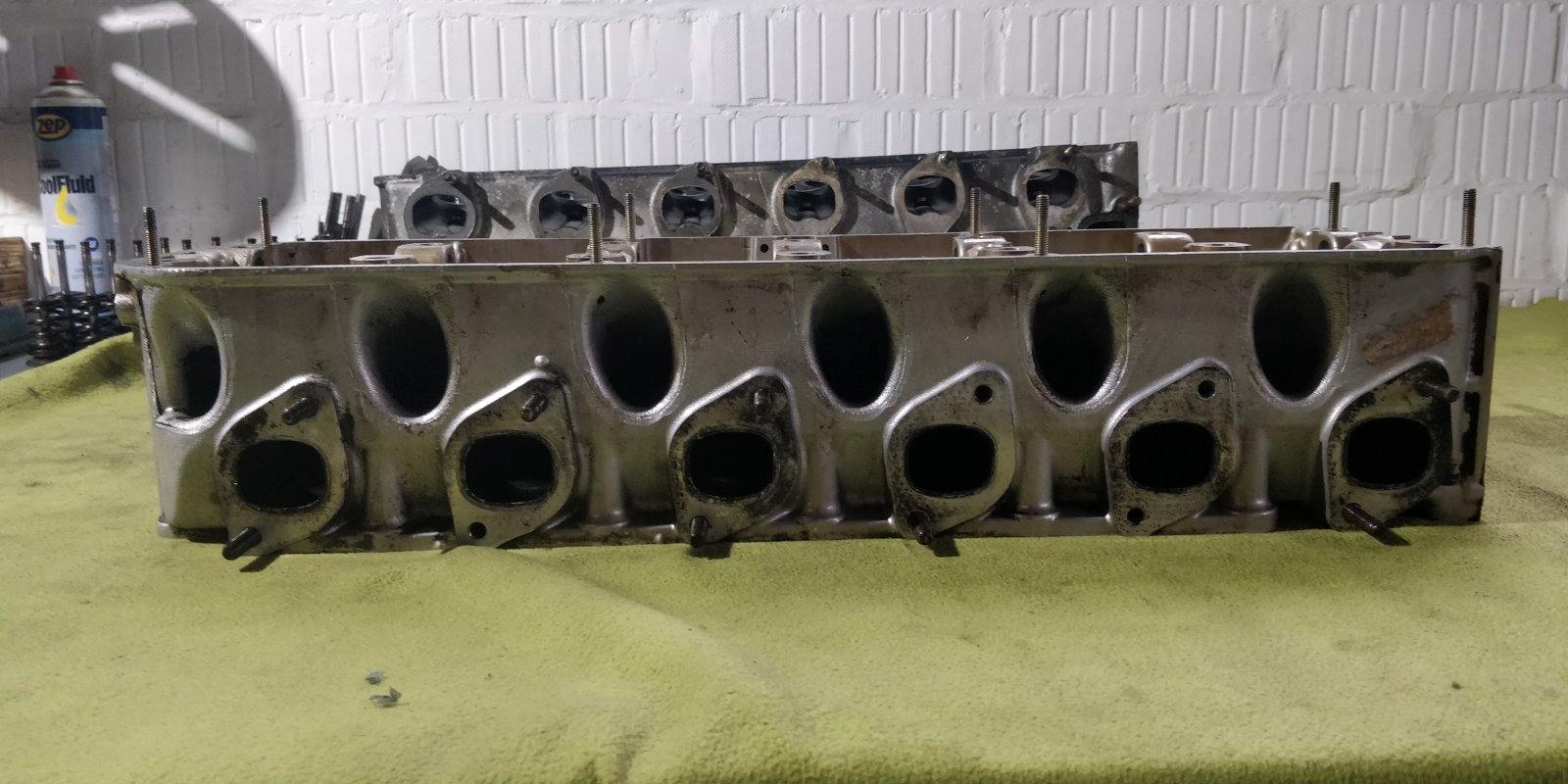

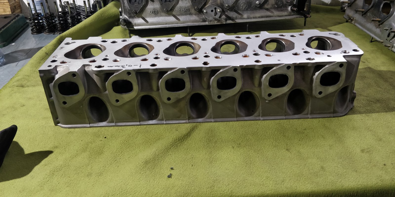

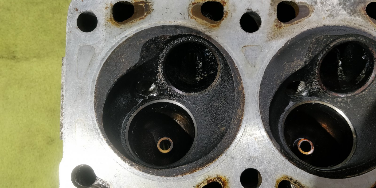

Hi all,

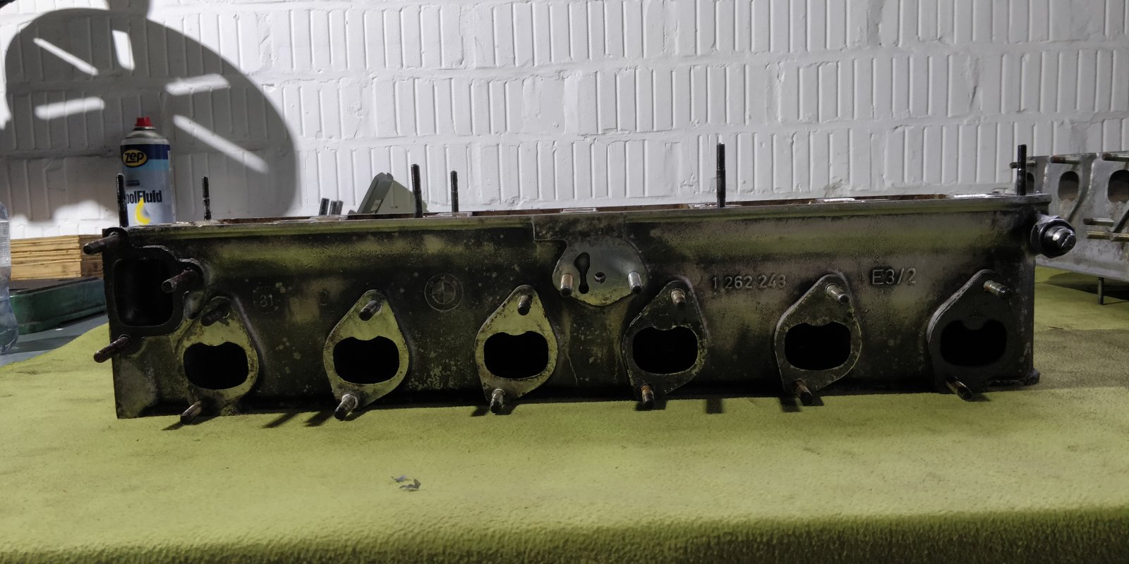

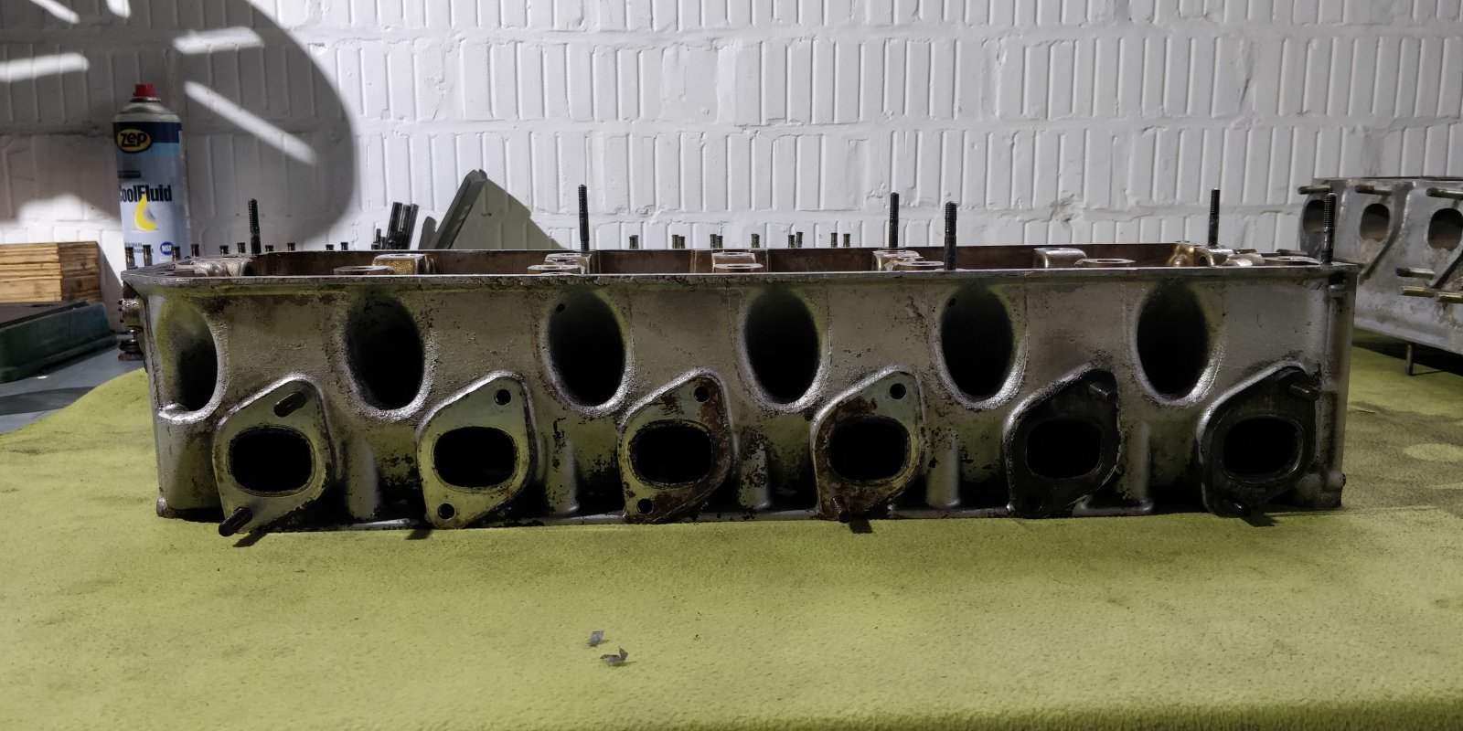

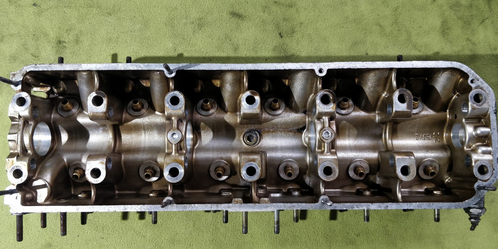

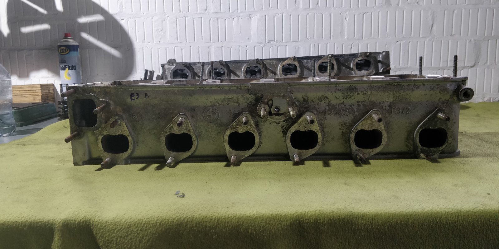

I have a couple of heads to my disposal:
81 - 1 262 243 - E3/2 - height: 129mm - cil volume measured: 61.2cc (i suspect a bad measurement, will redo at some point)

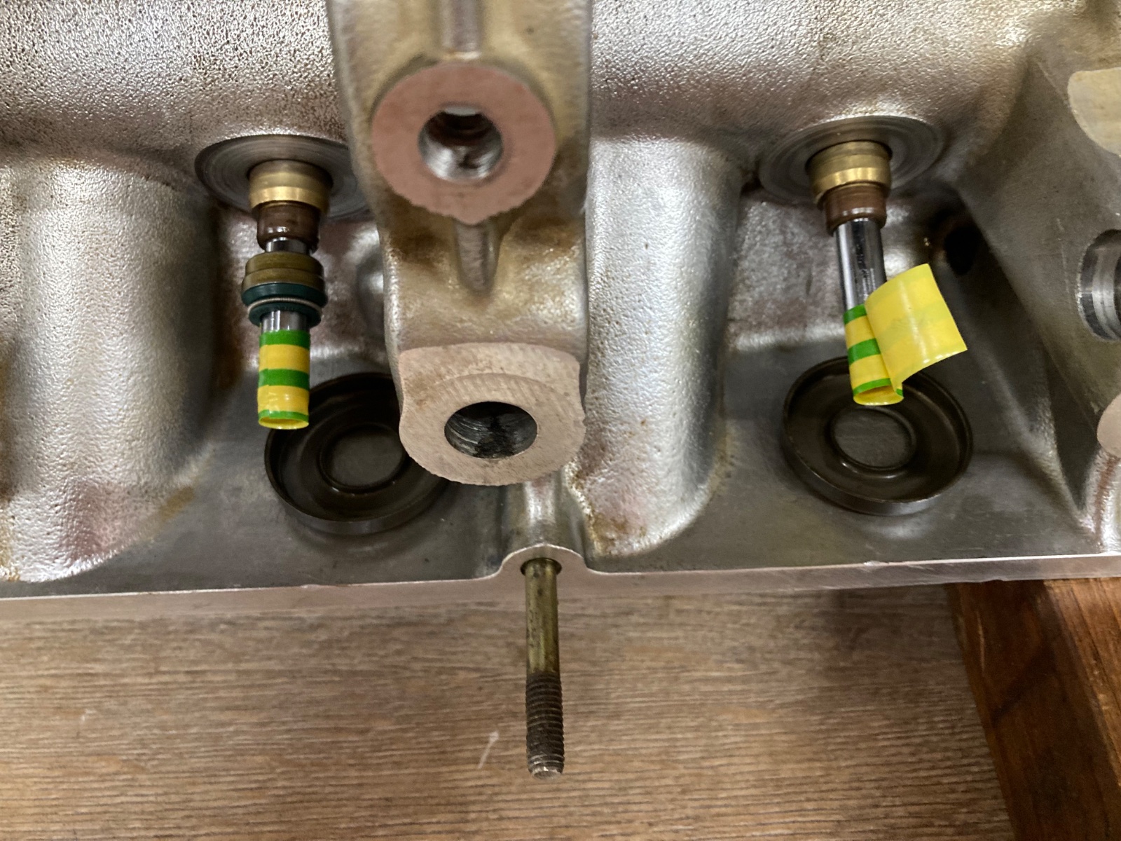

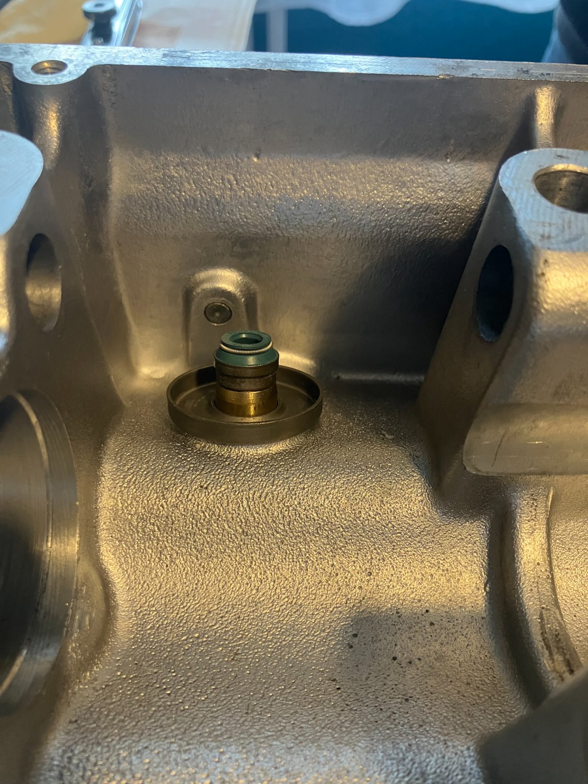

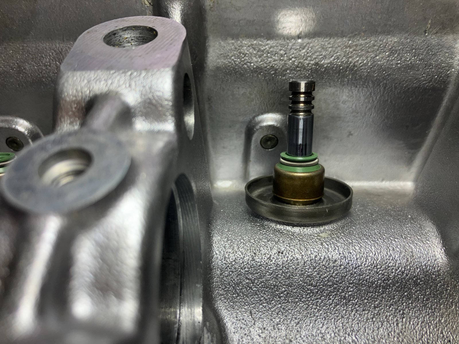

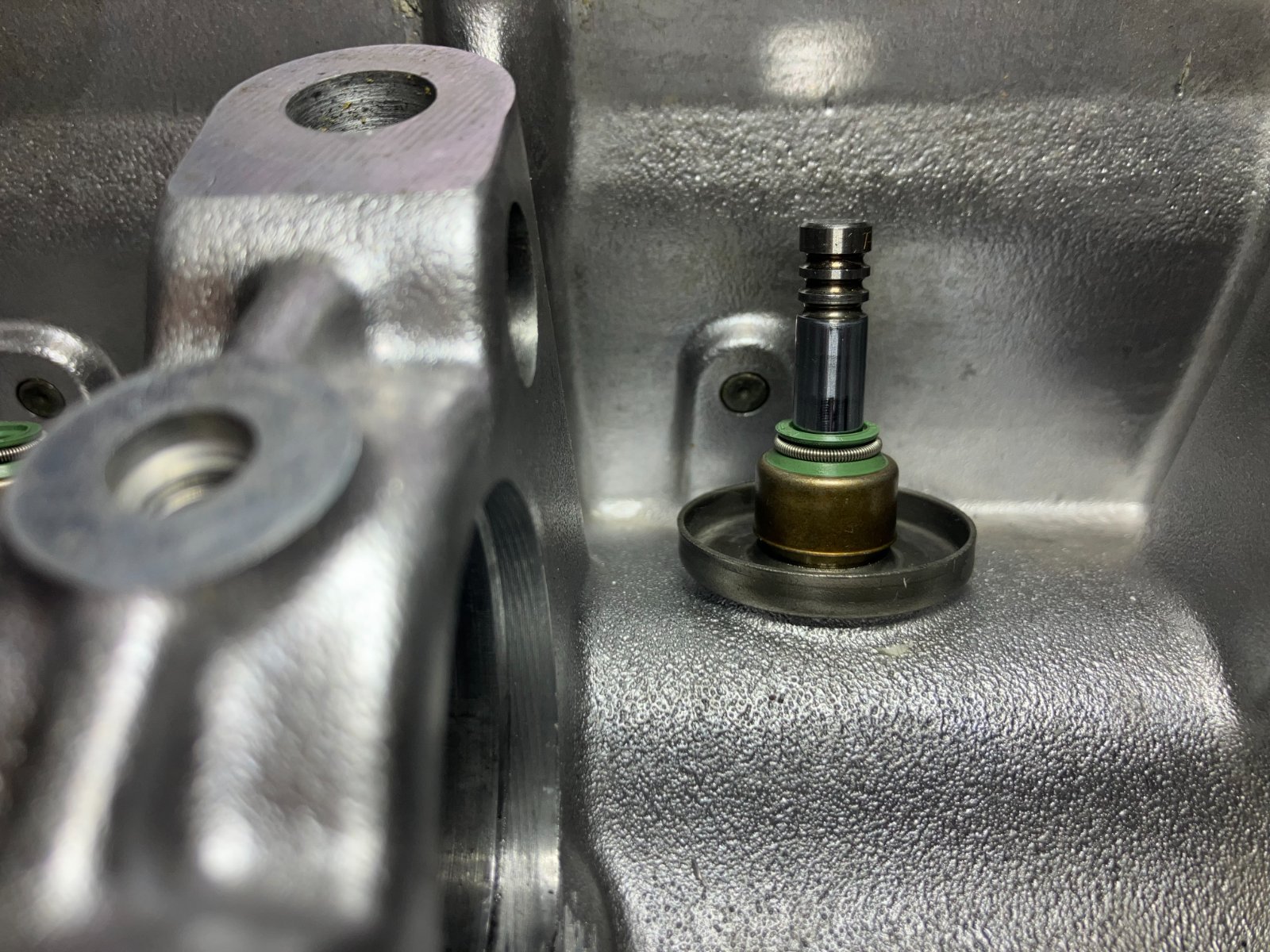

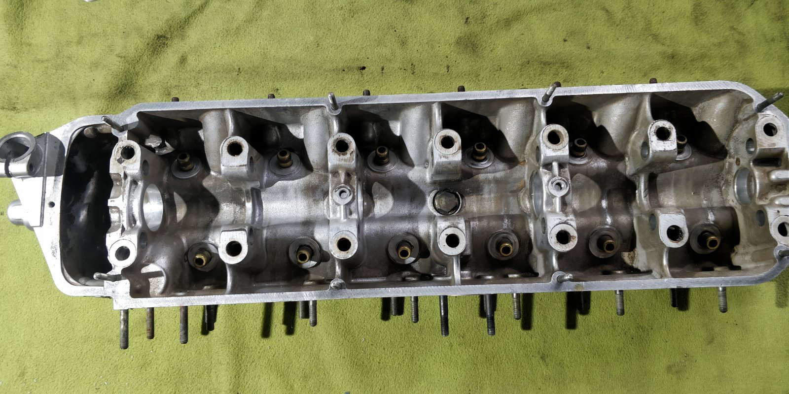

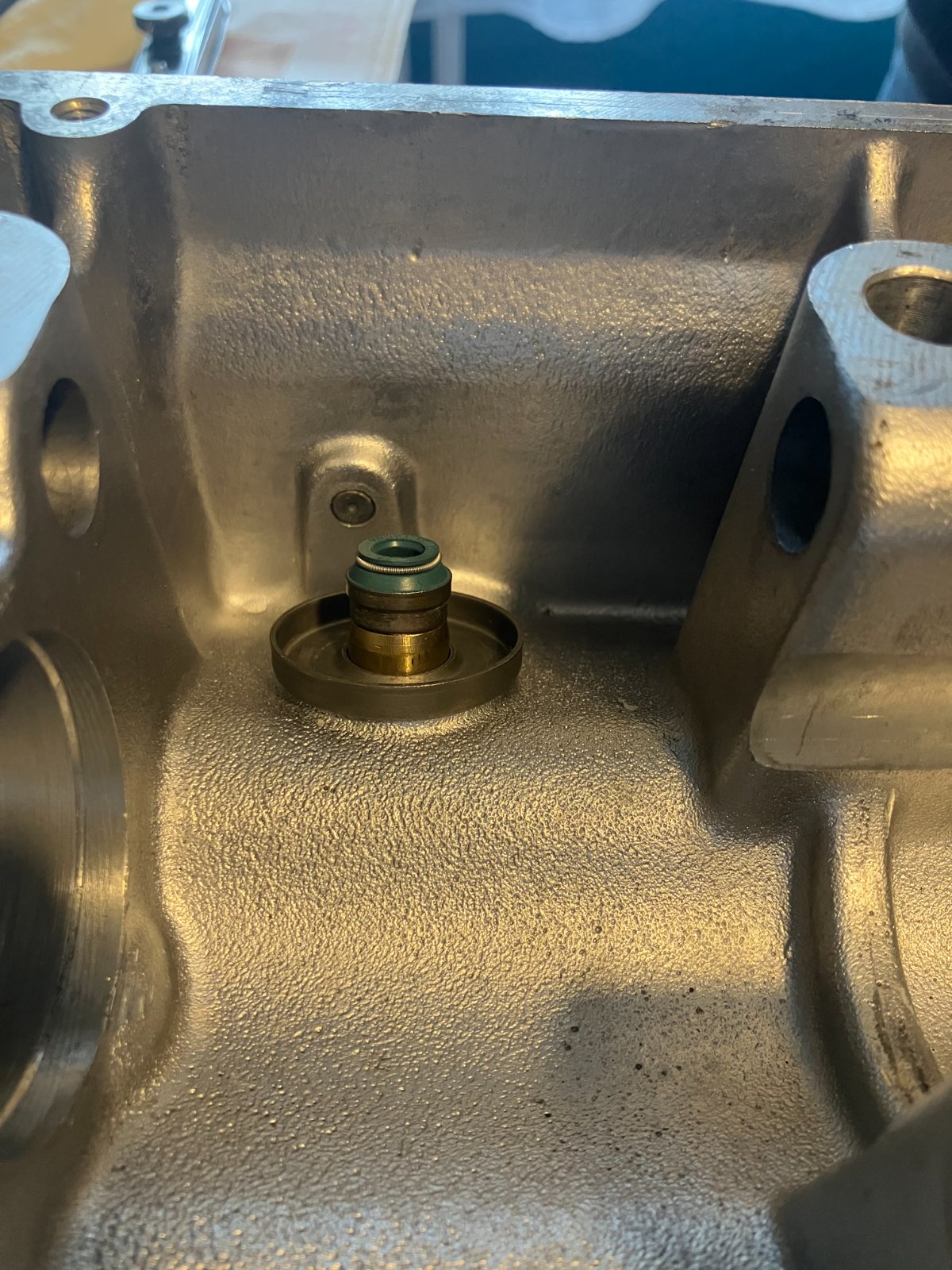

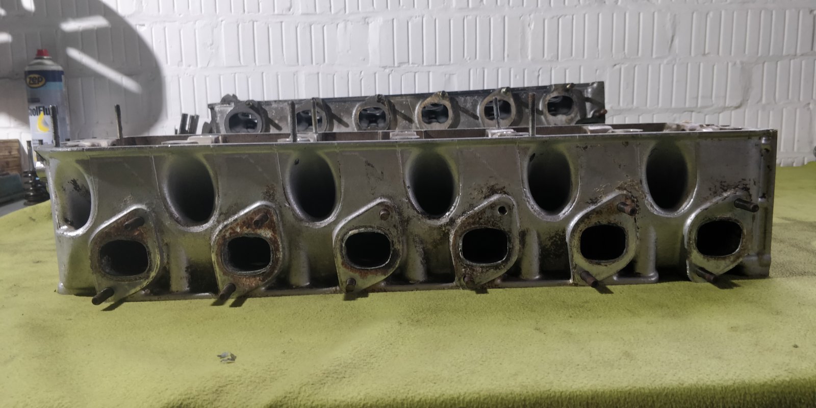

I am current restoring a M30B30 engine. The cylinder head is a 1 277 358 from 1984.

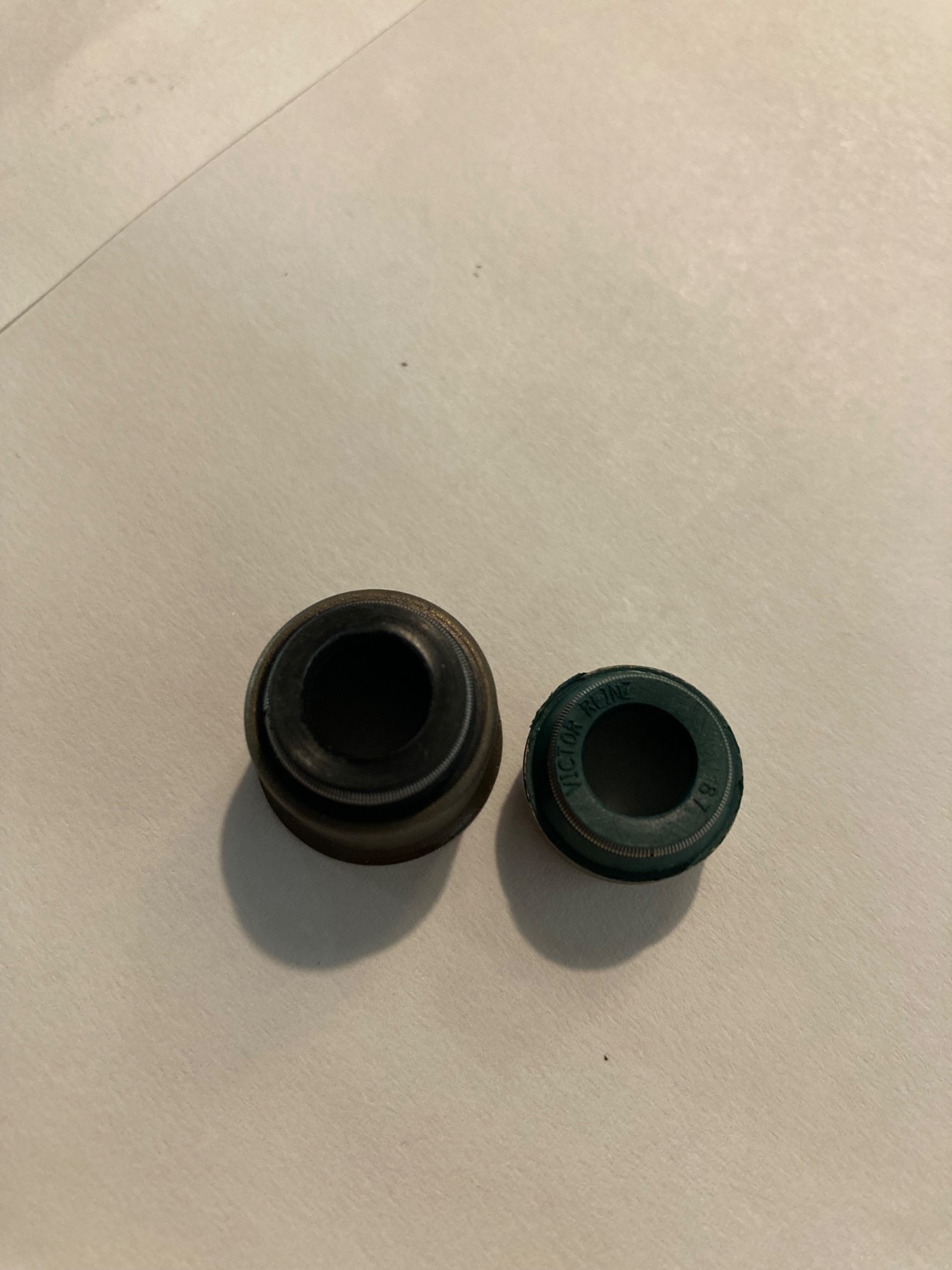

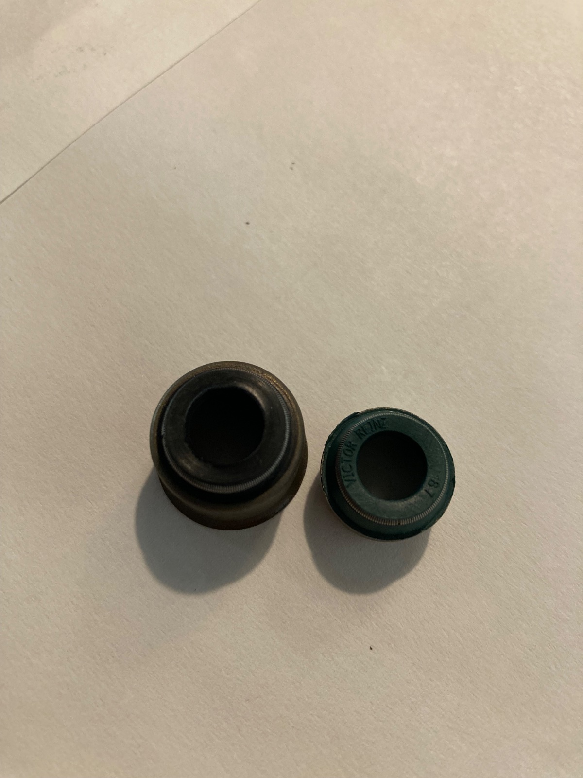

Interestingly, the valve stem seal is not the same as the one supposedly used on the original cylinder head (1 250 017). See below pictures:
- On the left, the valve stem seal recover completely the valve guide, but does not firmly hold onto it.
- On the right, the valve stem seal butt against the valve guide shoulder and firmly holds onto it.

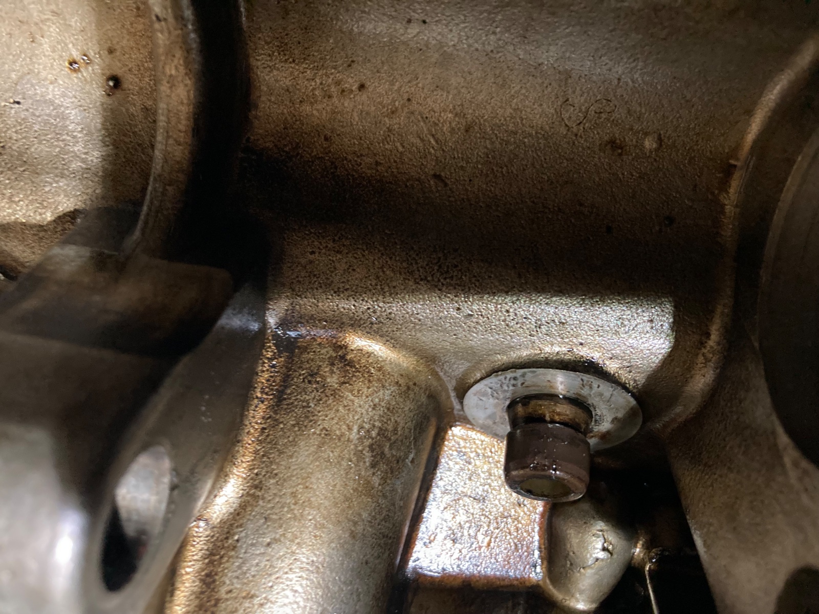

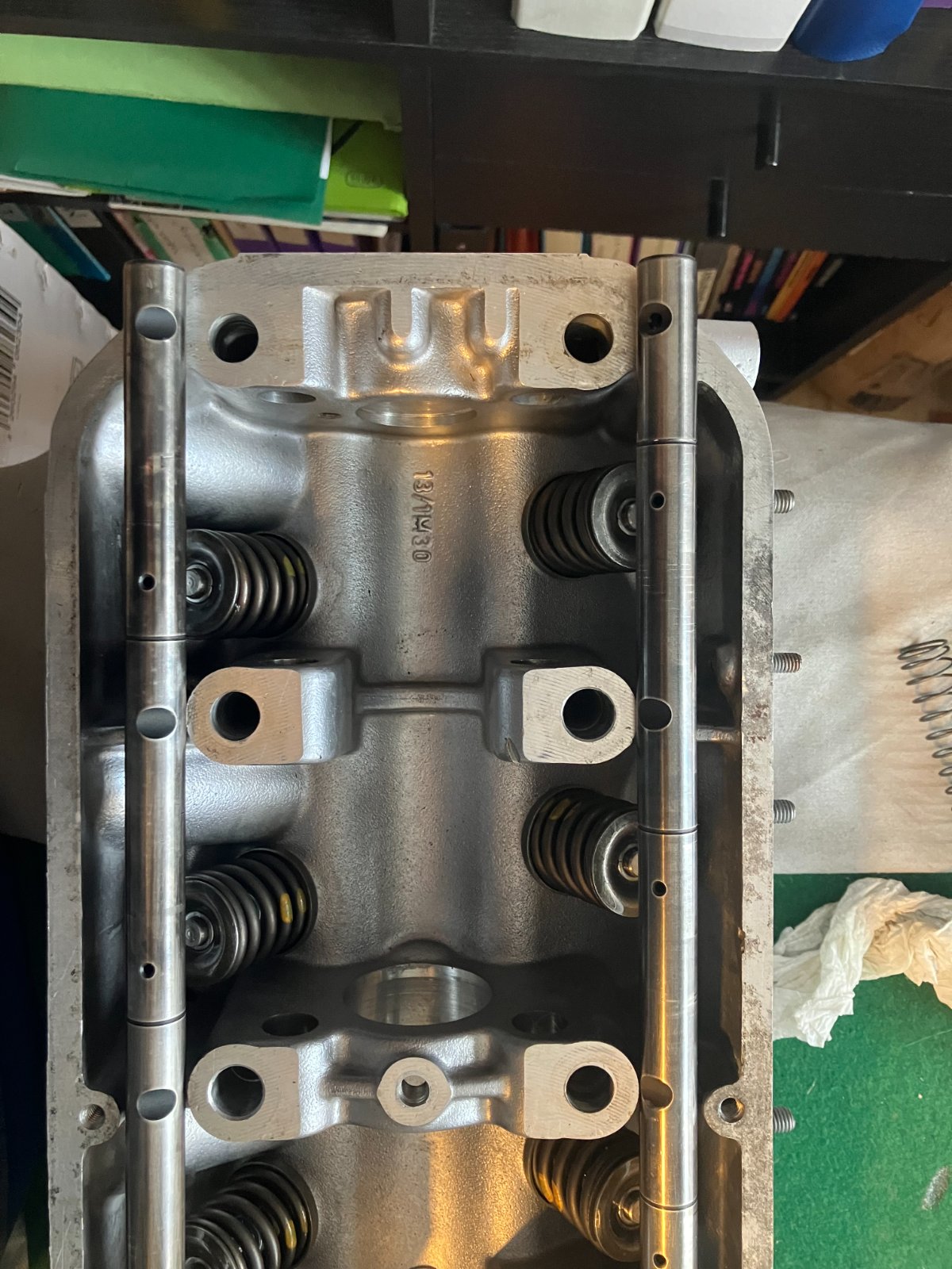

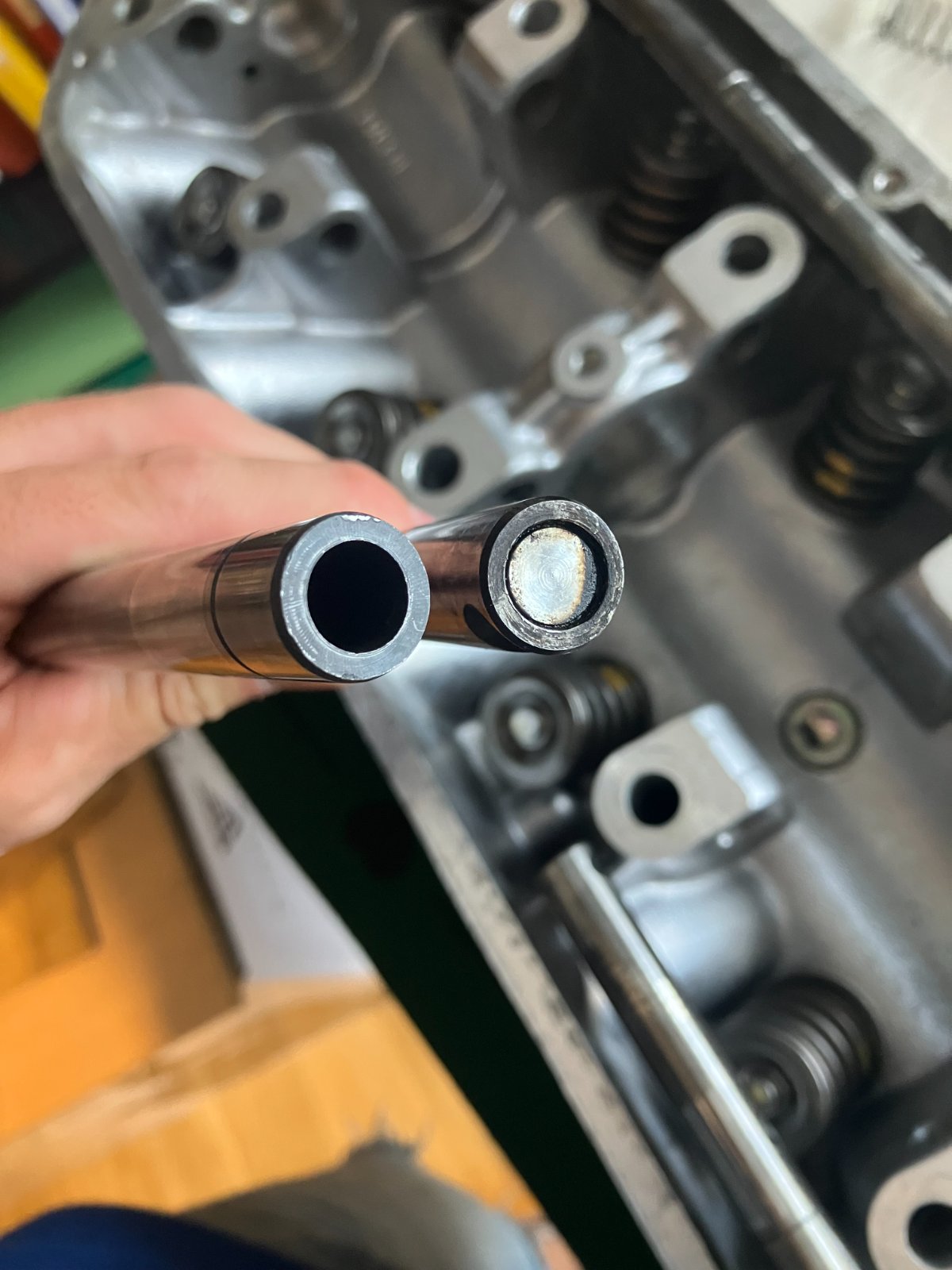

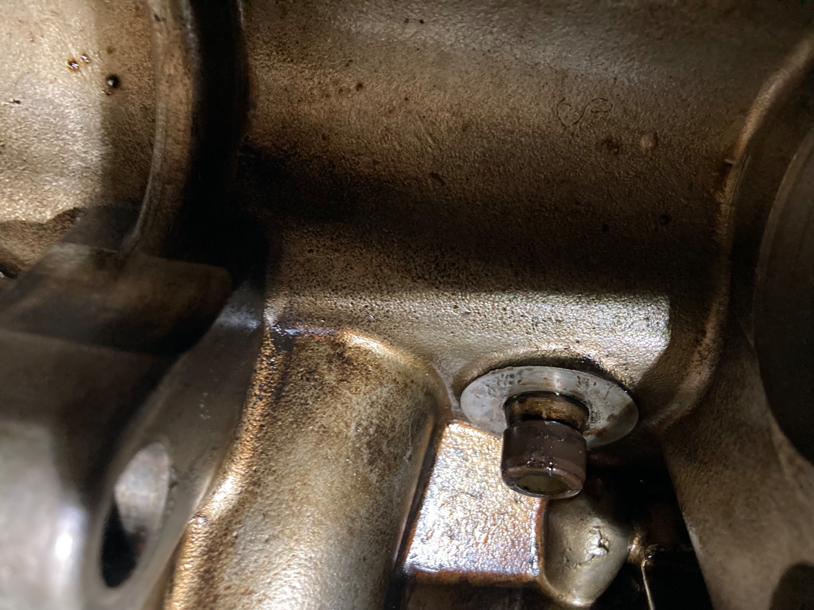

Also, the rocket arm axle is not fitted with the center plug (item 8 of the 11/23 in the part manual).
- On the right, the original rocket arm axle, fitted with plugs (external plug is screwed, center plug is press fitted)
- On the left, the 1985 rocket arm axle, fitted only with the screwed external plug)

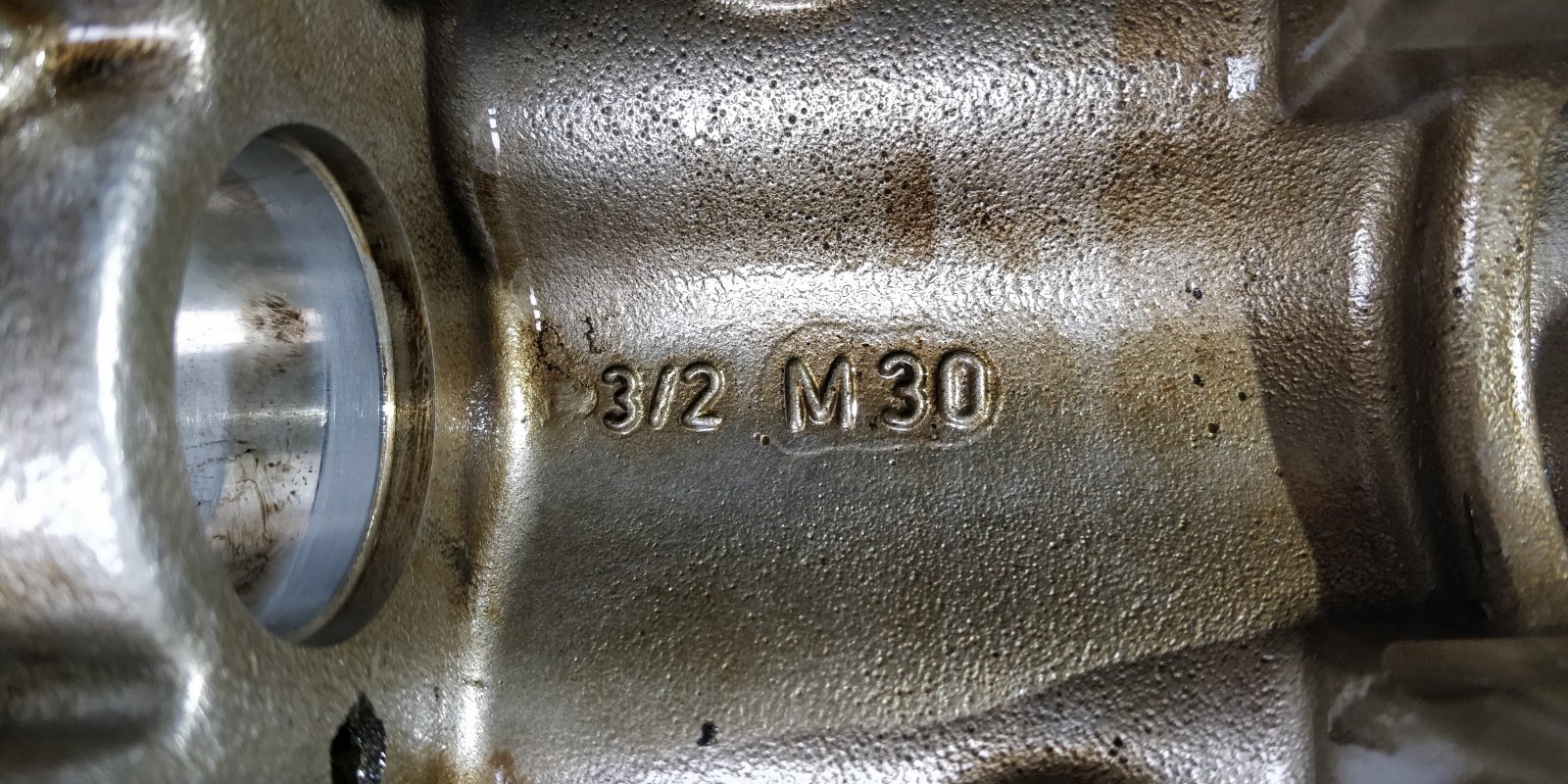

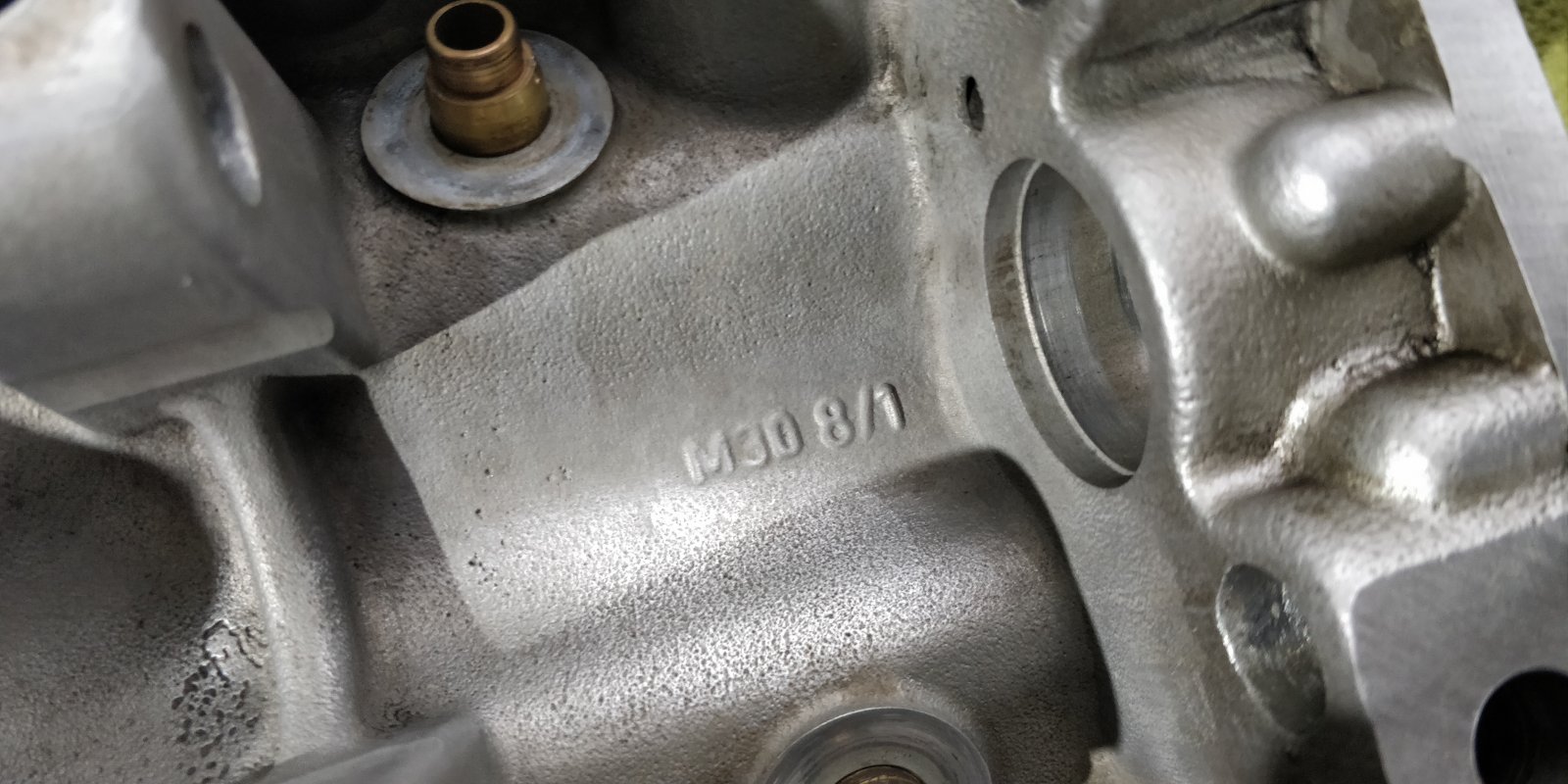

By the way, the reference inside the cylinder head is 13/1 M30:
there is the “old” type stem seal which covers the complete guide. See also this picture of a 1977 type.
And there is the improved version which covers only a little bit. Those are the best and are a easier to install. You’re lucky if you have this type stem guide.
So it depends on which type stem guide is mounted and which type seal you have to order.
PS be aware not to damage the new seals when you slide them over the grooves!! There are very sharp and your seal will damage. Oil consumption!
I use a tape around the valve stem grove before putting the new seal over it.
