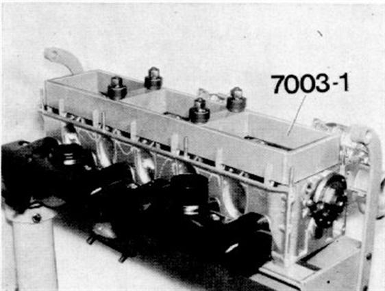

This is the tool that is used to depress all the rocker arms at once to facilitate easy removal of the camshaft. I've searched the forum at length and done a general search for this tool and have come up empty. I know there is/was an alternative available at one time. Does anyone know if this tool can be purchased or if not, a set of plans for making one?
I know there are some alternative methods for removing the cam from a M30 head using home made tools but there have been so many times over the years I've wished I had the real thing. Thanks in advance for any suggestions.

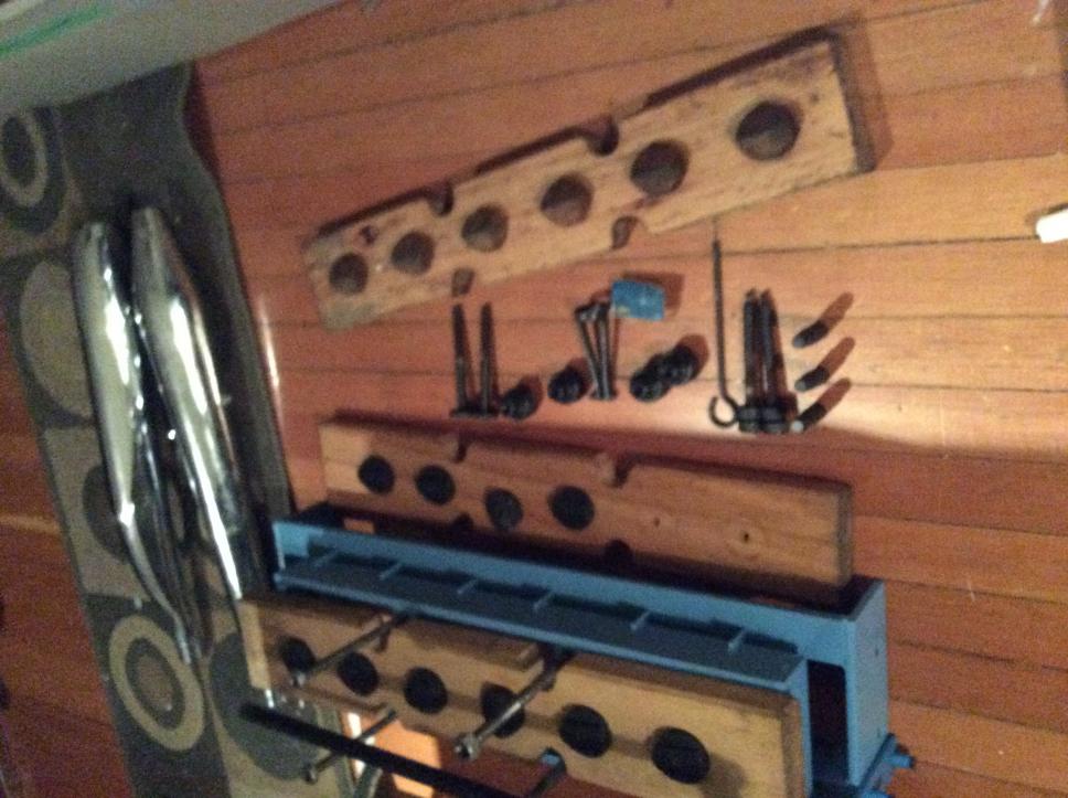

I sent two off to Sweden last year. One for the s38 and an m30 variety. Aka iron maidens. I tried to sell it here but no takers. I still have one for the 4 cylinder.
If you search this forum for iron maiden you will find buzzbomb may have one for rent.
Those are the ones
