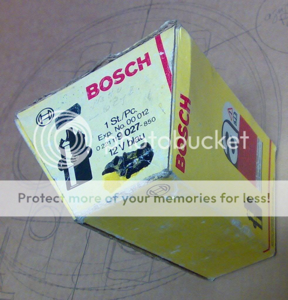

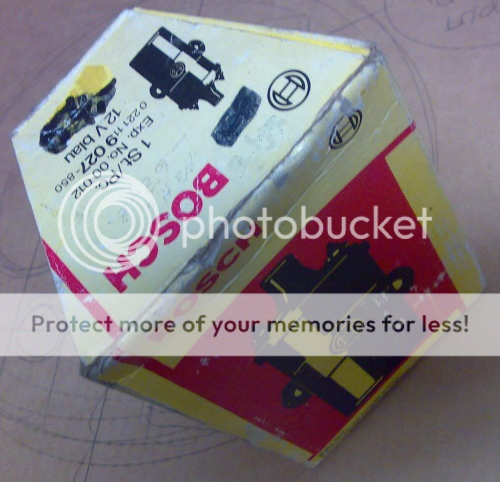

Bosch Blue Coil
De Quincey,

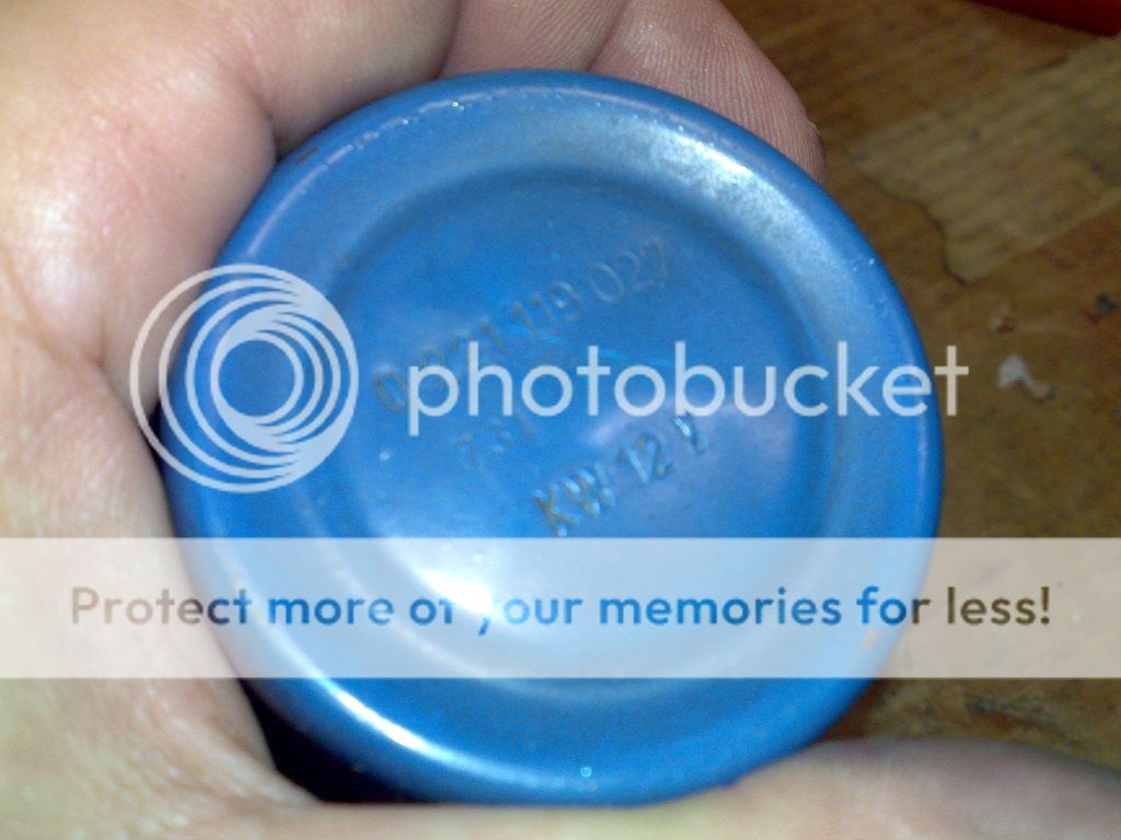

before i answer your question, i need to ask a question ... would this coil work with a 3.5 injected engine with l-jetronic?
scott

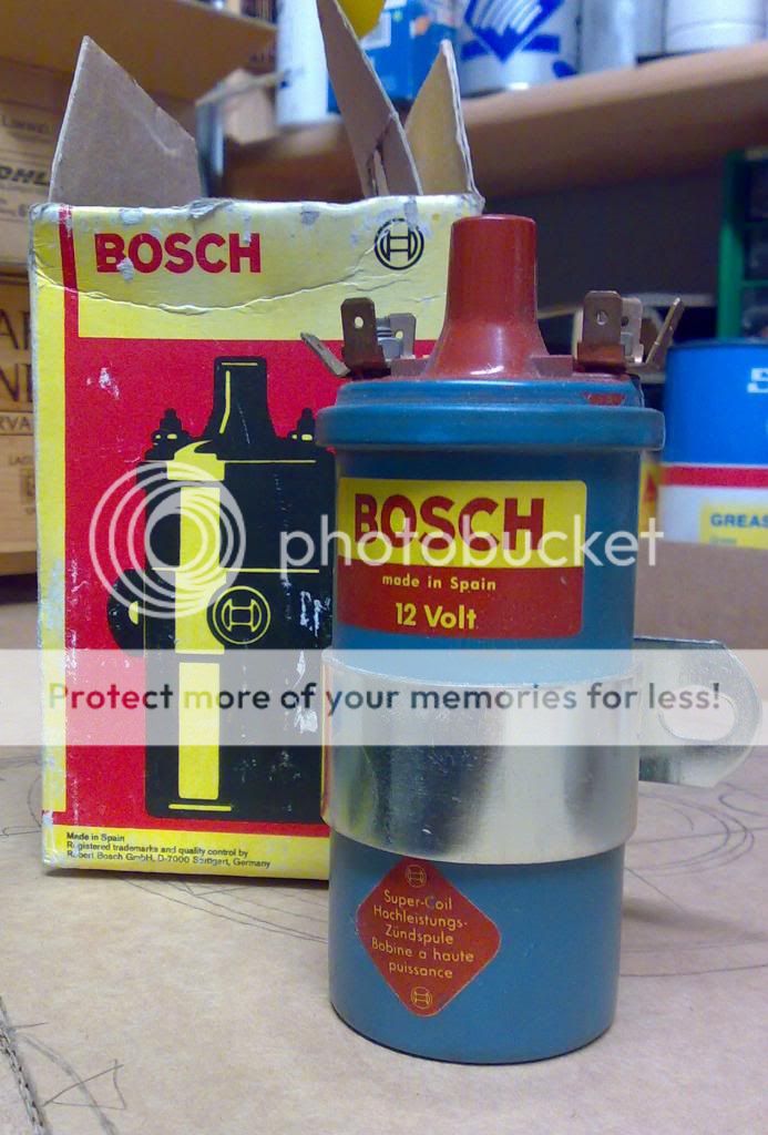

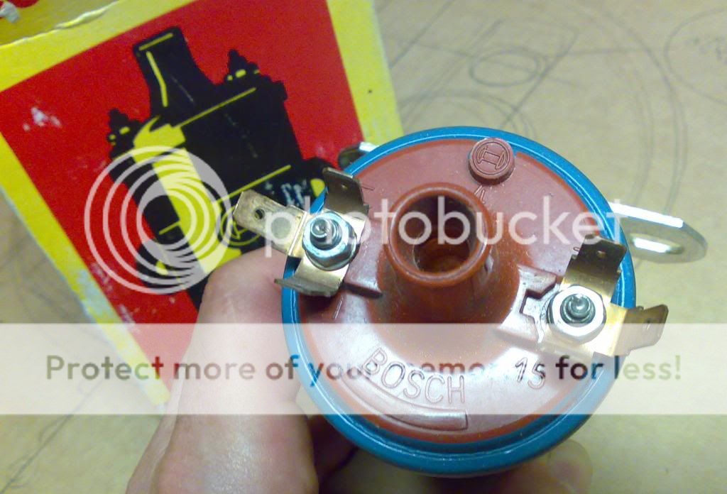

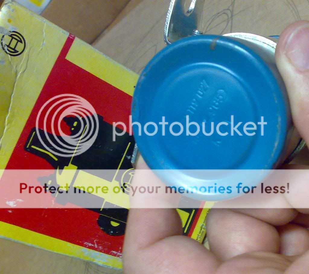

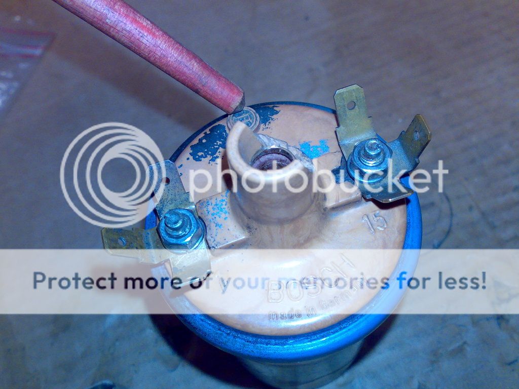

thanks Luis, i think this would say that my coil came from Brazil. according to this description, the coils made in spain had a tan cap ... and singular spade connector tabs. of course, i have no idea if older or newer brazil coils would make a difference.
so my question remains - do these work with an engine with l-jetronic or no?

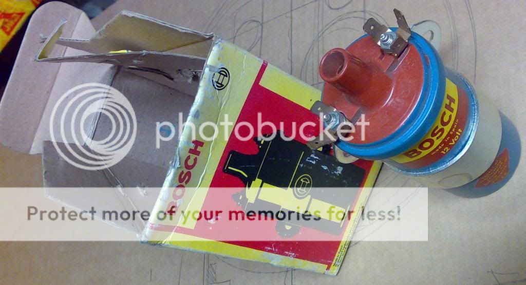

will that work ?

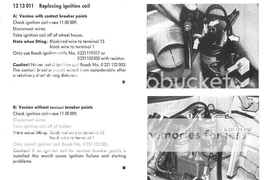

hi scott
i have no accurate answer to your question
the only thing i can say is that the blue manuals specifically says to use that coil on carbureted engines ! and never use the other number that is intended for EFI engines
i only can assume that the contrary can be said, so dont use a "carburated" coil in an EFI engine
but as i might appear like an interested part:twisted: in this issue you´d better ask the "experts" (all heads turn to jerry !) :-D
read it in the blue books
scott, according to the book, you may not use that coil in your efi engine, read the second paragraph (the CAUTION sign):

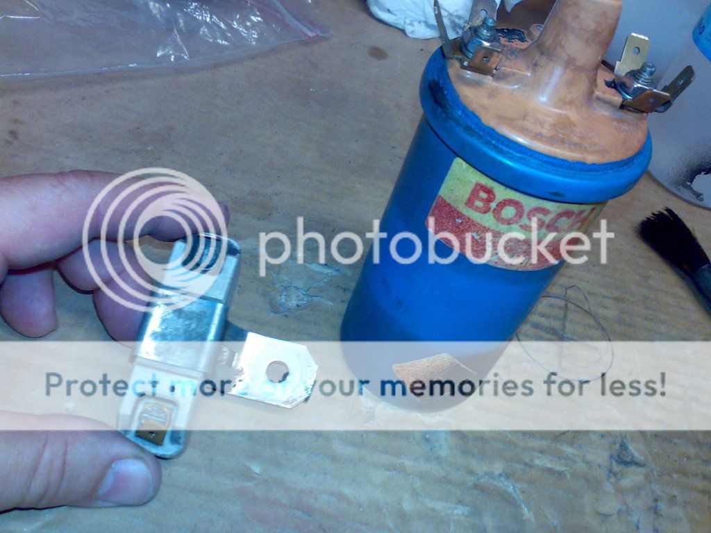

WHere did you get the bracket? I am going to have some parts Cad plated, but I guess this bracket was originally in this finish?
