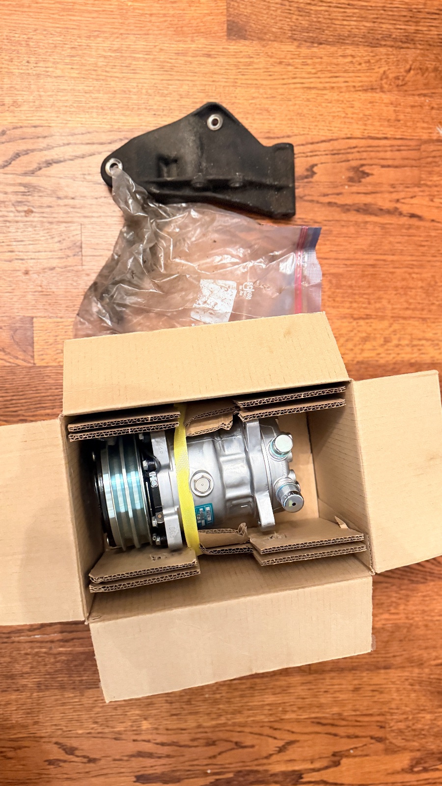

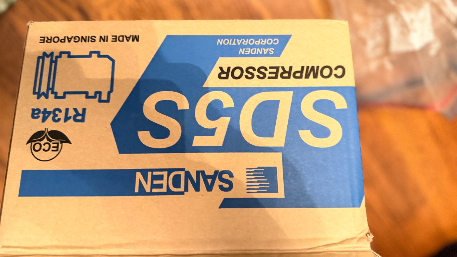

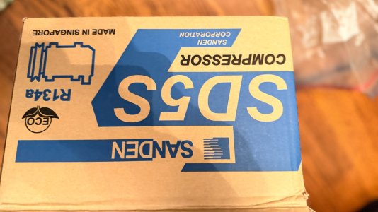

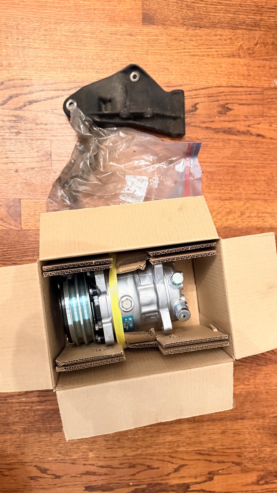

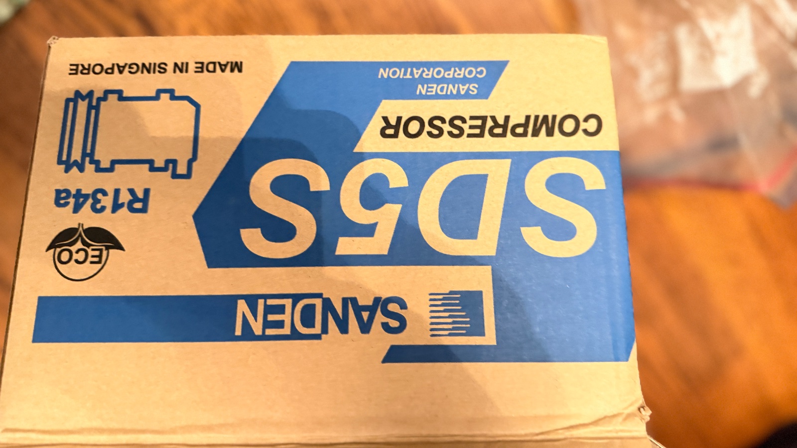

Howdy - have the block mount, hardware and compressor for the sander conversion. Am I correct that there is a custom support bracket I need to acquire as well. Thanks as always. Tom
You will still need to source a couple of items:
a BMW wing cell bracket: part # 64-52-1-284-953
as mentioned above, you will also need a bracket that is made by a forum member here @Layne (see link below)
You should also consider getting a parallel flow condenser if you don't already have one.
Here are a couple of information sources:
Layne's Bracket: https://e9coupe.com/forum/threads/sanden-compressor-conversion-brackets.34898/
AC upgrade with sanden style compressor: https://e9coupe.com/forum/threads/d...compressor-and-parallel-flow-condenser.38364/
Bought it from a member here. Off an e28 if i remember correctly. It’s the correct one.
Ordered Layne bracket from Wylie. Thanks gents. Have a drier, need to look into parallel flow condenser and hoses.
