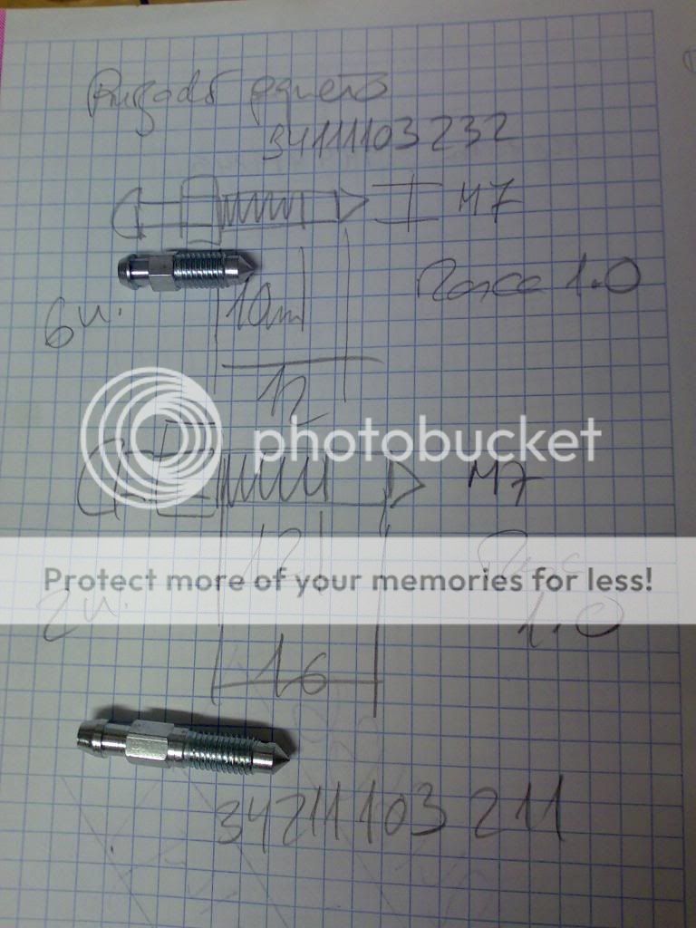

All I could find in the various past search sites (RealOEM) for the CS brake bleed screws are part numbers - no sizes. Anyone know what size the front and rear take? Diameter, thread and length? I have a mix of 7mm and 1/4" and want to standardize.

two sizes:
for front calipers: 3 units of ref. 34111103232
M7, thread 1.0, thread length. 10mm, leght to tight base 12mm
for rear calipers: 1 unit ref. 34211103211
M7, thread 1.0, thr.length. 12mm, length to tight base 16mm
regards
a pic of the bleed screws
