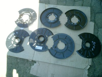

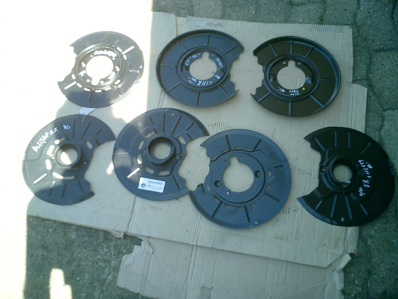

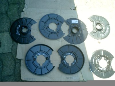

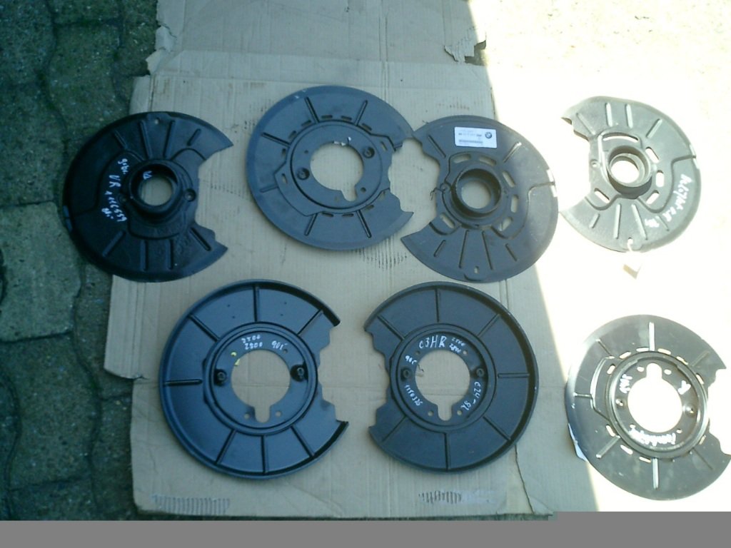

E3,E9,E10, NOS, refurbished,
Just ask
thanks Thomas, one day late ... i bought new fronts from Stefan and i bought rears in the USA from Maximillian (ouch) ...
