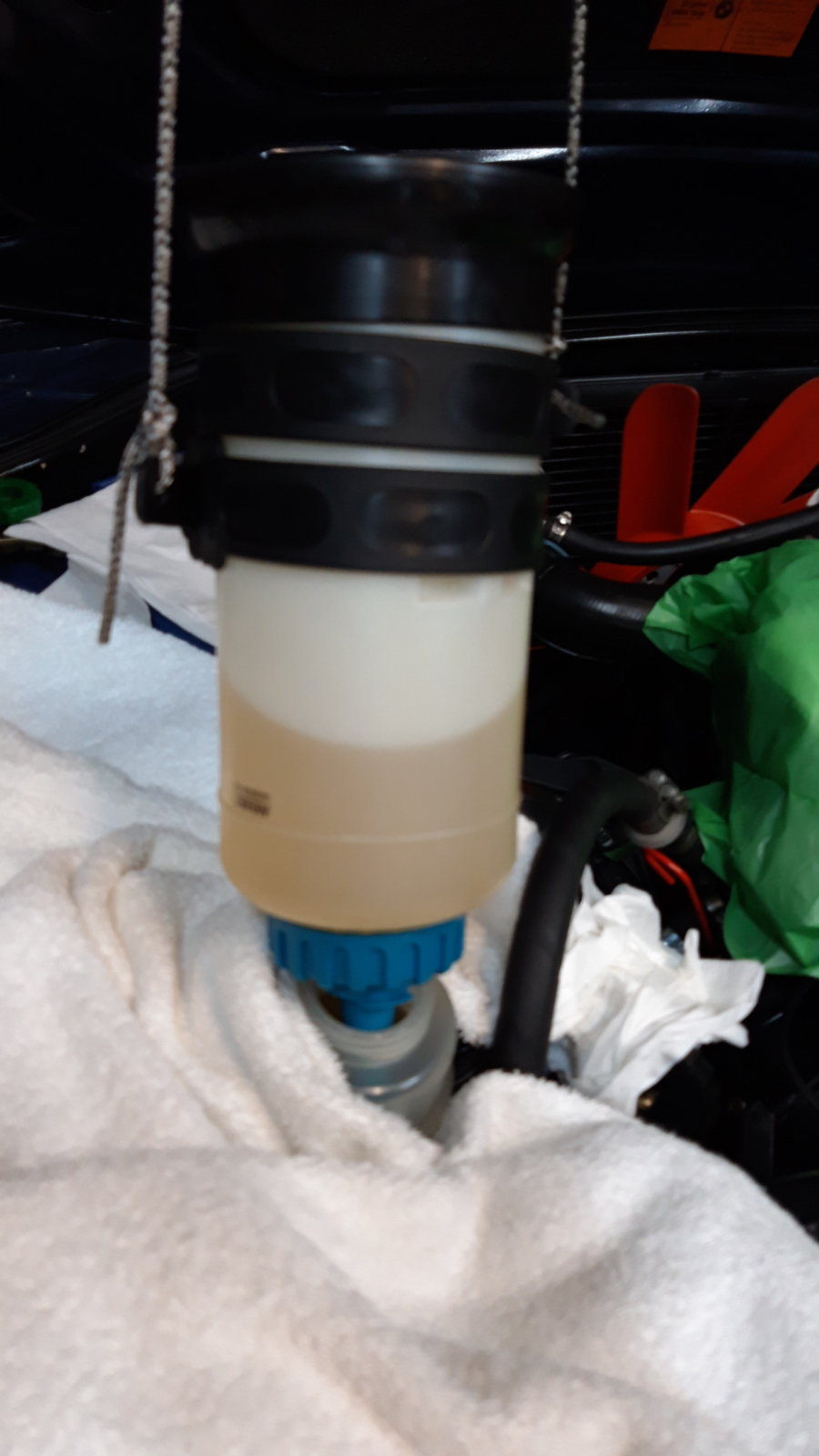

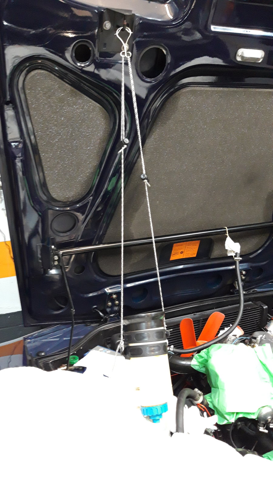

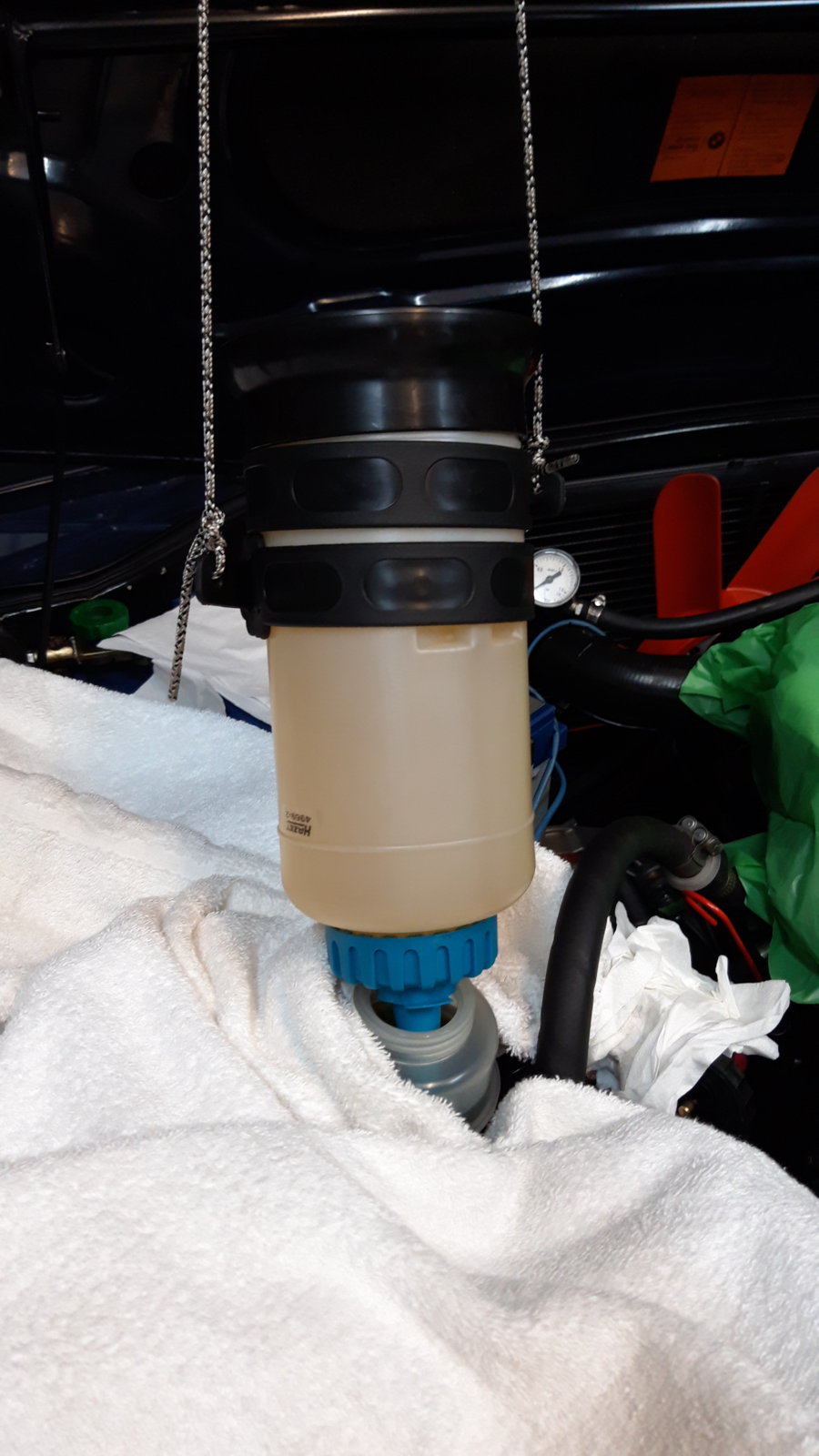

+add a compensation bottle to your bleeding equipment, essentially, a big bottle that can hold 1 liter of fresh fluid, with a narrow mouth, put it upside down into your reservoir and let the needed fluid fall as required, it is not magic it is physics

found that to do the complete 5 ends, 4 wheels + 1 clutch i need 1,5 liters

I have had a look at your suggestion above with the feed to the reservoir.
What stops the fluid in the 1 litre bottle all going into the reservoir until it overflows, whilst still enabling enough fluid to go into the reservoir to keep the reservoir full?
What is the device that goes from the 1 litre bottle up to the hood bracket, is that an air valve to allow air into the 1 litre bottle thereby letting the fluid out? If so, do you have to manually control it?

DeQ, thanks for the confirmation re volume to flush.
what stops the fluid to go and splash into the reservoir until overflows is the famous principle of the water drinking bottles for ducks, probably there is a tedious name of a scientist, but believe me it is the duck drinking bottle principle, aka, from now on the dQ principle.
so esentially, if you put an open bottle full of a fluid upside down inside an empty glas, or cup, the fluid will go out from the bottle and start filling the glass, but the fluid will stop falling in the very moment the rising fluid touches the mouth of the bottle
hence when you hang this brake fluid bottle upside down you have to touch the surface of the brake fluid in the reservoir, then when you start bleeding you will suction some fluid through the lines, and the level in the reservoir will decrease, this will force more fluid to come from the bottle to level the reservoir
tha "device" that goes from the bottle to the hood bracket is a rope with a hook to keep the bottle vertical
ducks are clever animals, they drink water in a very educated manner
hope it is now clear, no magic, simple physics

brake fluid circulates, not in a perfect rotational manner, but those pulses are not perfect, so sometimes more comes than goes, sometimes it is the opposite, proof, i have found dirty deposits in my reservoir, where do they come from ?
as to the 1 litre bottle, yes, it is advisable to use all to circulate and clean the lines, it makes no sense to keep it in the shelf, it will be degradated when you try to use it.
and i do not remove the old fluid, i simply let new fluid pass through the lines until i finish my compensation bottle, that is my trick, i fill the compensation bottle and i use it all
