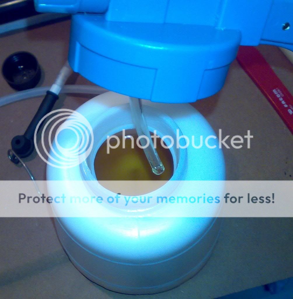

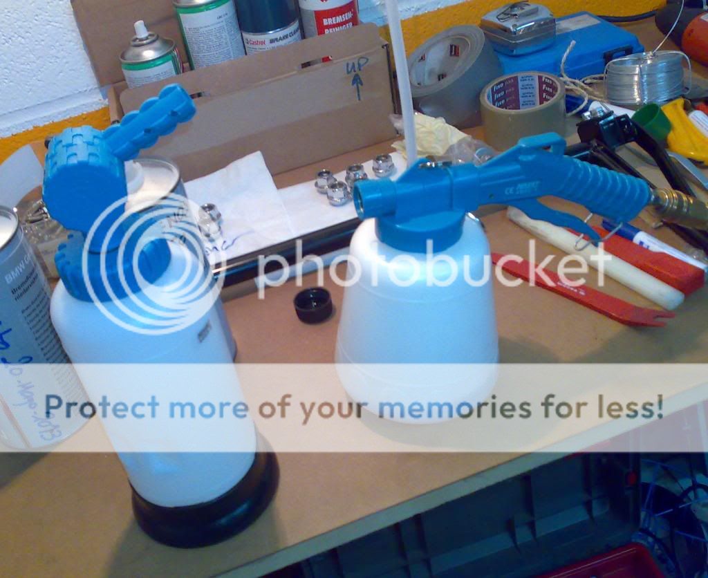

to do this little job and as a preparation for the brakes major overhauling to come, i bought a bleeding kit and make a trial, not bad:

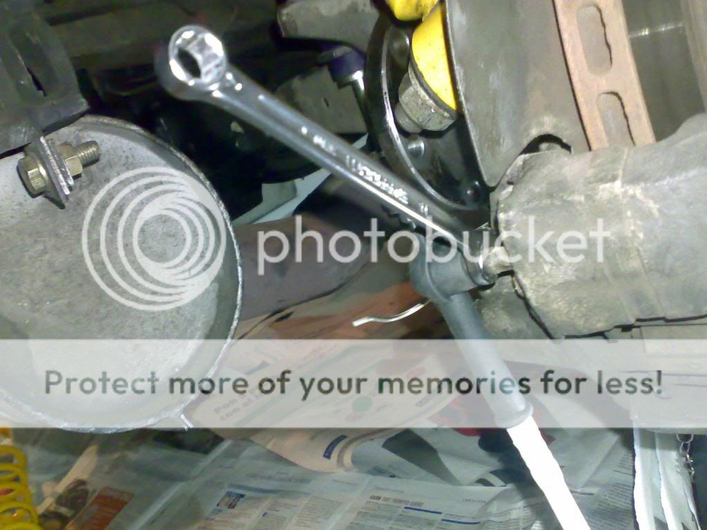

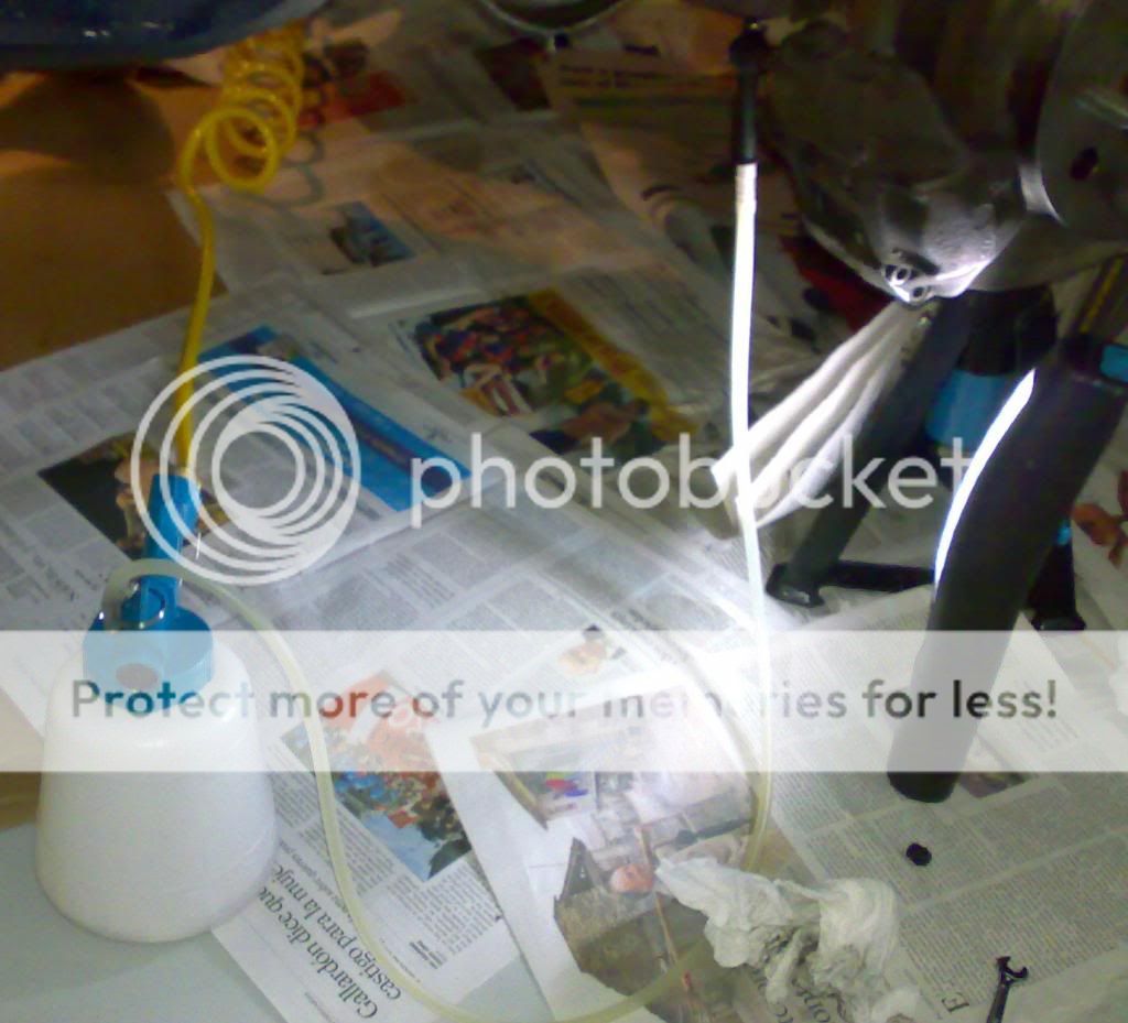

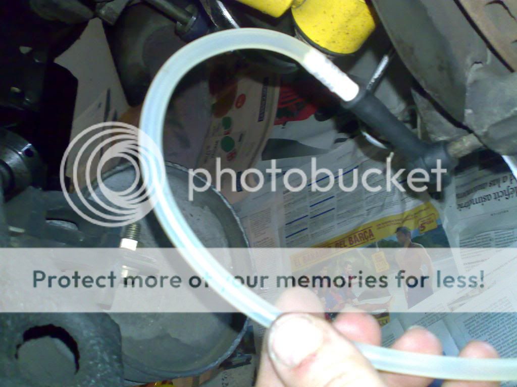

the system consists of a master bottle that is connected to the air compressor, but this makes vaccum (venturi effect), so you fix the tube to the bleeder, and open the bleeder while using the air compressor,

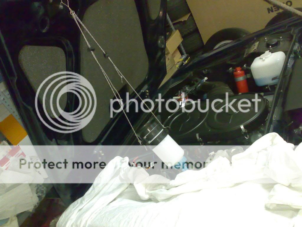

the systme includes a bottle that you fill up with fresh brake fluid and you place on the reservoir hanging from the hood
this provides you with unlimited ammount of fluid for the full car operation
old removed fluid
does anyone use a similar system ?
