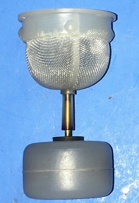

Does anyone know where to purchase the Brake Reservoir Strainer and Float Part #34321103065? I have noticed for a while now even after refreshing my entire braking system that the Brake Fluid Warning Light under the UPM Gauge goes on and off intermittently. I have learned after reading the forums that this occurs because of either the contact wires being dirty, or the float not working properly - I removed the strainer and saw the float bobbing up and down, the rubber grommet sunken at the bottom and not connected to the center pin, and the entire float filled with brake fluid once removing it from the reservoir. Is this really a no longer available part? Or where can I source one or repair this one? Thanks to all in forum by the way, as I have learned a great deal over the years about E9's and how to fix them!

This is the cap and float that triggers the warning light. No strainer on this part. I used it on an e3 a few years ago and it worked fine.

Yes my parking brake is and was fully retracted (down all the way) and still came on time to time. @sfdon I will do that to check to make sure it is not that issue. I can only assume it is the pin in the reservoir was bad after seeing that the float itself was dislodged from the strainer and full of brake fluid. Thank you!

Crazy timing! I also hit bumps and notice it go off and back on again...I just refreshed the entire braking system a couple of months ago with new fluid and it was still at the the Maximum mark with no apparent leaks. I can only assume it is the pin in the reservoir was bad after seeing that the float itself was dislodged from the strainer and full of brake fluid. The pin was also not pushed up all the way to trigger the sensor on the cap to turn off. I will also check my handbrake sensor as the others have noted. Thanks!
