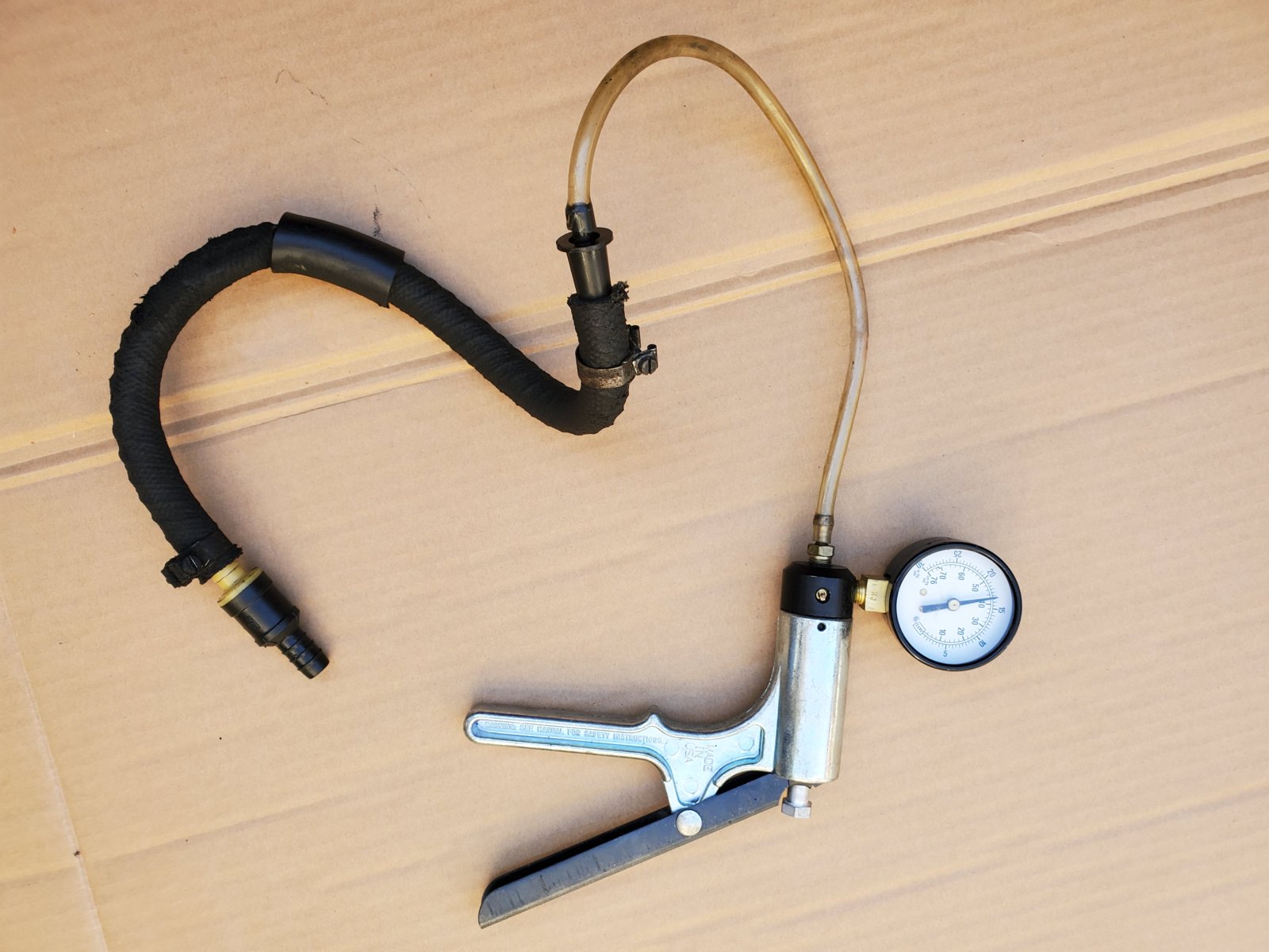

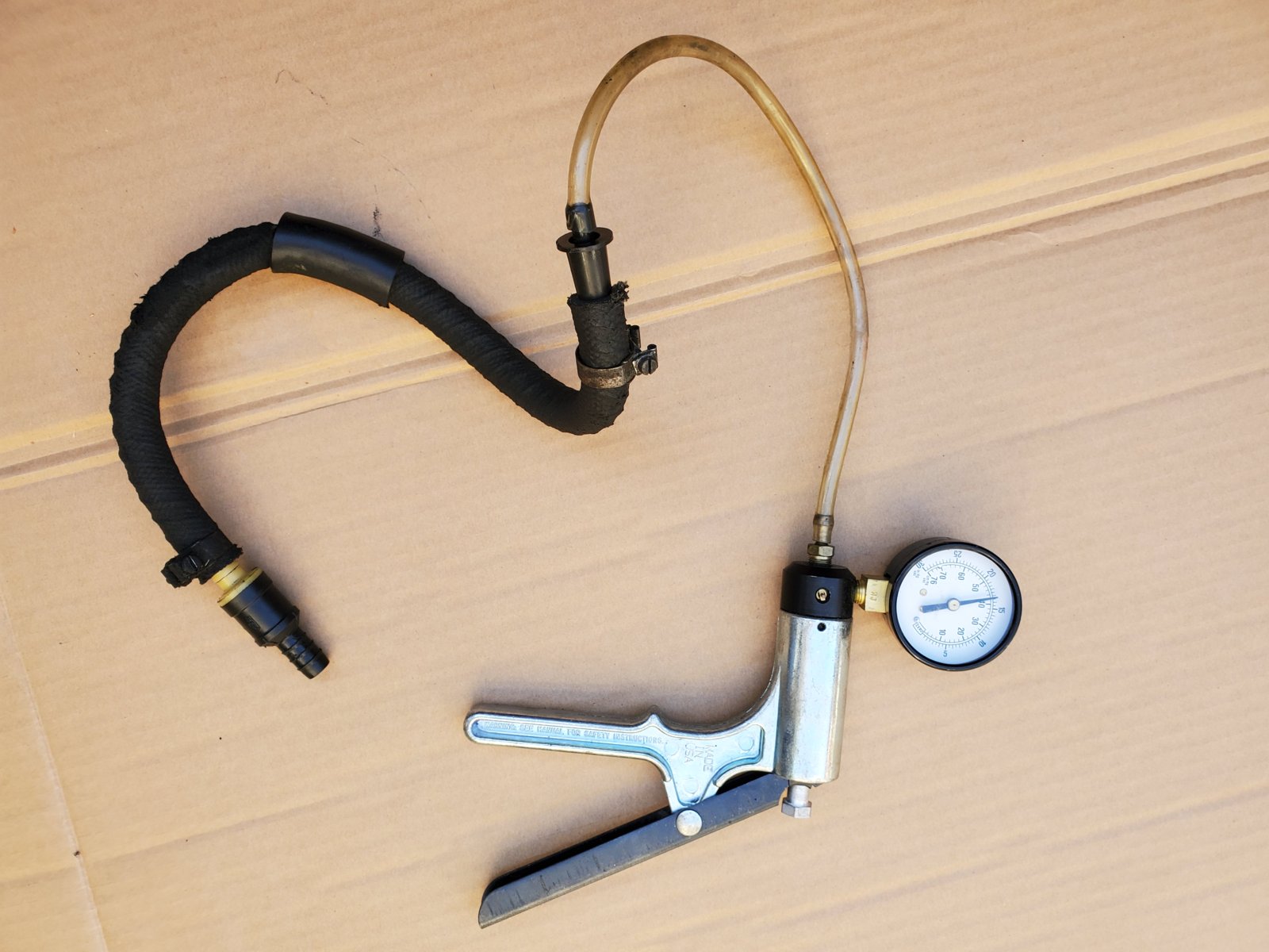

Simplest place to start is to evaluate check valve between the carbs/intake and the booster.
The check valve and his hold vacuum. I am thinking the booster has failed.
That looks good. Could be booster, of course, but before you seek another booster, look closely at the other hose that connects from the check valve to the booster. If you see cracks or missing clamps or whatever, investigate whether some hose work might fix your issue.

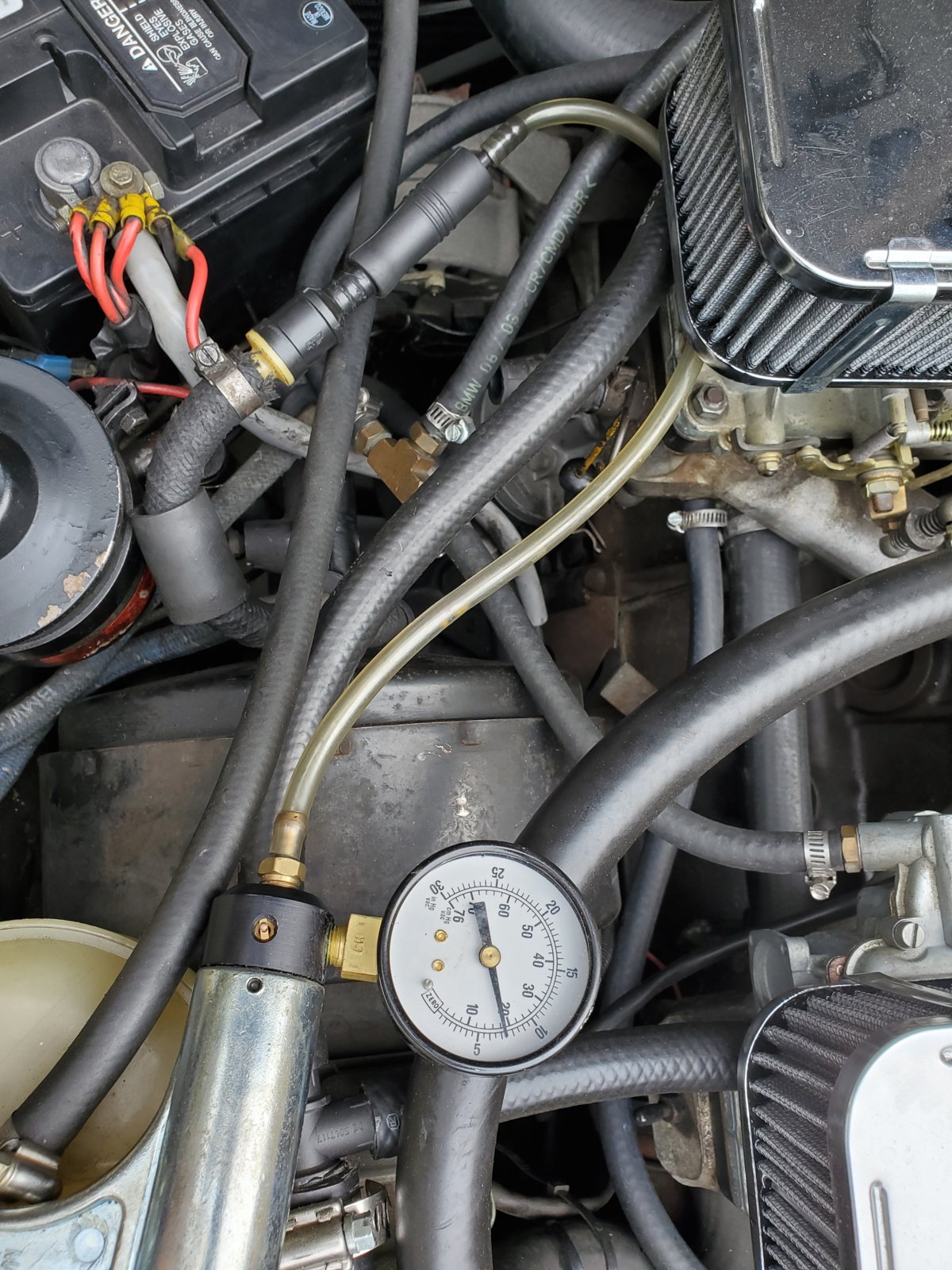

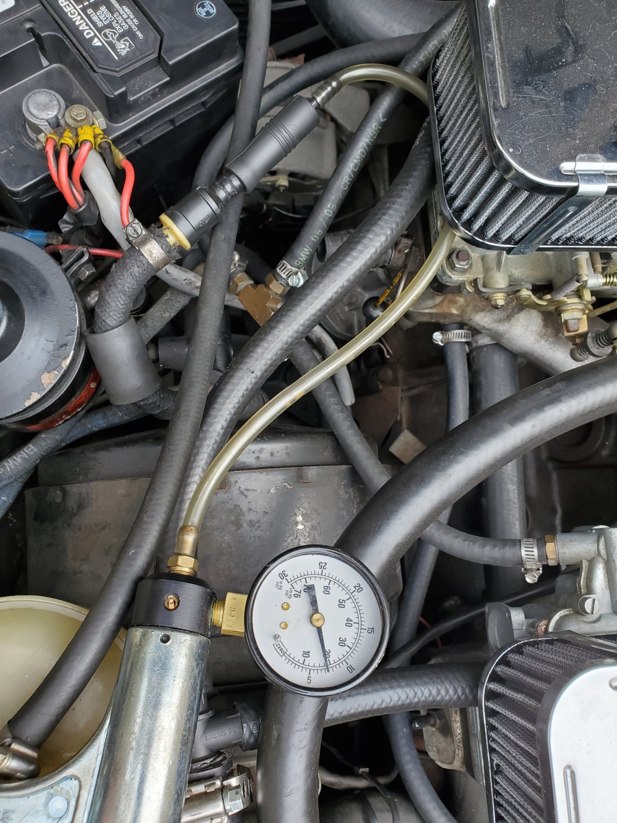

I hooked the pump to the booster and pumped it up some (5-7times) and though it did not read, it did hiss when I pulled the hose off. I will try again tomorrow and pump it up more and see if it holds and If I can get the vacuum gauge to read.
Booster holds vacuum. However, if I depress the bake pedal the smallest, smallest amount the pressure drops to 0 instantly.
My thoughts are that the booster is failing? I am not sure about this one. Thoughts?

Remove the hose and test a direct connection with the booster.
You appear to have a tear.
