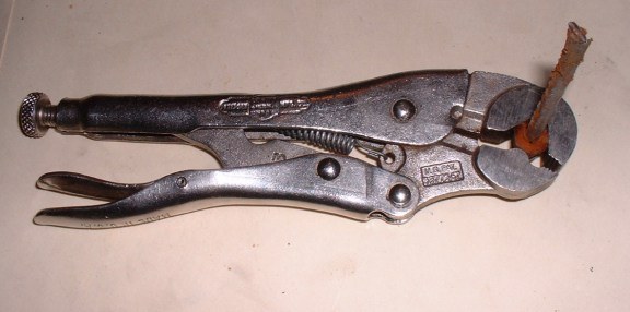

If you are unable to budge any of the connections, you may not be exerting enough force or you may need to try other tools. Flare nut wrenches and vice grips are the first things that come to mind. If you are unable to bring yourself to force things for fear of rounding off the fittings, sometimes this is unavoidable. That is where the vice grips come into play. FWIW, look here for a different style of vice grip. (Same principles, but article deals with different "2 piston calipers") http://www.firstfives.org/faq/brakes/in-progress/CaliperRebuild.html
