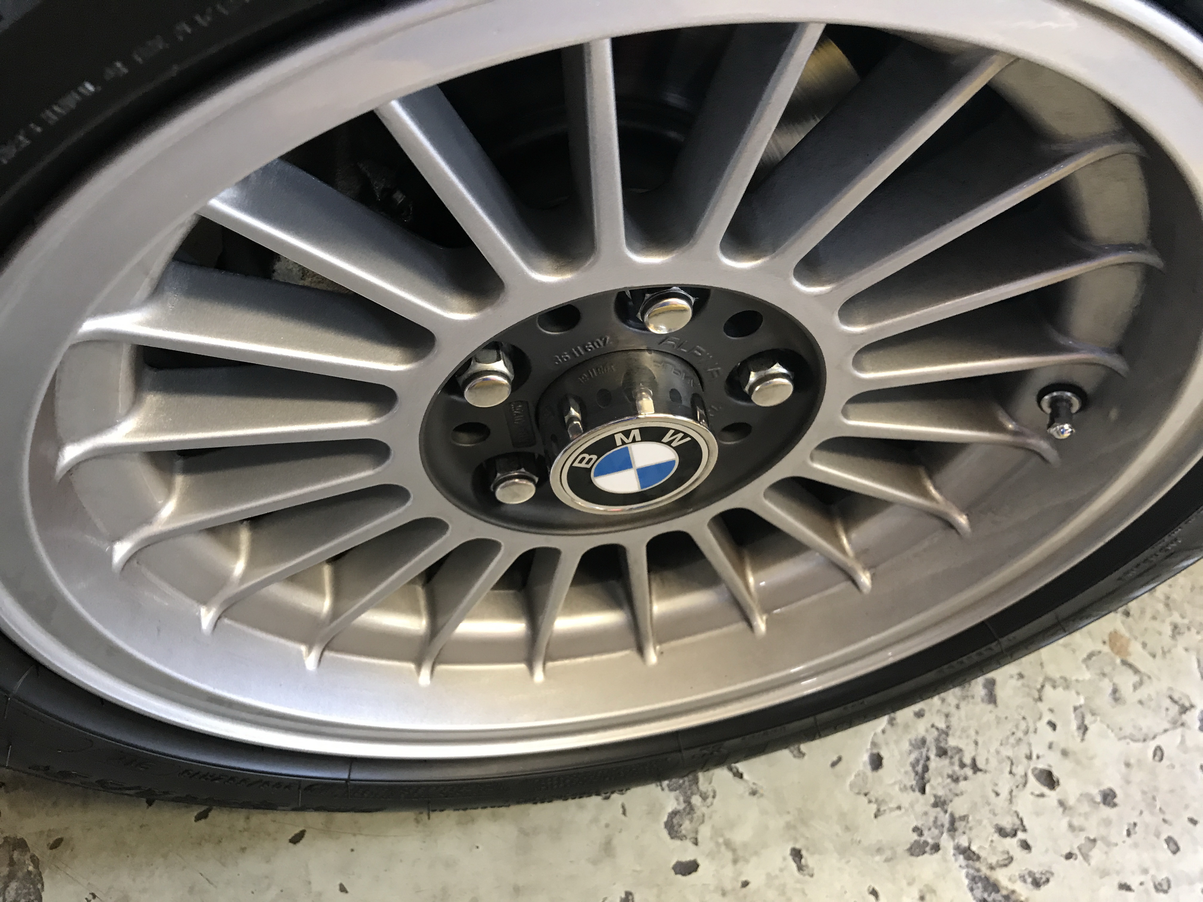

Folks,
Thought I'd just report back after 1,000 or so miles on the EBC Greenstuff pads. Install was perfect, no issues. Brakes are quiet and progressive, no squeaks whatsoever. Brake dust is a little better than stock, easy to clean off. All my driving has been around town or highway, so can't speak to fade resistance or other performance characteristics, though I did lock them up last weekend to avoid a shunt with another car.
Overall I would recommend.
