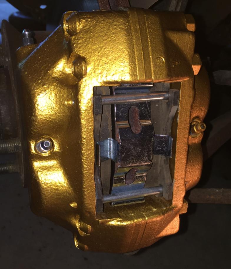

The painted calipers look very nice compared to the original rust.
