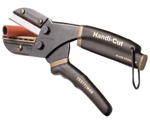

In regards to hose cutting. My favorite tool is the Sear/Craftsman Handi Cut. Scary sharp and strong blade:
