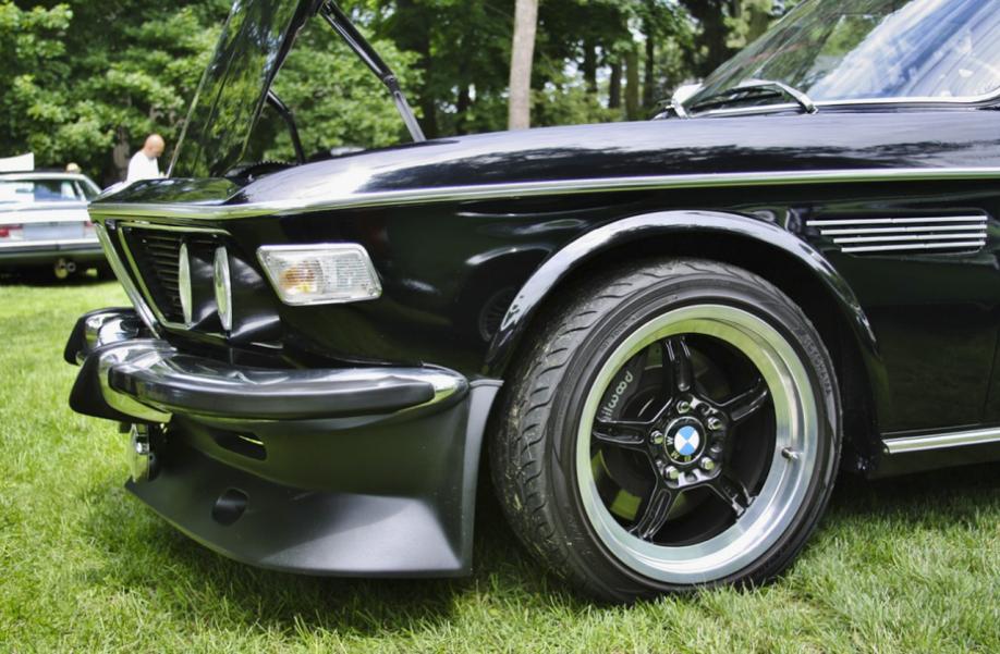

the reason is im using an s38 engine
and i might need some additional stopping power.
yes ill need to use the stock 14 wheels
option
the reason is im using an s38 motor and may need some
more stopping power and i need the 14" wheels
you aren't going to get a big brake kit under 14" wheels. i can appreciate the desire for more braking with an s38 under the hood. my advice is to talk to Mario at VSR for his direction.
The stock brakes (discs front and rear) are very good so do the full flush and replacement of brake fluid, inspect and refurbish as necessary everything (all calipers, pipes/fittings, MC and clutch cylinders, pads and rotors etc) and that is probably all you will need for street use.
Or go shopping here http://www.iemotorsport.com/bmw/E9-E3-brakes.html
Agreed... Especially with 14" wheels
